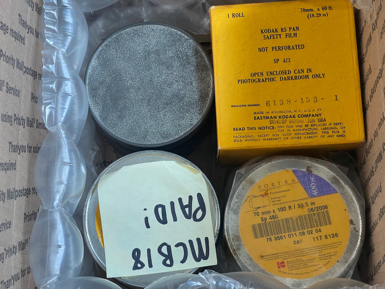

Recently got this, about 150’ of Portra 160, 100’ of Portra 400, and 60 ft of “RS-pan”. Depending on how stuff works out, I might be able to get more soon.

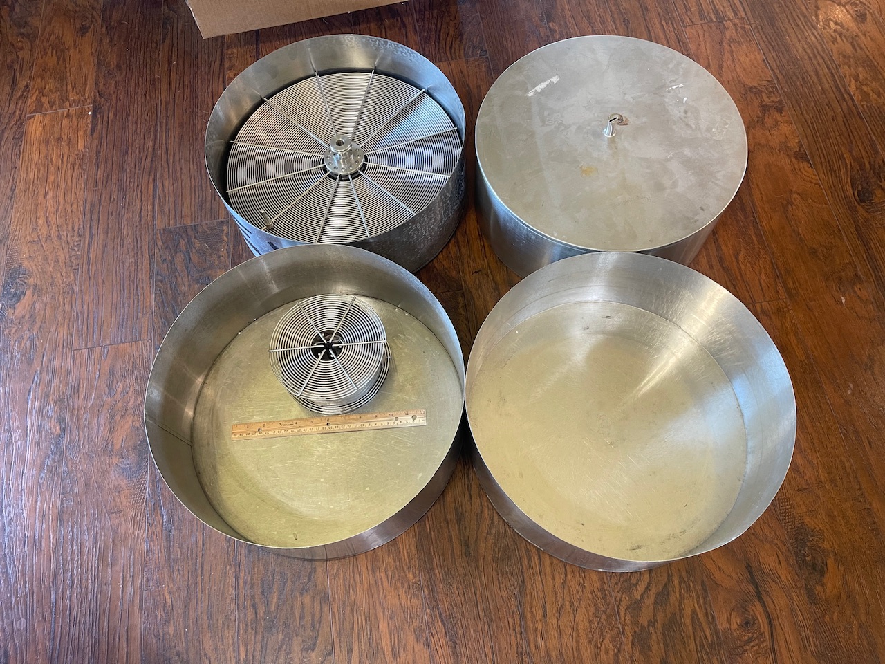

I see that @Nokton48 already posted his, but here’s mine! I put a 12 inch ruler and regular 15 ft reel in the picture as well for scale. They’re extremely large, according to the documents I have they take 15L of chemicals!
I do intend to use them at some point, but I do need to find a 100’ back for my camera. They aren’t expensive, just hard to get.
Also, I do have 15 ft 70mm and 65mm files if anyone wants them, but I’m having trouble attaching them to the post. They fit in a 5.75 inch diameter by 3.5 inch tall container and need 1.5L of chemistry to submerge. A 1 gallon paint can should work well. I haven’t designed a daylight tank for it, so you will have to use darkroom processing. But if I can figure out how to model more complex geometry I might give it a shot at some point.

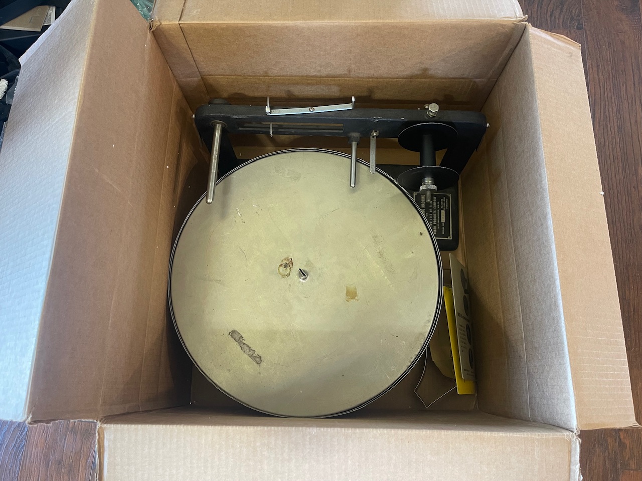

Well, now you and MCB18 can share notes. That's exactly what he got, but he also has the spooler. Those tanks should all nest inside each other.
Yes, they do nest together thankfully. I do have a more permanent space I can put them, but that involves a trek down the stairs to the basement, which I don’t feel like doing at the moment.

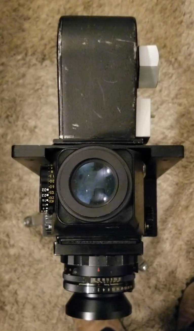

I bought this unit, had to return it. The frame counters did not work properly at all. I was lucky to get my money back, it was a big hassle!
