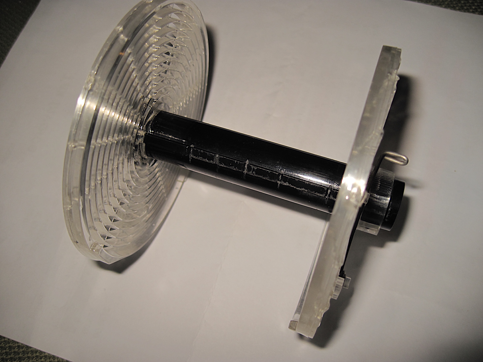

Very interesting! I haven't come across these before. Being able to cut notches for any format is a great feature! What length of film can these hold?
A normal 220 length. 116 and 616 lengths fit comfortably in the reel.
Notches must be accurate. I file a little at a time, checking with film as I go.
So far I've filed extra notches for APS and 70mm.

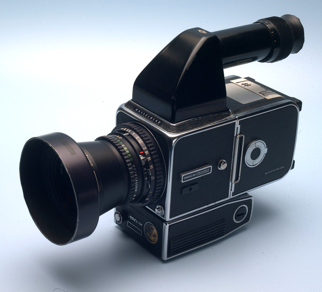

This is my current carrying around Hasselblad 500EL/M 10 Years On the Moon A70 70mm Film Back 70mm Straight Back Finder. 60mm F3.5 C T* Distagon with Custom Made Hood Cut Down Machine Shop. Film Back is load with Type II Kodak Plus-X 1982 Vintage works like new stock so far for me. 24 Exposures loaded in a Kodak 70mm Cassette ready to go. I have plenty of Olde Paterson Reels, didn't mind at all to dedicate a few to 70mm developing. When I'm loading something I view as important to me, I am glad I have my permanently modified reels.

This is my current carrying around Hasselblad 500EL/M 10 Years On the Moon A70 70mm Film Back 70mm Straight Back Finder. 60mm F3.5 C T* Distagon with Custom Made Hood Cut Down Machine Shop. Film Back is load with Type II Kodak Plus-X 1982 Vintage works like new stock so far for me. 24 Exposures loaded in a Kodak 70mm Cassette ready to go. FOBA Sweep Table DIMIL Broncolor Hazylight overhead Small Mirror camera right, adding reflections and nice fill. 500EL/M with Hasselblad CFV16 Digital Back, 80mm F2.8 Black T* Zeiss Planar with Hood.

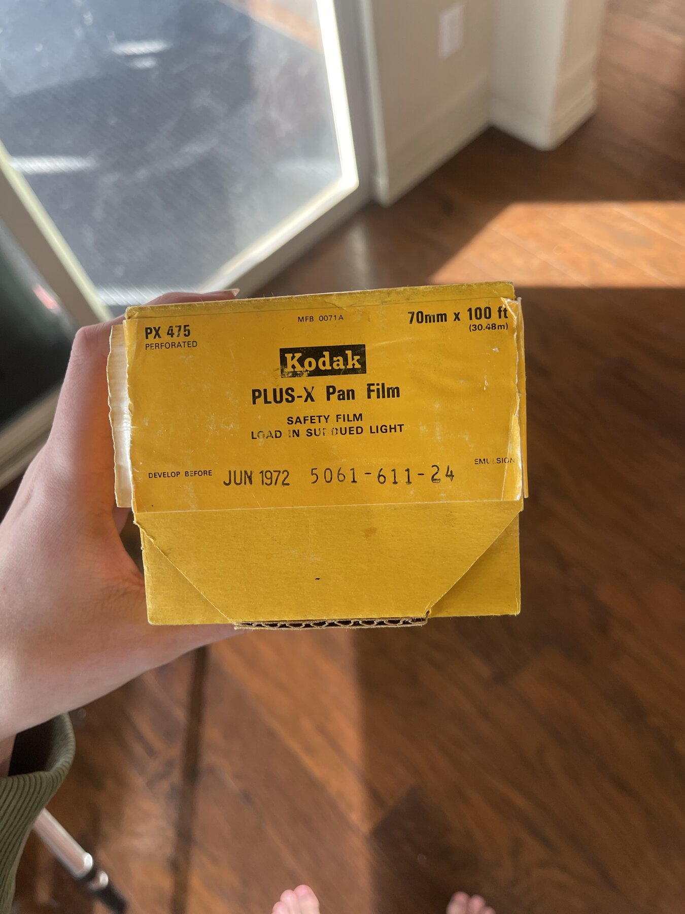

I bought a roll of 1972 Plus-x in 70mm for a good price a bit ago, I might sell some here if it’s not completely unusable. Supposedly it does alright, although you still loose speed.
I think you have a good chance of it being usable, unless it has been subjected to high heat over its lifetime. It seems insanely old for film, but I have shot Plus-X 70mm this old and it worked just fine. There are very few film emulsions that hold up like this. In my opinion, Plus-X, in 35mm or 70mm, holds up better than any other film I know over long periods of time. You definitely lose speed, but it's a very stable emulsion. Happy shooting!
I also had good experience with very expired Plus X film from 1985.
In addition, Panatomic X and Verichrome Pan are other two longevity champions. I regularly shoot rolls from 1970s.
This isn’t even the oldest film that I have, I have a 70mm roll of RS-Pan (ISO 500) film from 1964 that is still somehow usable at EI 50! Do not ask me how, I do not know. But yes, from what I’ve seen, plus-x tends to age pretty well. It will have some fog there’s no doubt about that, but it doesn’t seem to lose a whole lot of speed so you can just burn through it pretty easily.
