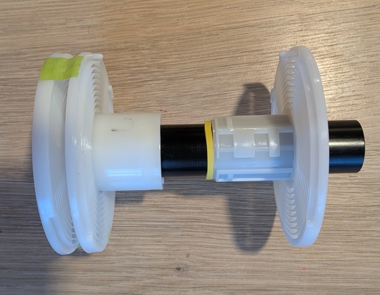

Also, you don't need to cut Paterson reels. Here is another method

This Paterson set up I used to process #116-70mm wide films. You should be able to load in the same length of the film, ~165cm, as for 36exp 35mm. Use very good elastic bend to hold the top part. For "real" 70mm films I have ss Nikkor reel with capacity of 100"and that is around 42 - 6x6 frames. I had also to leave blank frame or two around 20-24 shots to accommodate cut in the middle of roll to hang film to dry.

I have been using two Paterson reels and two small rubber bands (the other is blocked by the half reel on the right), to develop any film from 65mm, 70mm, to 122 size. I call it Flexi-Reel (TM): it is non-destructive, flexible in film width, and maintains the ratcheting action of Paterson reels.
My kind of solution over here.

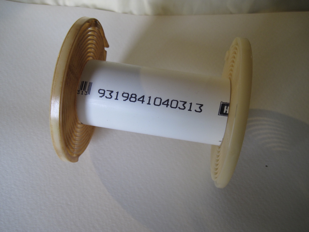

Great solutions in this thread for 70mm, but I was stuck for 122. My solution for that I found in a hardware store by way of a piece of PVC pipe which was a very neat push fit over the large end of one half of the Paterson reel. The other half with the smaller end needed building up to also be a neat push fit in the PVC pipe. I used one of the discolored reels that came with a tank from Ebay. I'd never let my original reels get into such a dirty state.
It's nice and solid and I made a cardboard guide about 3" long to slip into the reel first just shy of the steel balls. The cardboard thickness was such that the film still has room to move into the reel over the top of the guide. Once the film is started well past the "non-return" steel balls, the guide is pulled out.
View attachment 417186View attachment 417187

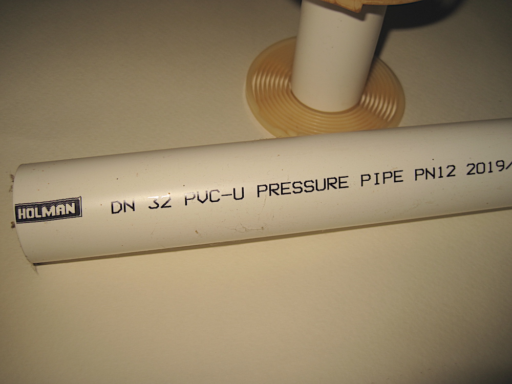

I considered it a pure fluke to discover PVC pipe with just the exact internal diameter to fit on the reel. I took the reel with me to the store (Bunnings) hoping that one of their pipes would be a close size and I could work on it at home to make it fit.
Much to my delight, one of the pipes fitted over the reel needing only my elderly bicep pressure to get it on. No gluing or anything was needed to hold it there, and it can be removed later if need be. The other half of the reel required packing around the reel to bring it to size. Anything at all can be used for the packing except tape. Also, it can't be a sloppy job because the reel halves must be concentric to one another, and without any wobbling, by the time the job is finished.
The pipe itself, it needs to be the exact length for the film size of the reel. I cut the pipe a little longer, about 10-20thou, and trimmed it with a file. This was done before packing the second half of the reel so that it could be slipped in and out of the pipe easily while taking measurements using a dummy piece of film to check how things are going.

This is an acquired skill I've developed for genuine Paterson plastic reels (aftermarket "Paterson" plastic reels are terrible, they have burrs and are somewhat sharp-edged, the quality is just not there)
