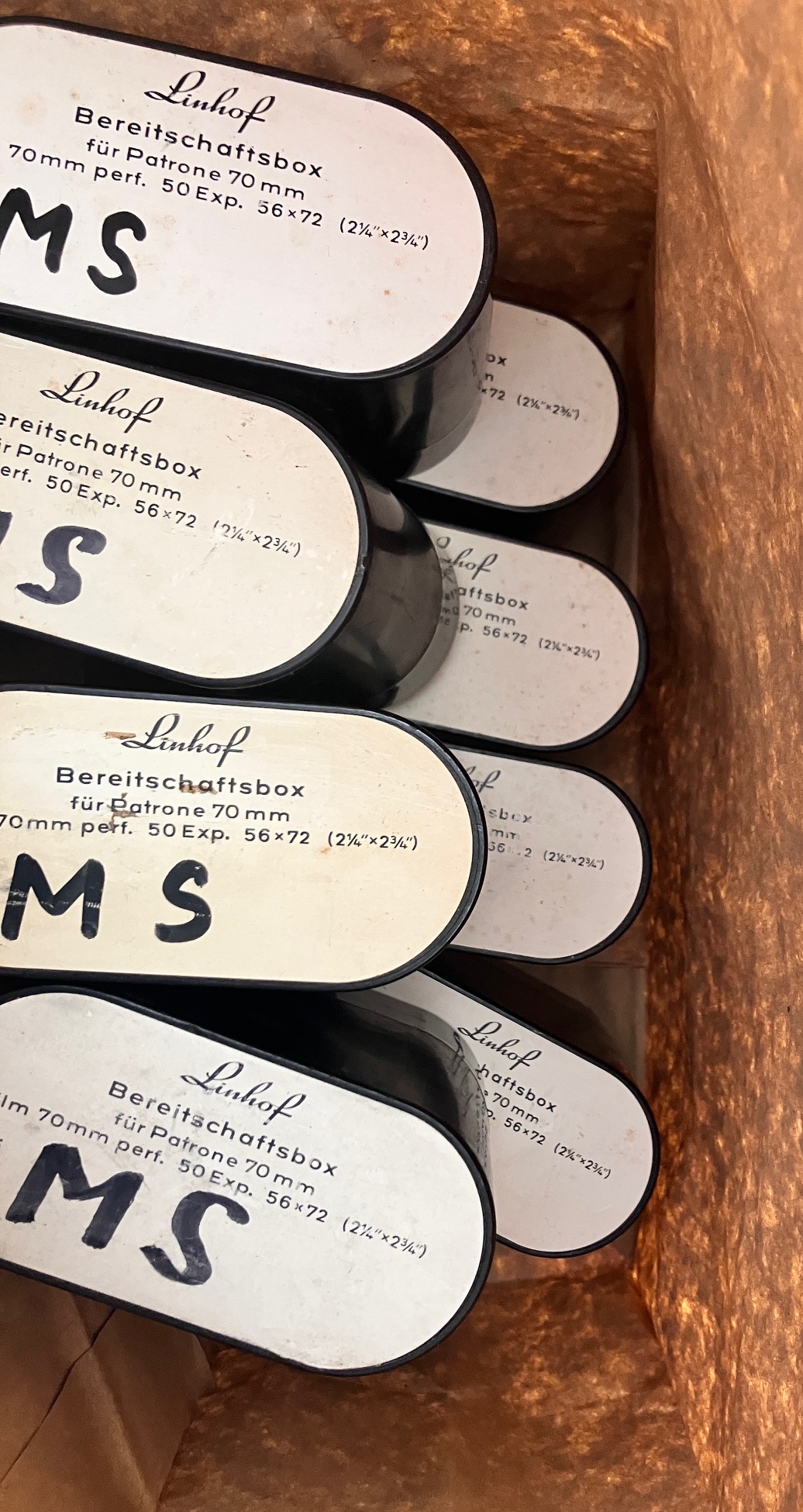

those spools are interesting. I like the design.
I do as well. I made sure that the ones I was keeping more of the newer design rather than the older one with metal clip.
My 70mm journey started when I accidentally bought a few Hasselblad 70mm cassettes with NASA labels on them. I thought I might discover lost photos of aliens, but unfortunately/fortunately no. The film inside were blanks.

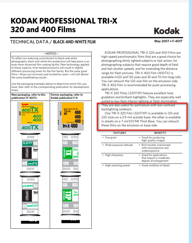

I believe that Tri-x 320 was and is only made as sheets. So it’s almost certainly 400TXP
Ok thanks. I will need to see how it performs with over exposure. Not knowing how it was store, nor its age, it's a little tough to gauge how to shoot it.
Nope - from the 2007 datasheet:
In case it makes any difference, the cassette here look like from the 80's maybe 90's. Also, those are different SKUs, the 15-ft preloaded cassette as 70mm long roll. The paragraphe above says in 2007 the 400TX existed in that format, so I understand the 320TX were not.

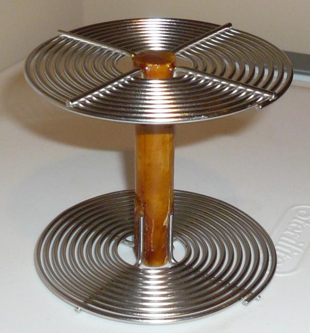

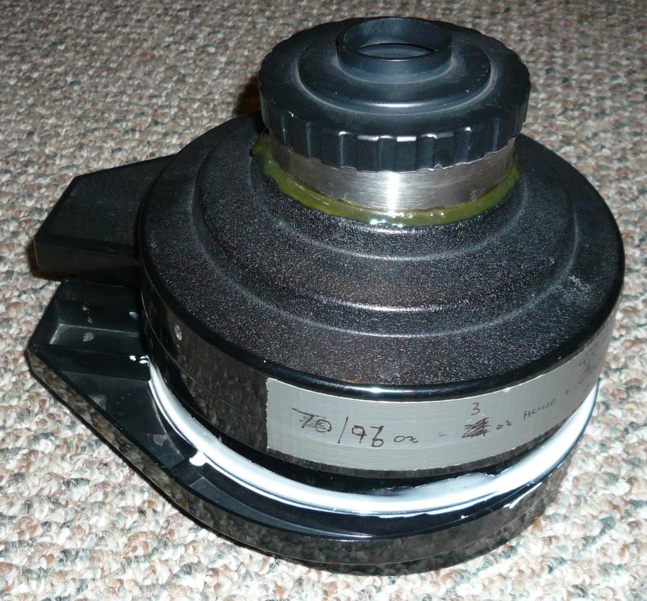

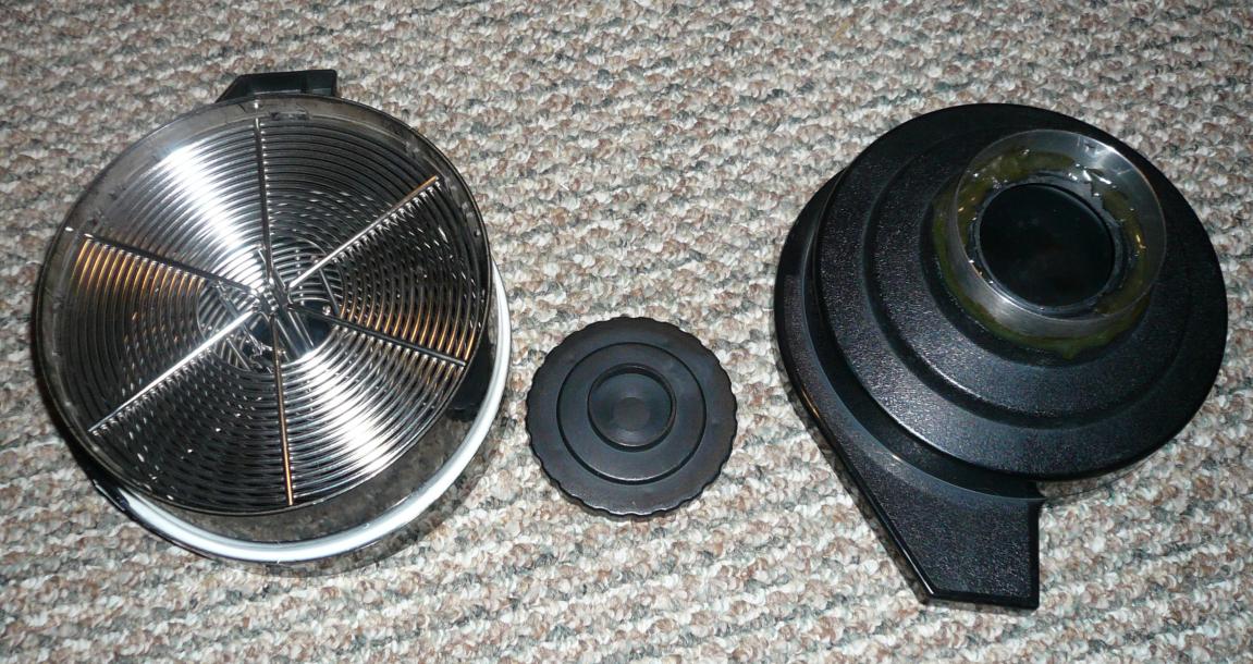

I've been away from my photography darkroom for a few years and am just now getting back to it. In the 80's I started using 70mm film in my Hasselblad. I was able to get a couple of 15' SS reels but could not find a daylight tank. I made my own by cutting down an Omega print tank:
I had also cut down a regular Kinderman type SS tank and epoxied the cut off piece to the top of the print drum so I could use a Kinderman top & agitate by inversion. Ugly but the tank works well.
To process 5' of 70mm film I made a SS reel by cutting a 35mm 36 exp reel in half and epoxied a dowel in the middle spacing it to hold 70mm film:
Makes developing short rolls of 70mm or 116/616 film quire easy.

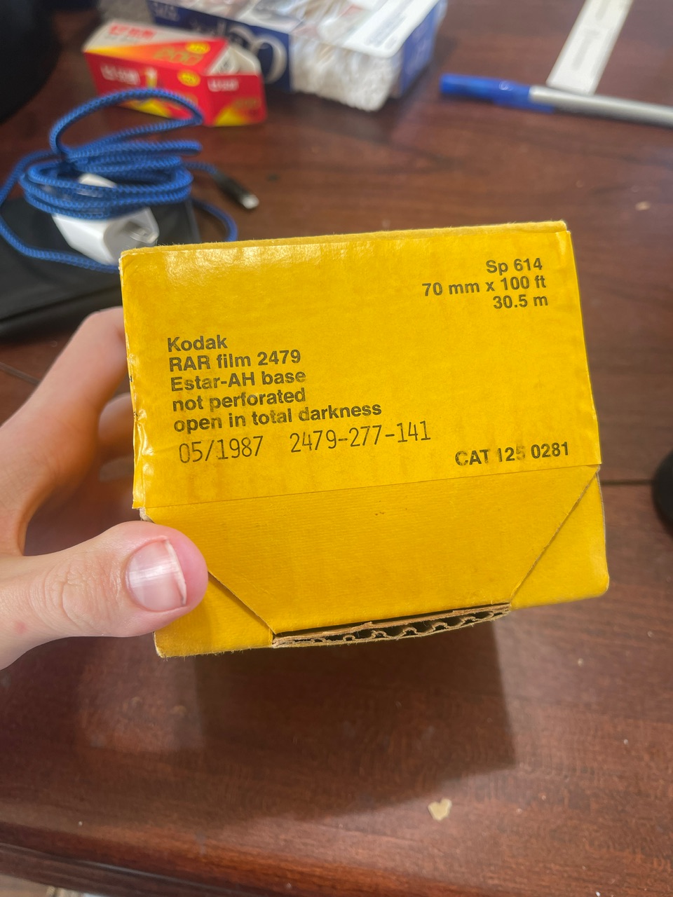

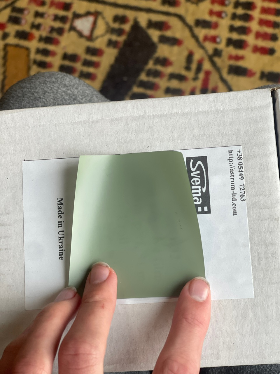

Mail day!
Honestly I am not expecting much, but it was pretty cheap. Also not a film I have ever seen in 120 before which is interesting. Almost no information on the internet about it.
Where do you find thing stuff?
Funny story, I didn’t actually find this. Friend in Germany found it and shared it. $75 later, most of that from shipping, it is now mine.
2479 is quite grainy. Some people find it pleasing, some not.
Closest thing I’ve been able to find is 2475, which I believe it is related to, although I can’t be sure as there is currently very little information online about it. I attached the front side of the data sheet, this is the most information I’ve ever seen about this film.

It's in the same line of films as 2475, somewhat slower than 2475 and with somewhat different sensitivity. It'll likely have lost speed and have baseball-sized grain. Again, they can be nice baseballs, but that's the look to expect.

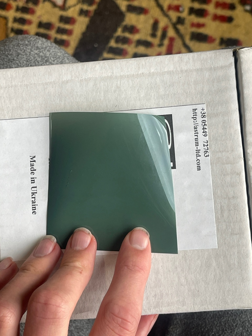

I was joking around with some friends that maybe this would finally be the time that I found a green film, I was not expecting it to actually be (olive) green film. Very interesting color, I’ll see if I have time to roll up a little bit of 120 today for testing.

Very interesting information, unfortunately that is not the same film that I have. From the bit of research that I have done, this film seems more similar to something like 2475 than 2490. Although even still I’m not super sure what to expect.
Feeling green with envy 😂
Wow. interesting color. If you roll some 220 I would be be interested in getting some from you and "test" them on my Hasselblad. For science of course!

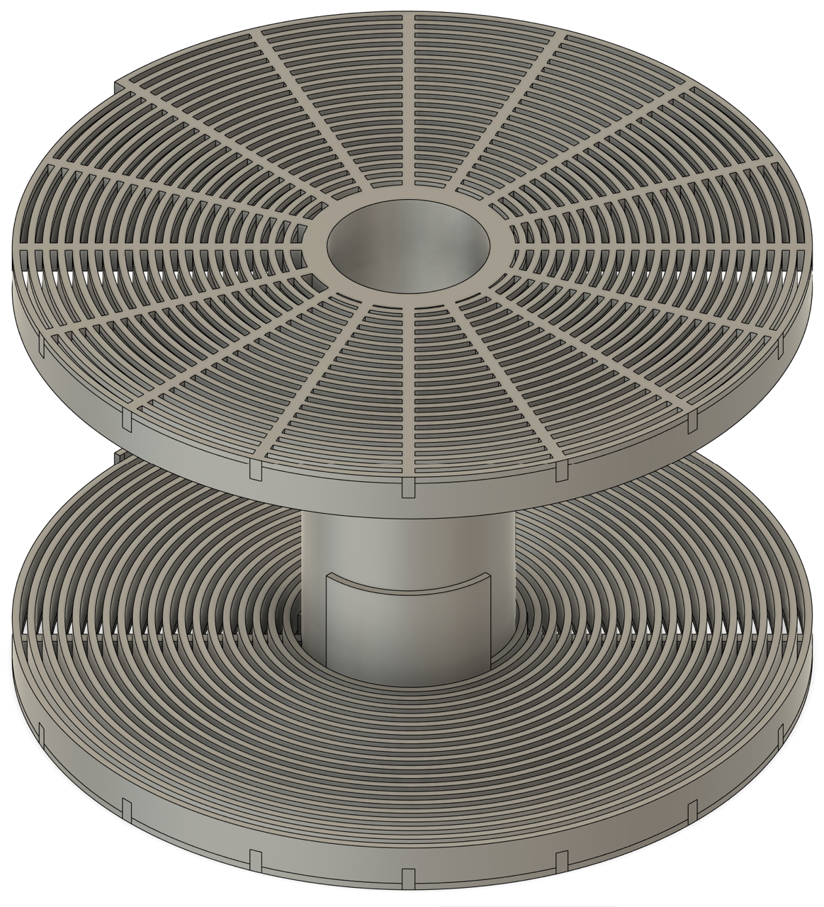

For anyone here with a 2500 tank and access to a 3D printer, I made a 15 ft development spool for 65mm film and 70mm film! It fits the entire 15 ft roll, no cuts required!
I did have to make some compromises, it is a fixed size, and does not have any sort of ratchet load mechanism (so loading is done from the center out), and as of now I still haven’t found a good way to attach the film to the center column, so you will need to tape the film to the center. But, it will let you develop a full roll of 65/70mm film in a reasonably accessible fashion, so I think that’s a pretty big win.
I’m not sure how to send the STL files here, I’ll see if I can figure out a way to upload them somwhere public, but in the meantime, I can probably send a dropbox link or something. If you want the files just PM me.
There are 4 files, top and bottom for both 65mm and 70mm reels.
Thanks to @koraks for giving me the dimensions of the Jobo 2500 reels!
Theres a site call thingiverse.com where you can upload the stl's to, then just link it here to make it easy for people to find/download them.
