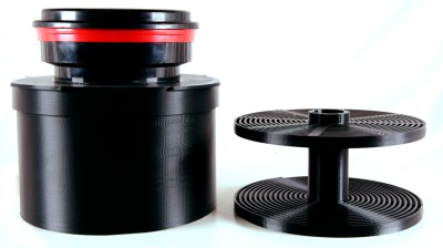

Thanks @MattKing, your comment is appreciated. Since you suggested it, here are a pic of the Patterson compatible (I've named the "Pa-70") reel I designed

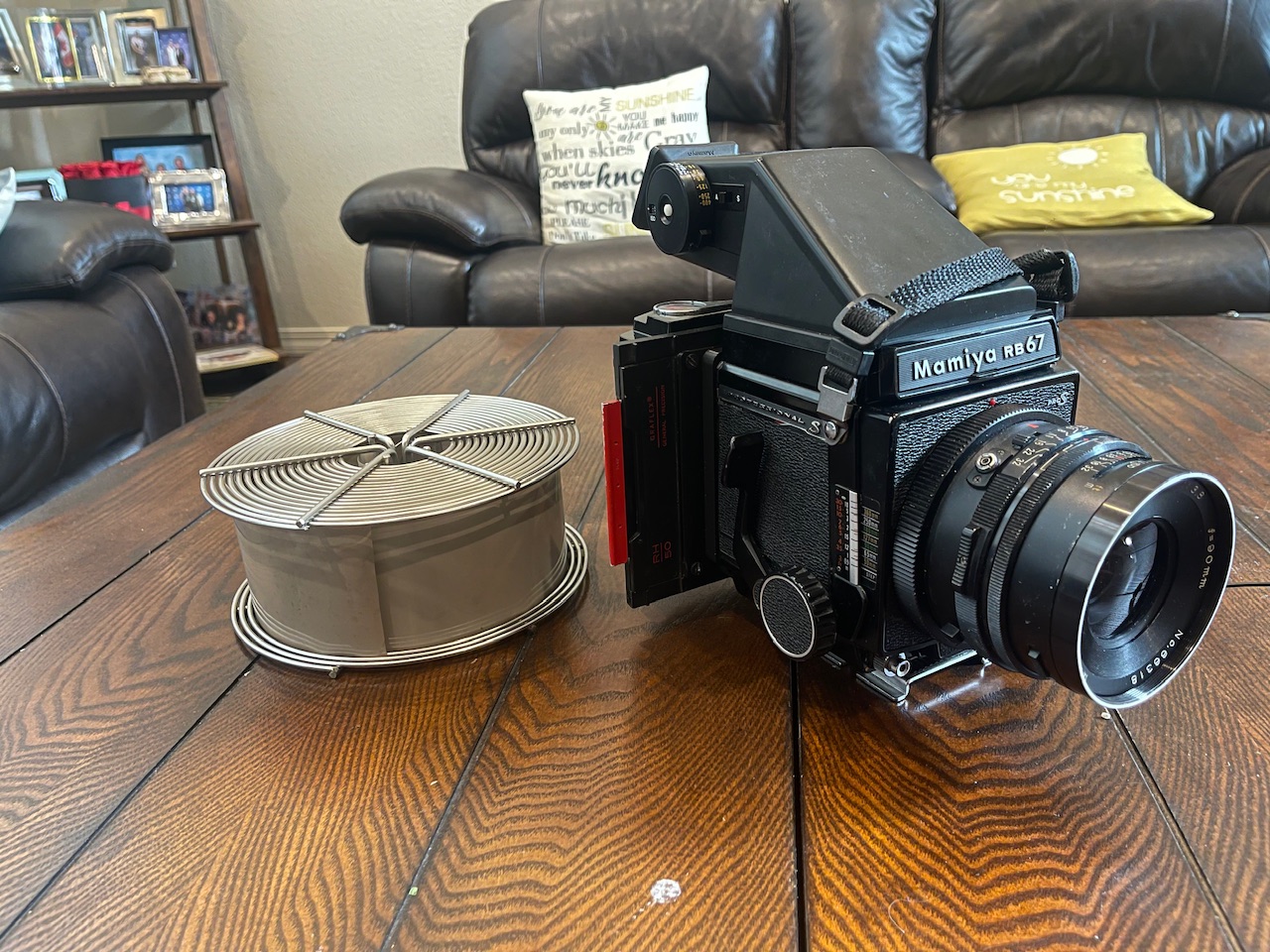

Two goodies arrived today, a 15’ 70mm spool, and the RH-50 -> RB67 adapter!
Spool needed some “gentle persuasion” to get back in true, but now that’s done, it loads film great!
The adapter seems light tight, but I haven’t fully tested that yet. There is a place To put a strip of light seal foam on the adapter where it attaches to the camera, but idk if that is actually needed. i’ll run a roll of 120 through it just to test. Film plane is bang on the money though, which makes me very happy! Was a bit worried about that.
All I need is a suitable bucket and I’m good to go for shooting 70mm!

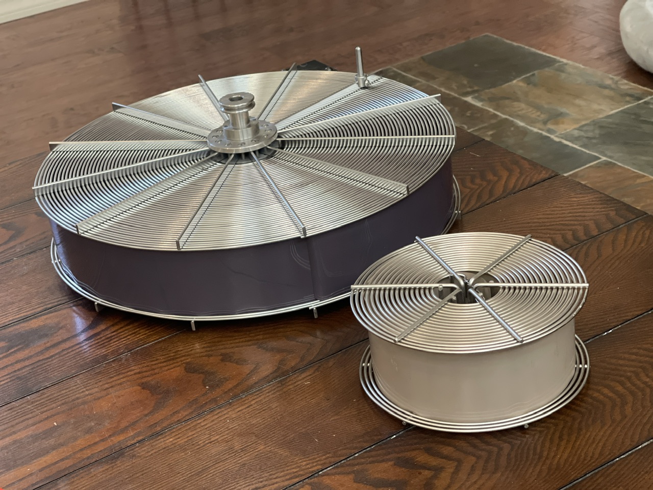

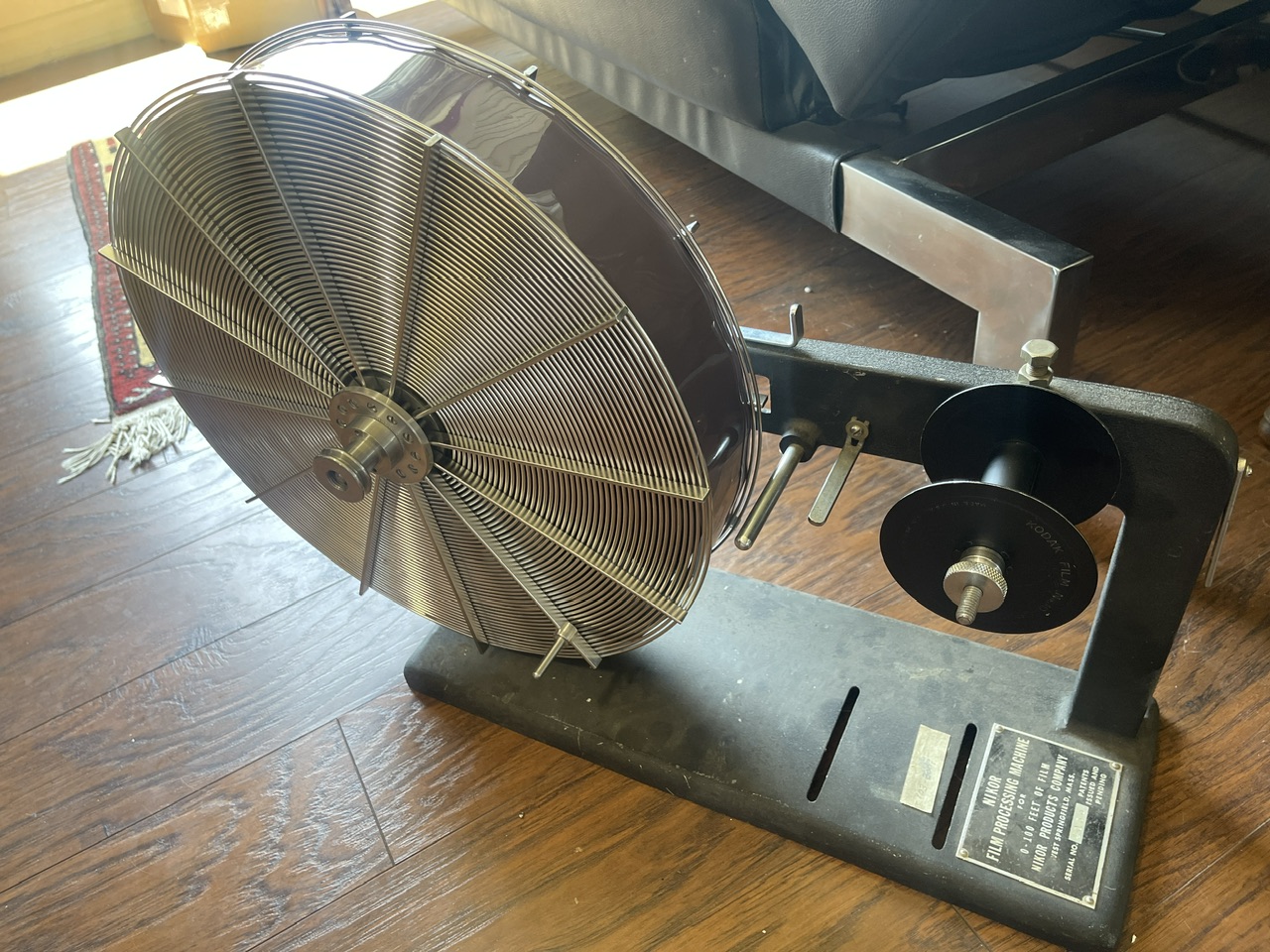

The giant developing spirals and tanks are here! Very interesting and unique bit of kit!
They're huge.
Very big.
They tell me they are very large ... the heaviest reels.
Good to see UPS didn't run over them with a forklift.
Those had to be big money in the day, and I'm sure they're hard to find anymore.
Have fun with them...
I shoot 70mm & 65mm, but I don't think I want to shoot THAT much film.

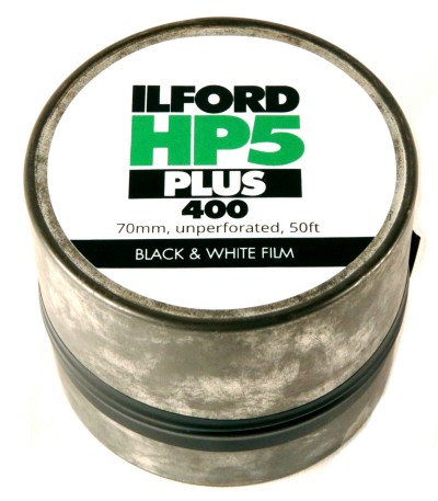

ULF last call for 70mm HP5+! Just a few more days remain of the annual ULF window. You can get your 70mm HP5+, perforated or unperforated, from us here. As in the past, we can get it to you in Ilford's inadequate cardboard packaging, or in a professional metal tin, in our bulk roll, which is directly compatible with all 70mm bulk loaders, including the Mercury Works Bulk Loader. The metal can is really important for shipping purposes, as it is X-Ray proof.

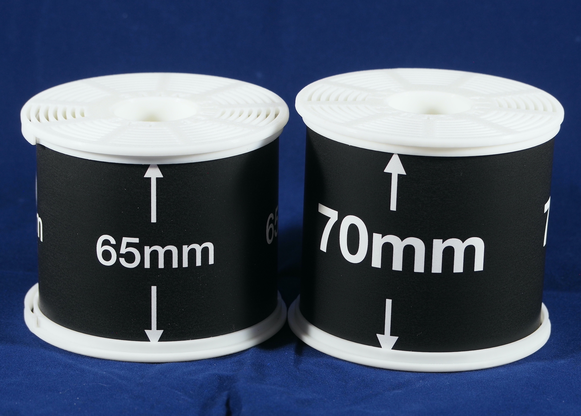

I love the various ideas for developing here! For anyone new to this thread or the world of 65/70mm, Mercury Works has complete 65/70mm developing solutions for Patterson tanks, Jobo tanks (our most popular, and my recommended choice for anyone developing 65/70mm), and our long roll system, which is a daylight tank for NPT 70mm reels. Those hold 13' of film. Yes, it's a tiny bit short of 15', but processing is 10X better than trying to use metal reels in a pot or bucket. Everything can be done in the light, with far less chemistry, and your processing will be much more even as a result of being able to do the pours and empties quickly. This has been a popular system for folks who want to develop long rolls. And our Bulk Loader can be used to load exactly 13' of film in each cassette. We have reels available for both 70mm and 65mm film.
(Note that our Paterson reel is for 65mm. You don't need a special reel for 70mm; you just need two standard Paterson reels. Our Jobo reel has settings for 65mm and 70mm on the same reel. Our long roll system has two different reels for the same tank.)

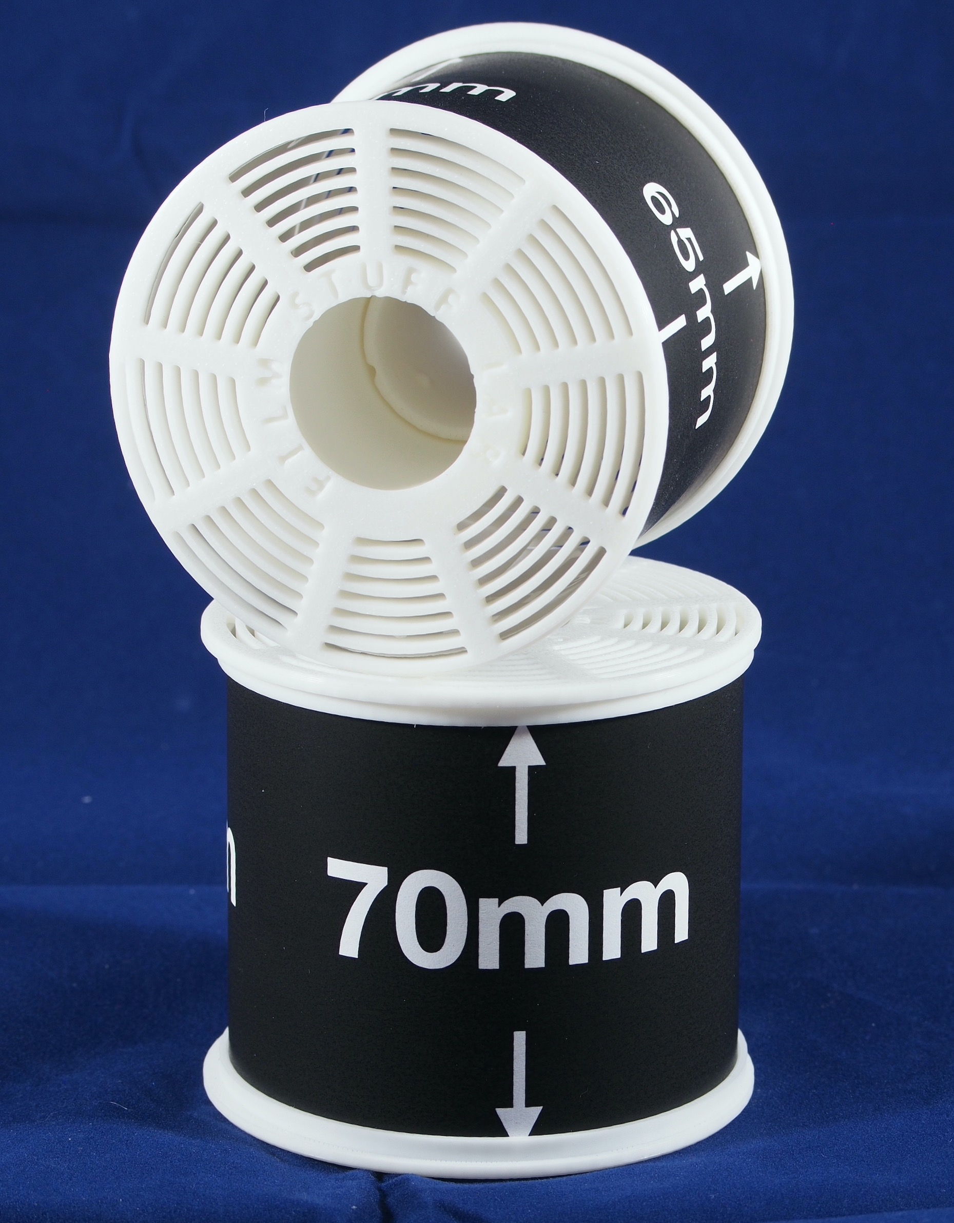

As an update to my posts earlier about my 70mm reel, I thought I'd share that I've made a new reel that now supports both 65mm and 70mm in a single reel. A multi-format reel for Paterson System 4 tanks! Can't get into the 65mm and/or 70mm development realm any more conveniently! All you need is a Paterson tank and my one reel for both formats and you are good to go! (Yeah, I'm pretty excited!) Here's a pic...

I wonder what the original/intended method was... Maybe a conveyor system over dip-and-dunk vats? Or did this have an associated tank?
Oh I have the tanks too, they’re just massive metal tubs you put the reel in. My small dog could comfortably sleep in them. Basically it’s like a manual dip and dunk. You agitate by lifting the reel up and dow .
Technically you can develop it in daylight, as there is a lid, but unfortunately I can’t use that yet. The bolt you use to lift and lower the reel is missing, and someone seems to have tried to crimp the pipe that forms part of the light trap with that bolt in the top closed. I would need to get an angle grinder and cut off the deformed part and find a suitable bolt to use it in daylight.

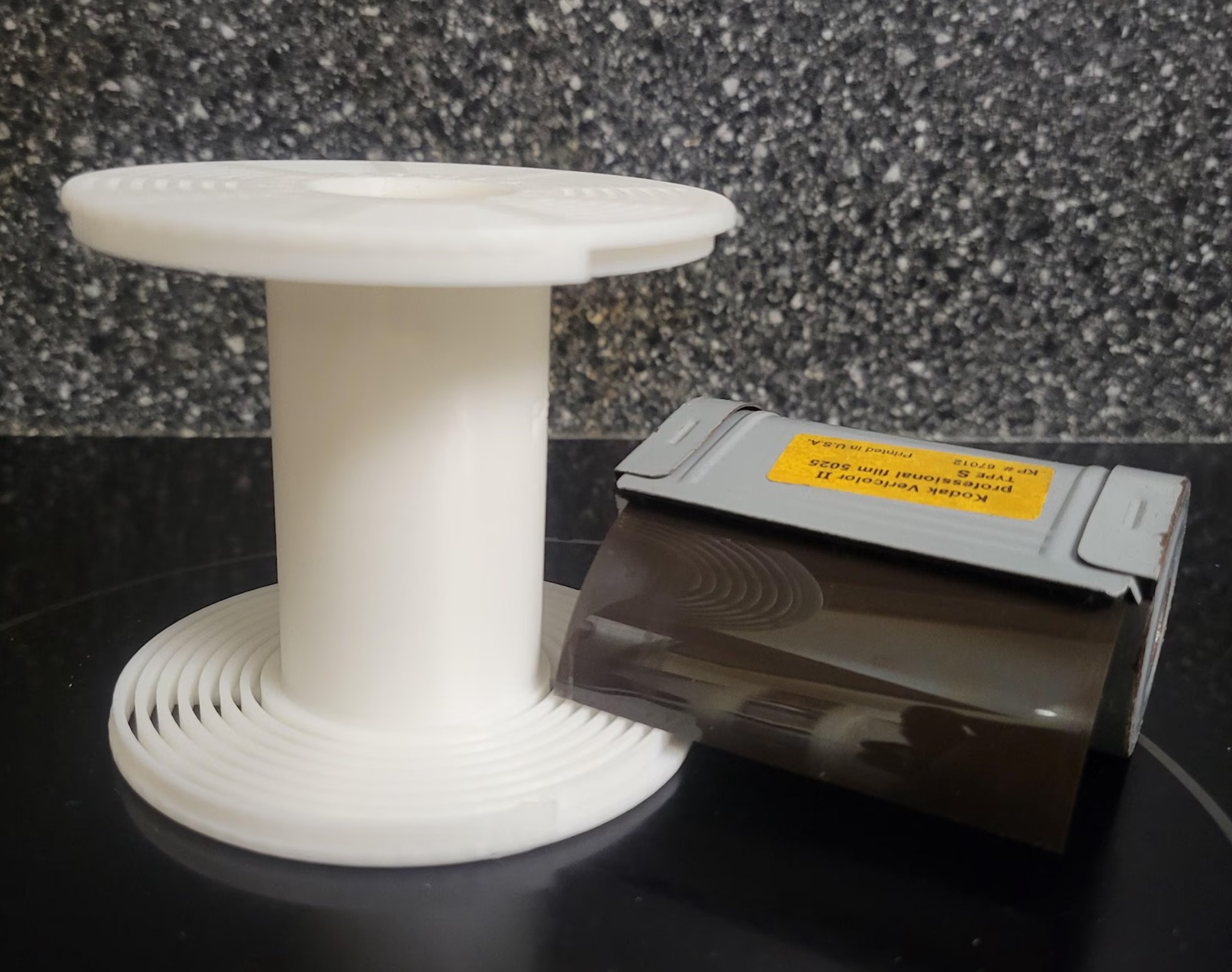

Well, I finally tried my Pentax 645 with the 70mm back modified for 65mm according to the instructions on @rhizomeblur Zach's excellent site. I did something wrong a number of times, and decided to cut my losses on the 50-ish inches of 65mm 250D. I think the cartridges I'm using may be a bit off, as it was really hard to pull the film out of the source cartridge, and it tore the perfs out. I eventually got it to work enough to get one shot before it ran empty. I reversed the film and ran it back the other way with the same result.
Anyway, today I used the new 65/70mm reel from thinbegin. It worked real well, and I was easily able to get the one picture (well, two, overlapped, due to the transport issues I faced).
I need to troubleshoot the transport thing, but I have a good handle on developing a length of film, at least.
