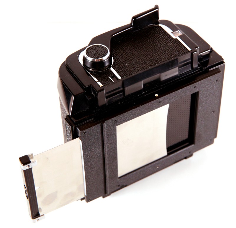

As always, info on this and all other 70mm backs can be found at www.shoot70mm.com
My eyes are bulging imagining the size and weight of this combo!
Surprisingly, it’s about the same weight as my motorized back (actually lighter without film). it is slightly larger in width, but hight and depth are about the same. Though, I personally don’t mind the slight size increase. I have an RB67, size isn’t exactly a big concern lol. Plus, I got it for $10 with a set of cassettes, well worth the 98% discount compared to the actual backs you can buy on eBay I think.
