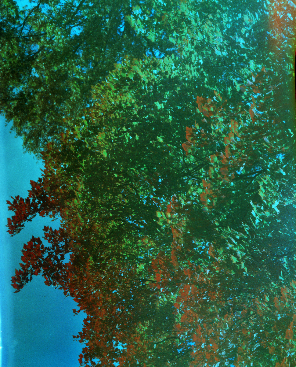

Okay, I'm catching up here and realized that I never replied to this question about Aviphot 400. I've had some of this film for quite some time, and decided to finally test it, based on your questions in this thread. Here was the result:
This expired in 2003, around the time when Agfa stopped making this film. I'm not very impressed with it. Yes, it's professional color film, but I wouldn't say there's anything special about it. Colors have shifted a bit, and it's pretty grainy. It would be best shot at 200 or 160, which negates its original speed advantage. My conclusion: at lower speeds it should be a perfectly acceptable film, but wasn't made in large enough quantities to be available today, long expired, and not as good as slower speed films like Portra 160. Of course, for color film we have 65mm today, which produces spectacular results!
