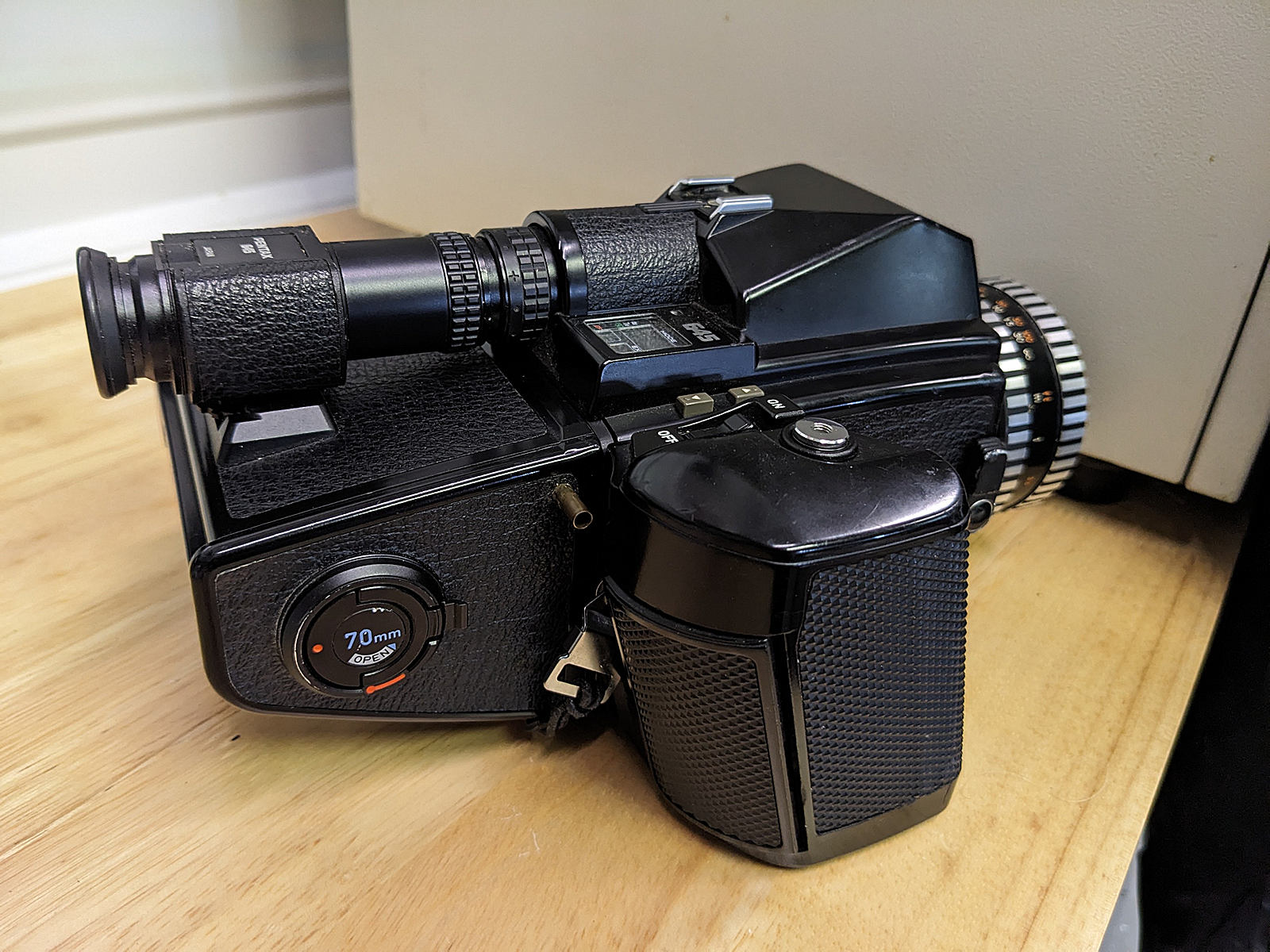

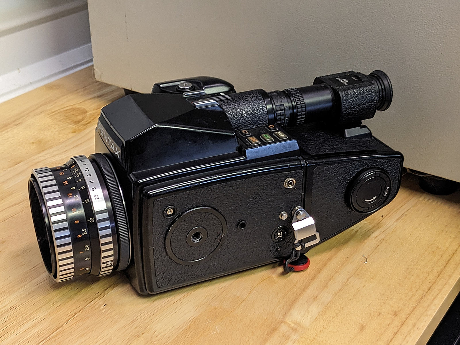

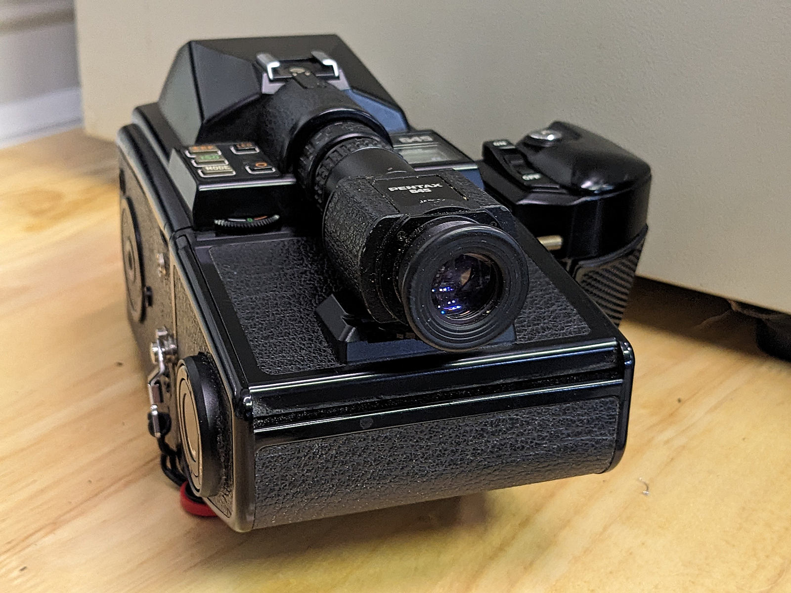

Here's my Pentax 645 with the Kardashian / Badonka Back... ie the 70mm film back. It's so euuuuuuge, you need a eyepiece extension, which I was fortunate enough to find separately. I've run some Kodak 2402 Aero Plus X through it, now I just need a 70mm reel or appropriate spacer extension for my Jobo tank.
I reeeeeally need to find a source for a short end of 65mm Vision3 so I can experiment with that as well.
Balances nicely with my 80-160 zoom (approaching weight of Pentax 6x7 )
Are there any good ways to store 70/65mm negs? I suppose I could always slice them...

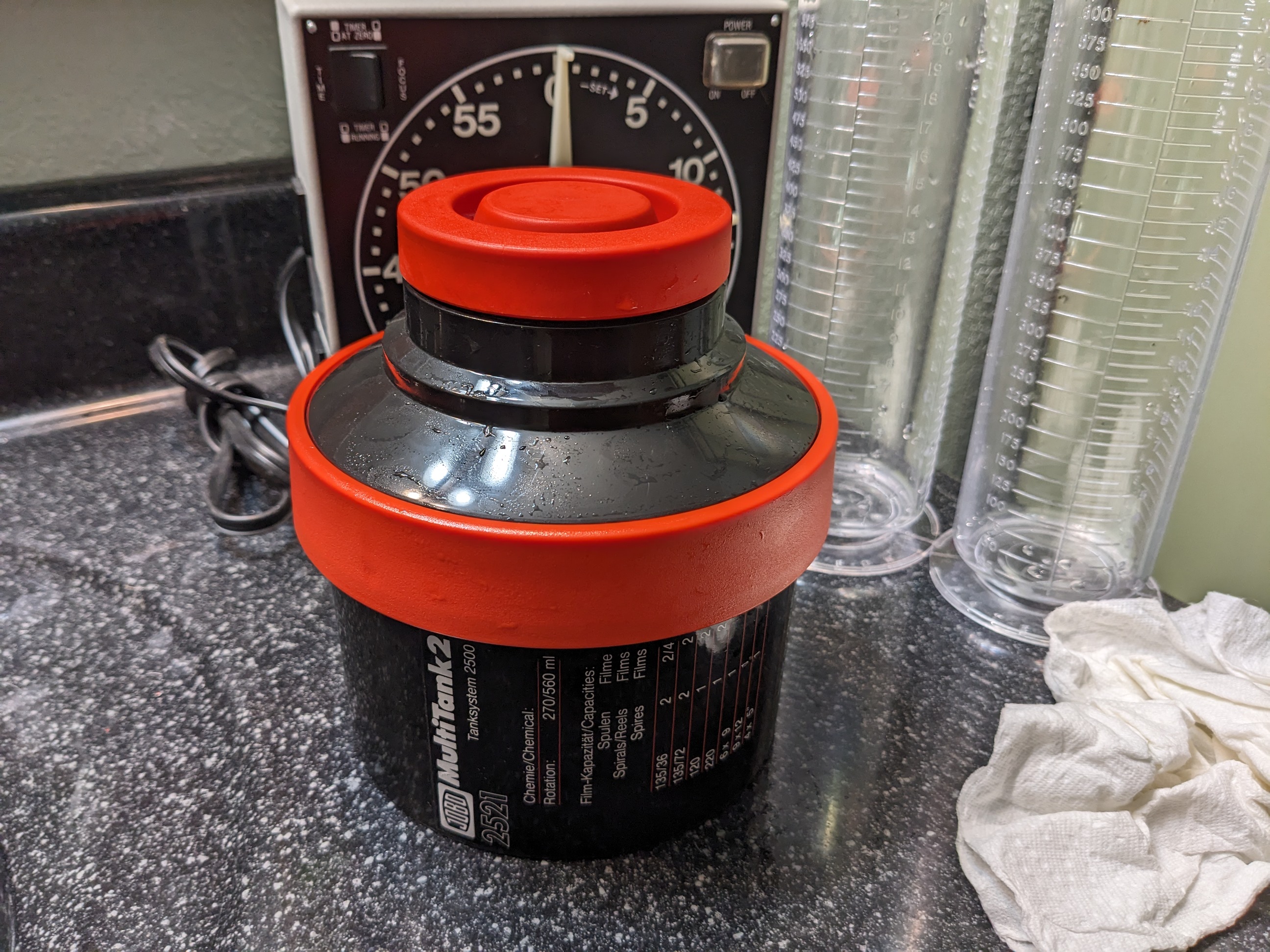

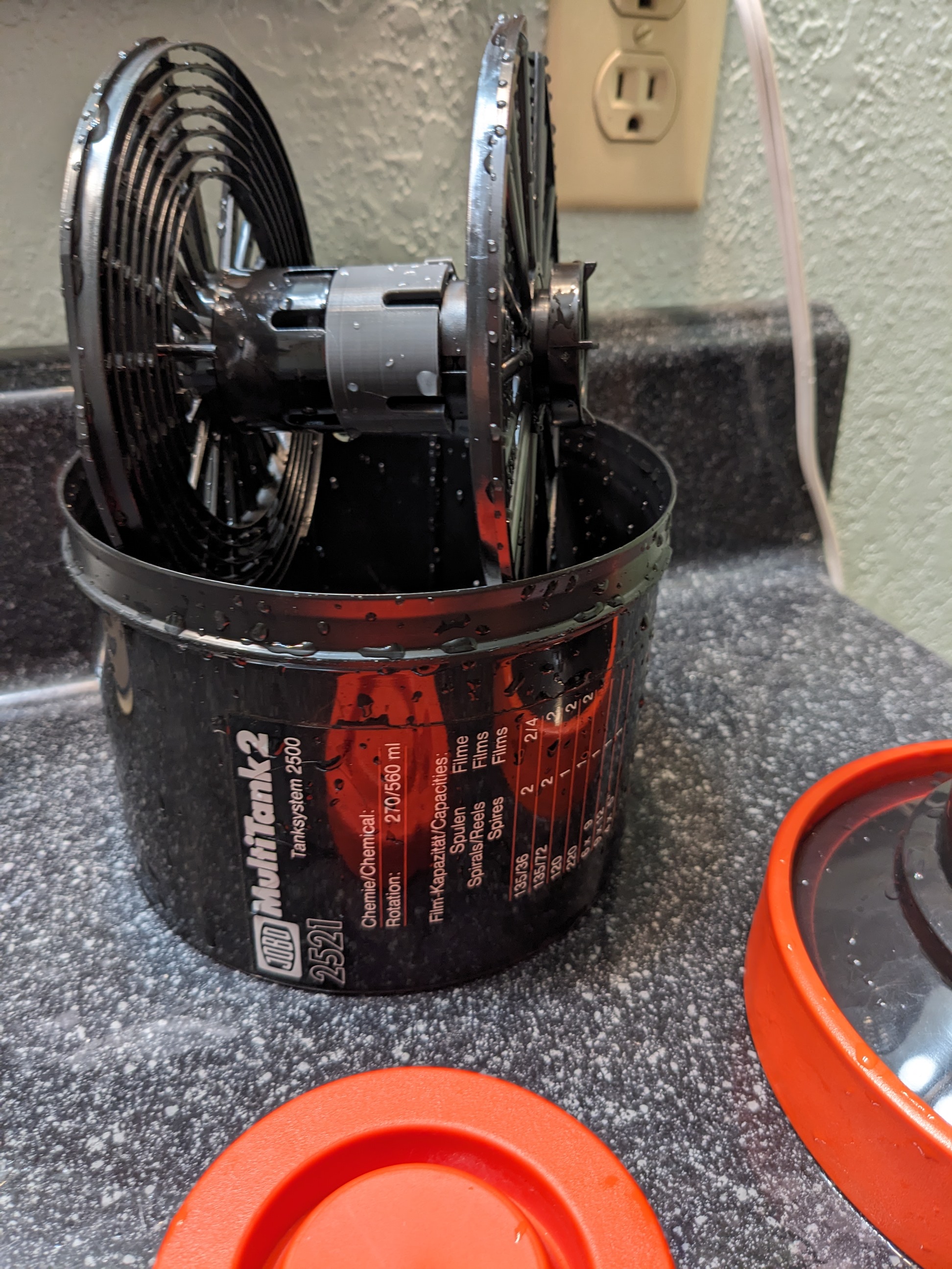

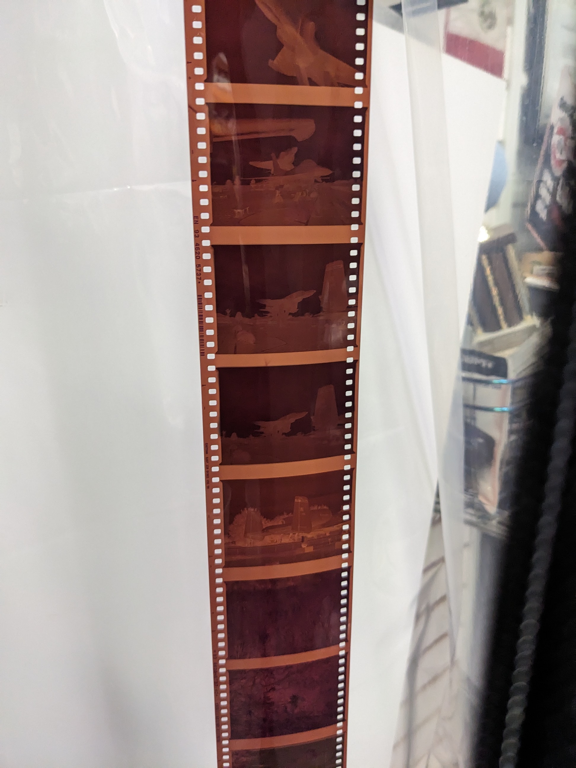

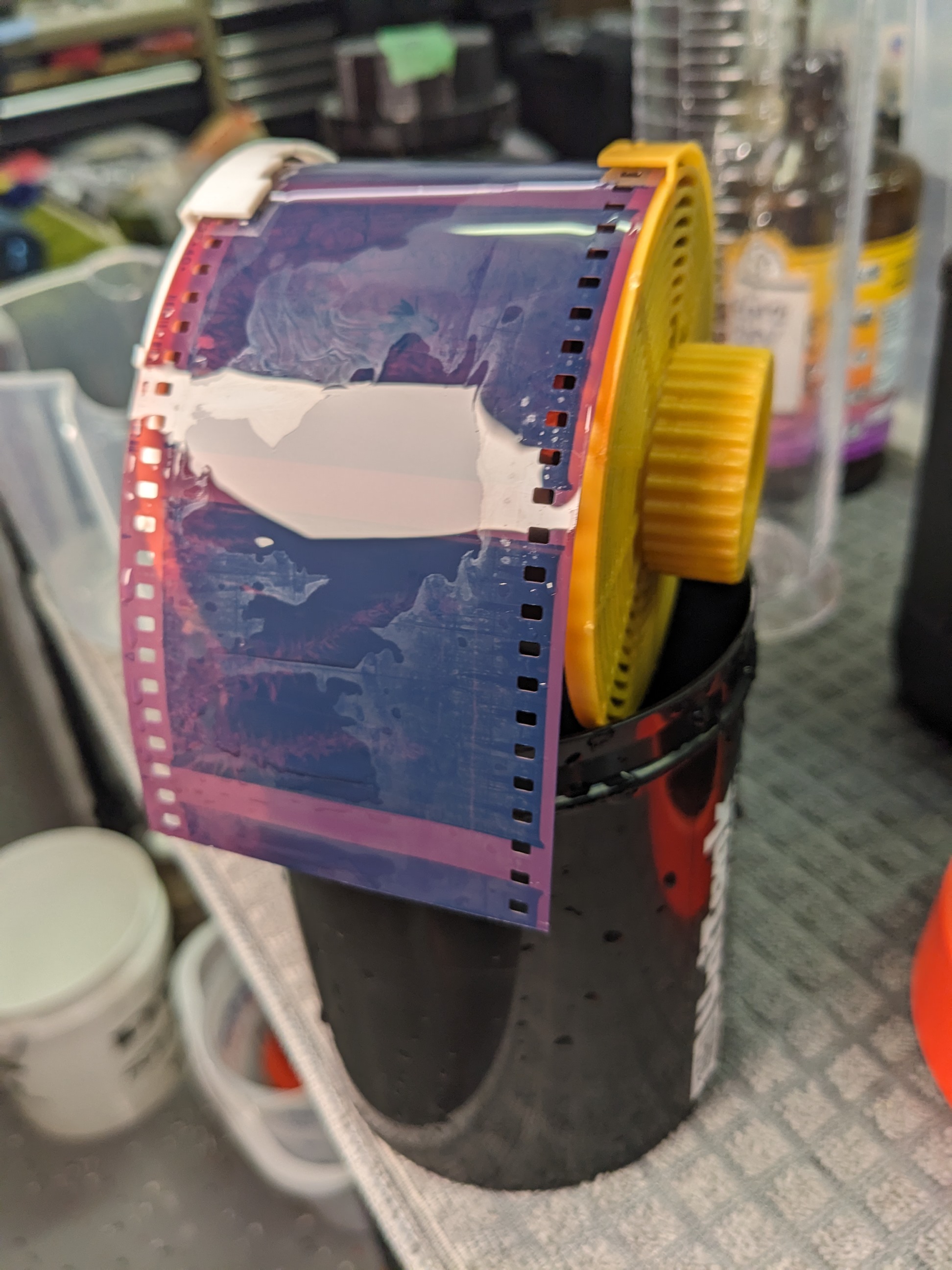

First results from some Indian 2402 aero plus-x run through my Pentax 645 70mm back.
Jobo spacer found on thingiverse and 3d printed.

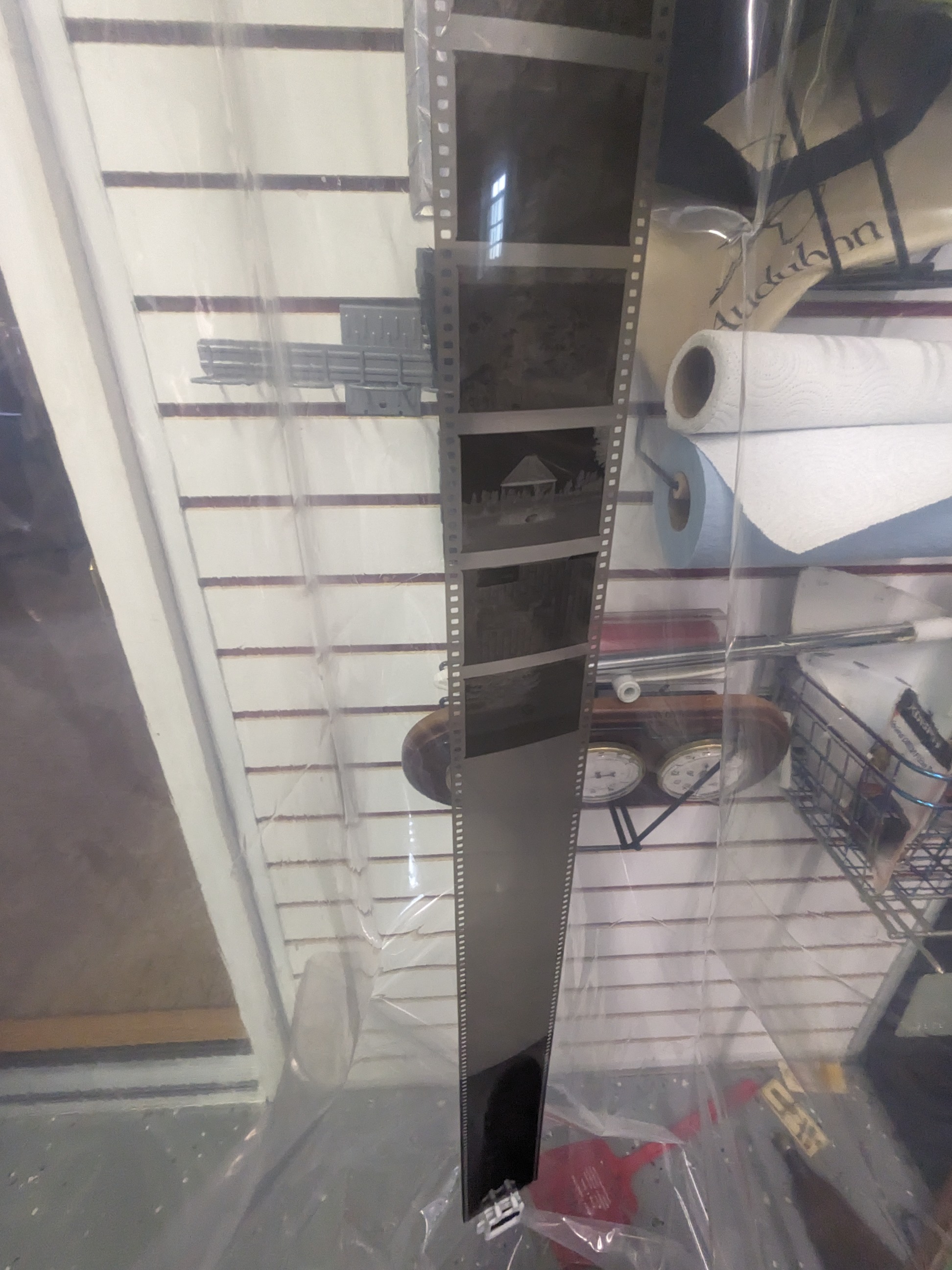

Maybe it wasn't easy, or necessary smart, but I made it happen.
Now I just need to figure out a way to hold the negs for scanning
Cut them down or 3d print....
I use a negative holder from an enlarger. Holds it pretty flat for DSLR scanning.

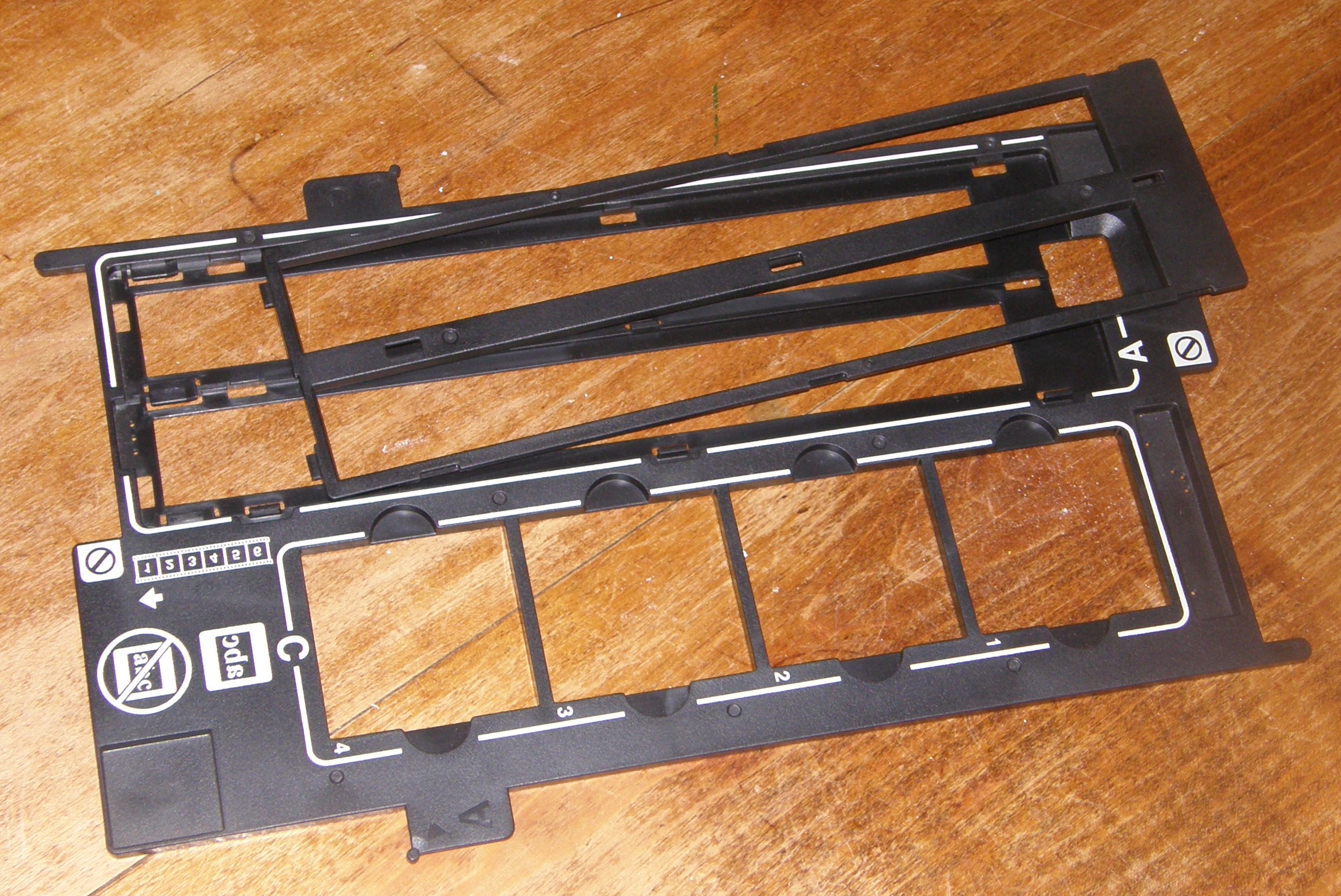

To scan 70mm, I have taken some old 35mm 2-strip holders (for an Epson V600 I no longer have), and sliced out the center plastic piece separating the strips.
Lots of cutting, some sanding of projections, and some epoxy and time under some phonebooks later, I have this:
It works... good, I guess. Better than OK, but it took a lot of tweaking and it's still not quite 100% (more sanding of projections!). Some eBay vendors have made holders for 616 and 116 film (which is 70mm stock), but this ended up being the better solution for me because 1) I had 2 of those V600 35mm strip and slide holders lying around doing nothing, and 2) I don't shoot a lot of 70mm.
ETA: I see on evilBay that one can buy these holders (the original, in the first photo) in bulk quantities, 5 or 10 at a time. So this could still be a solution if you're leery of cutting and then scanning 70mm 1 frame at a time.

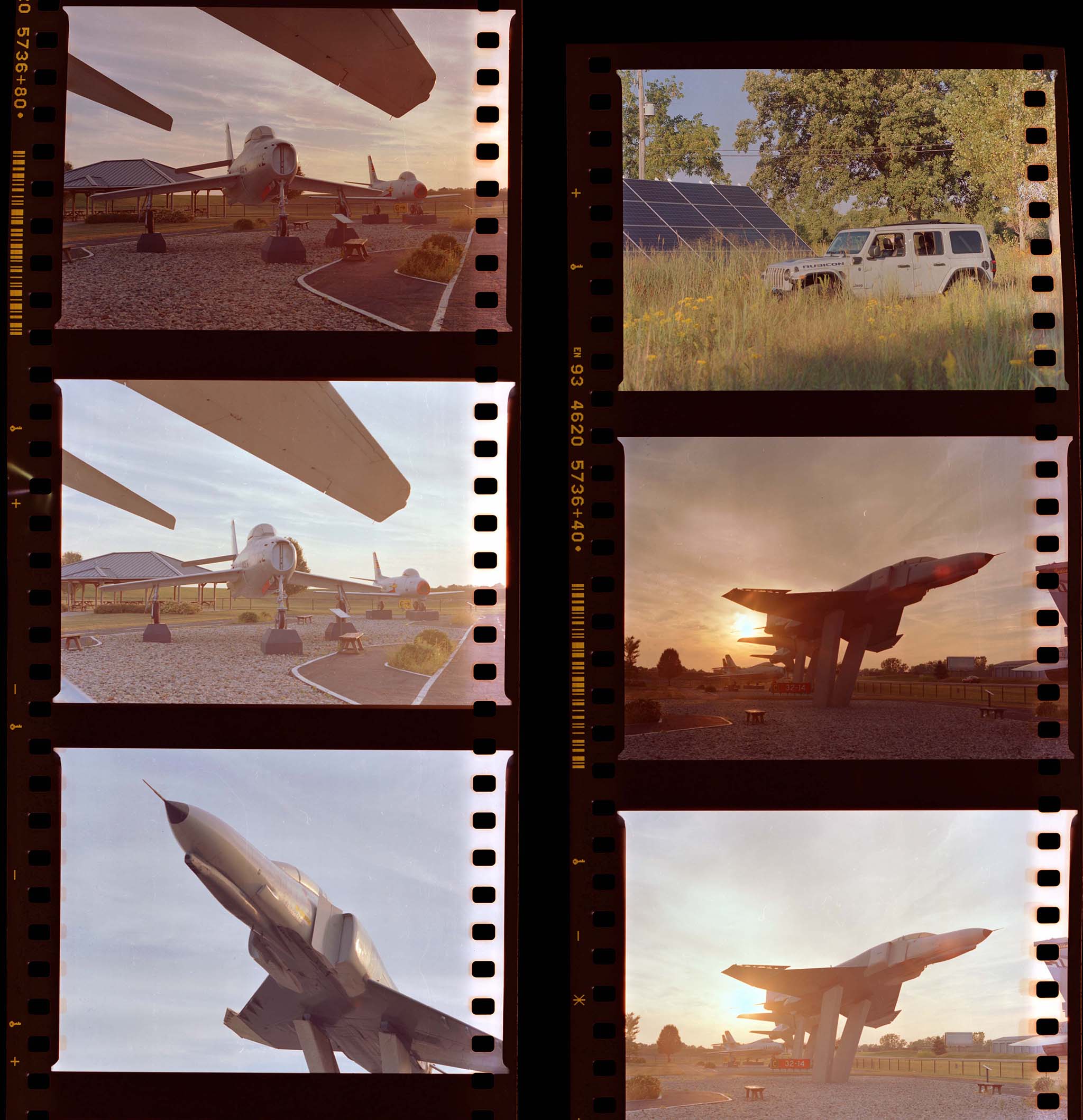

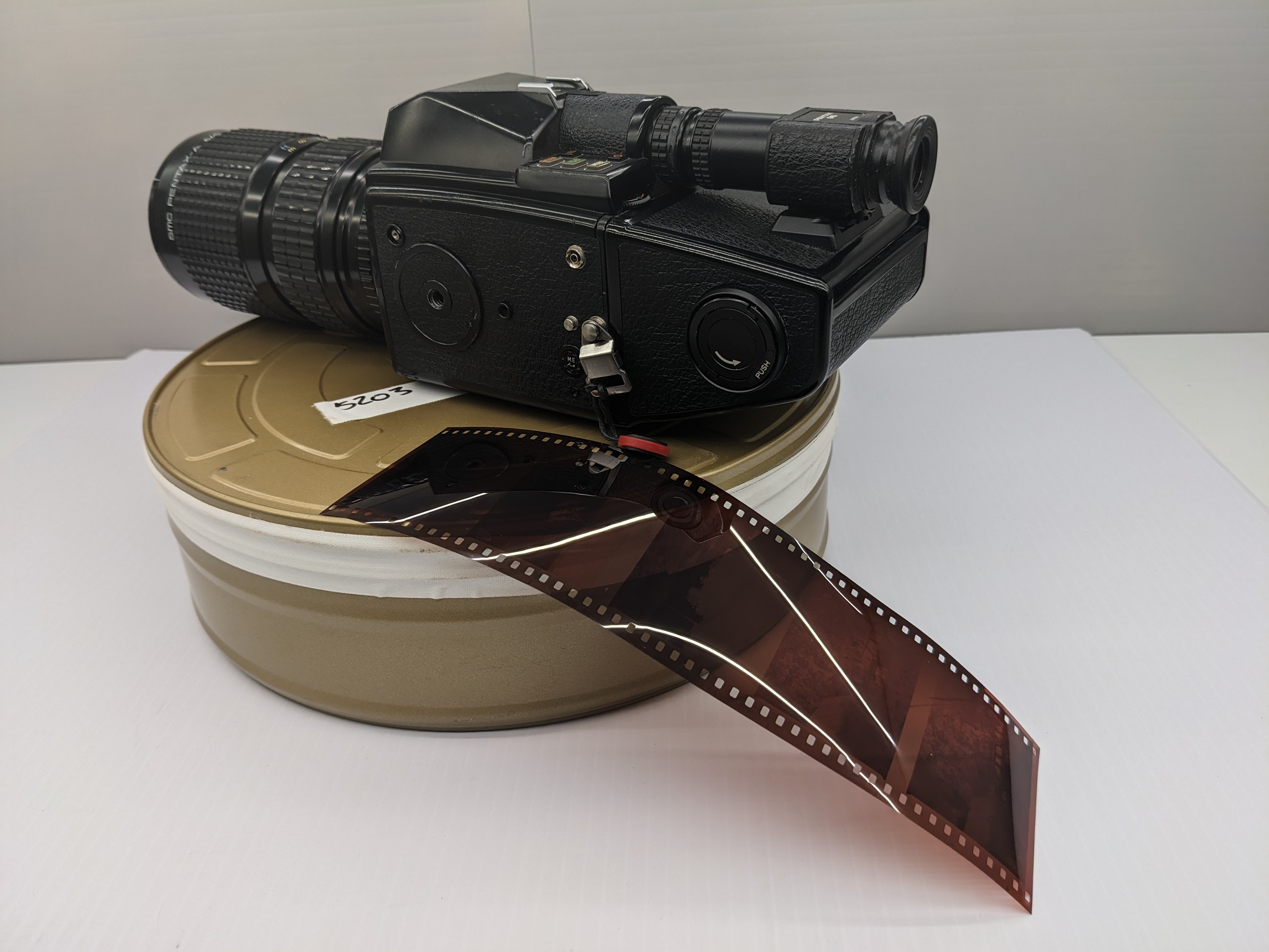

Well I got my Pentax 645 loaded up with some Vision3 250D. I posted about a month ago that I acquired a 70mm film back for my 645. With a little conniving, filing and spooling of film, I managed to run some Kodak Vision3 250D through it. I've got a bit of sprocket burn, so this was likely because of the outside of the short end. This was processed in c41 (not ECN2) and (badly) scanned on my Epson with the Printfile page on the platen. Because I don't really have a 65mm carrier ATM. But as proof of concept, it appears to work.

Looks like a great start to me!
Of course, all of this would be a lot easier now with the Mercury Works 65mm ecosystem! 😉 It would also result in you losing a bit less image to the perforations.
We don't have a flatbed scanning holder, but we do have a negative holder for camera scanning.
And yes, indeed, short ends are by their very nature unpredictable, as they have lived on a film set, been loaded and shot in a camera, then manually unloaded, been exposed for who knows how many months to heat and/or humidity, then been stored in indeterminate conditions since. But I think you're getting pretty good results, given all that. I personally don't trust short ends, but the Malick film we're giving away was actually a short end, so you never know!
