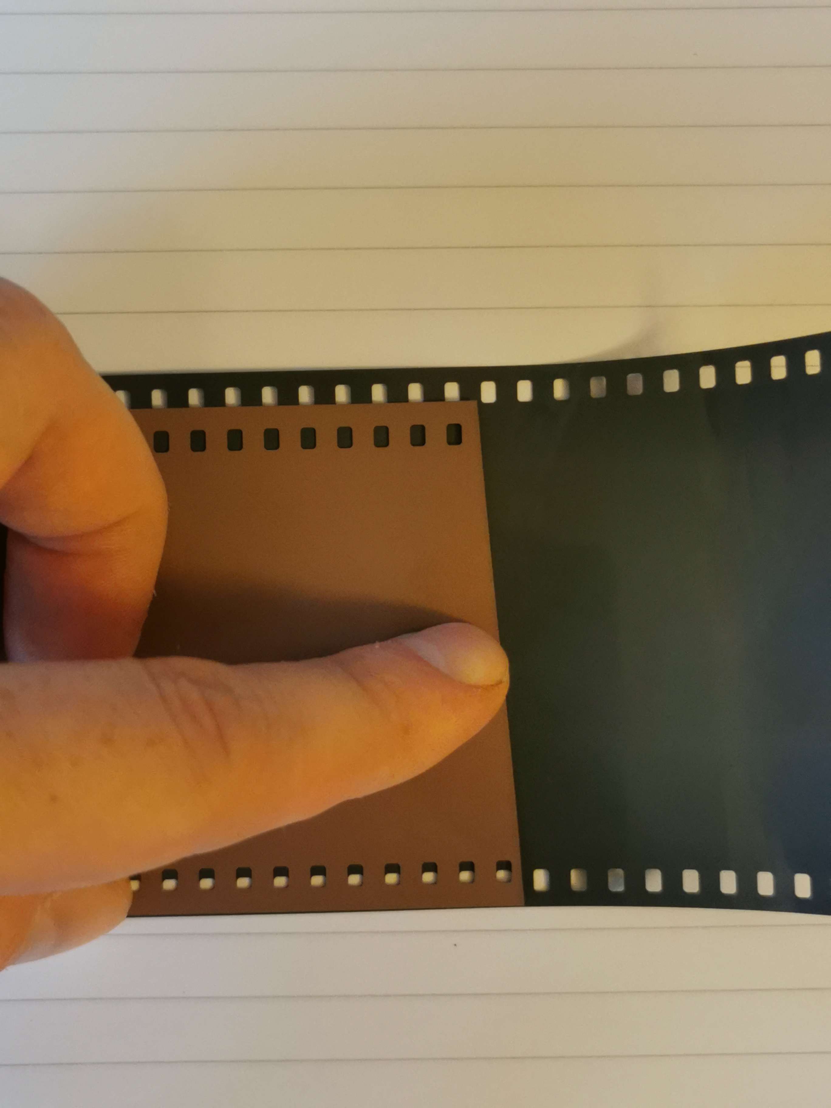

Are the perforations for 70mm film the same size, and spacing, and distance from the edge of the film as 65mm film?
I could not find this on the "Everything you wanted to know about 70mm film" link, so I'll ask here -- I am not a 70mm user.
No, they are not. This is not my image, but it demonstrates the difference very well. 70mm Aviphot 200 vs 65mm Vision3 500T:
65mm / 70mm ( motion picture stock ) was originally designed for contact printing, so perforations are in the same position.
Unlike 70mm ( stills ), these perforations are at a wider position ( same distance from the edge as 35mm film ).

Thanks for this info. So there are really three films here regarding perforations -- 65mm motion picture, 70mm motion picture, and 70mm still picture.
The perforation size and spacing is the same on all, but the position from the edge is closer to the edge on the 70mm still picture film. Is that correct?

Well, there are two types of 70mm still picture perfs (Type 1 and Type 2), as well as non-perf, of course.
For motion picture film, 65mm camera negative and 70mm print film both have the same perfs (with the same specs). But the 70mm film is wider, so the perfs are 2.5mm farther from the edge of the film (this extra area is allocated to soundtracks). I'm happy to provide more info, and post it to the site, but am not sure which of the many possible measurements is significant to you. What is it that you're wondering about?

You are super overthinking this. It is a bit confusing at first, but nothing nearly this complex.
  • 65mm film is meant to make raw camera negatives for movies, and was never meant for still photos. It is always perforated with motion picture perforations.
  • 70mm film is used for both movies and stills, though they are completely different depending on the application.
    • 70mm stills film comes in perforated type II and unperforated.
      • Type II perforated film is what most people look for when they want to get into 70mm film, as it is compatible with all 70mm backs. This is what normally came in pre-loaded cassettes.
      • Unperforated is used in most long-roll cameras, and was meant to be used in large loads (100, 150, sometimes 300 ft) I’m length. These are less desirable to 70mm shooters due to their incompatibility with some backs.
      • Although type I does exist, we don’t care about it because it was a very early iteration of 70mm, and pretty much only saw major use in the early military areal cameras, and the NASA space cameras.
    • 70mm for movie prints has the same perforations as 65mm, as it needs to be comparable with print making equipment for the 65/70mm movie workflow. The extra 2.5mm on each side used to be for the soundtrack, but is now just there for compatibility with old equipment.
