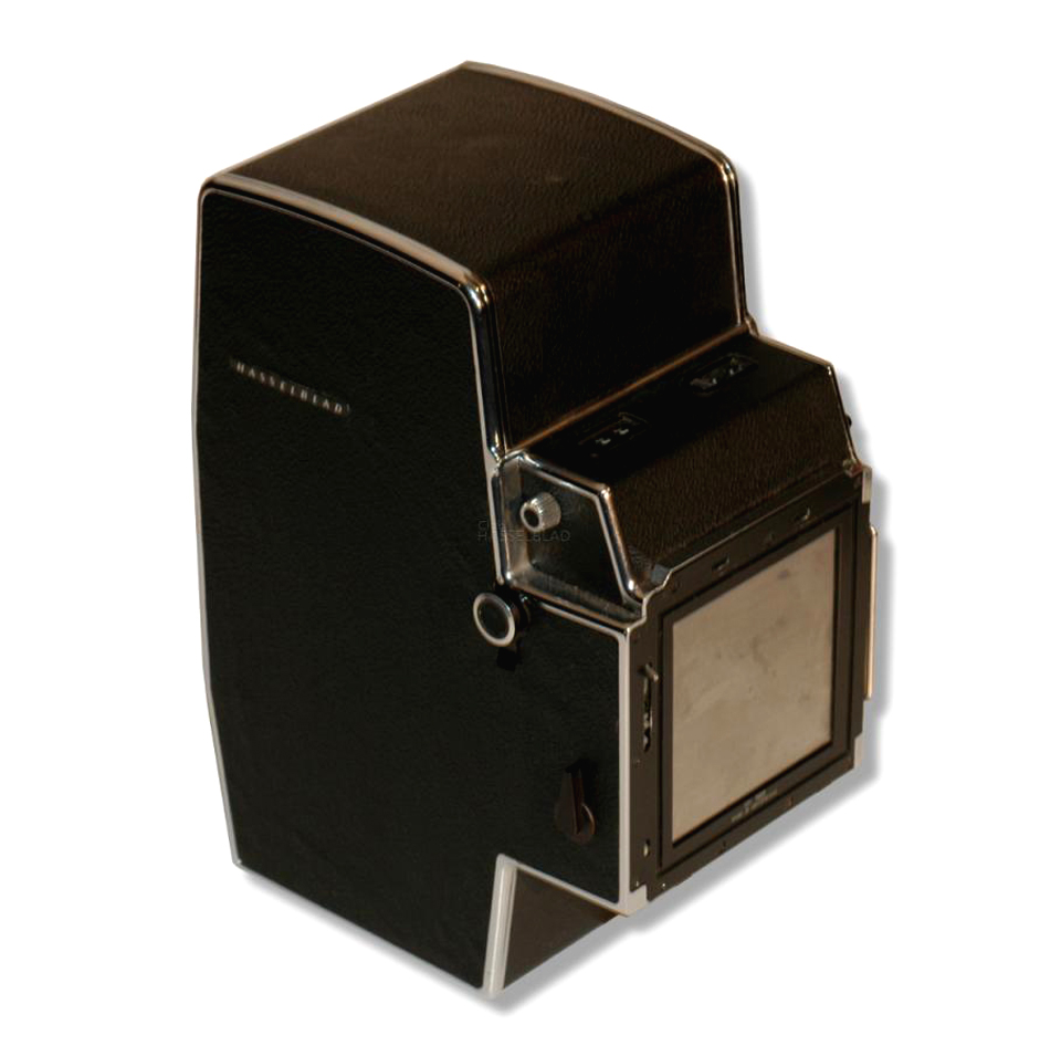

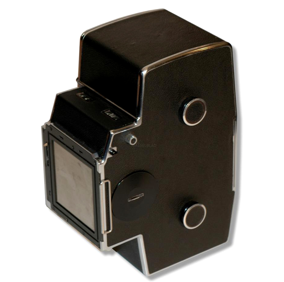

Don't forget this monster from Hasselblad.
The 500 exposure magazine ( pictures courtesy of 'Club Hasselblad' )

That is a lot of frames to process at once. I'm cautious processing 5 rolls of 120 in a Jobo.
Just think how the operators of the Kodachrome processing machines must have felt. Each and every spliced together reel had about a mile of film on it (plus a mile of leader and a mile of trailer). Reel after reel, day after day, and in busy times of the year, 24 hours per day.
