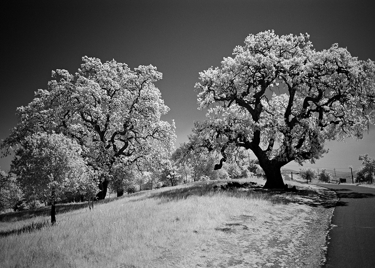

here is a simple small resize. hand held, shot at ISO 4, so F4.5 1/60 as metered with incident meter. Stanford Dish trail. this time of year the oaks just look great with IR. always hoping I get a secret IR something when I shoot the radio telescope. alas, another year, another no message:smile:
another thing that really helps, A rangefinder! shot with a contax G1. side sun and still get that great glow!

Beautiful!

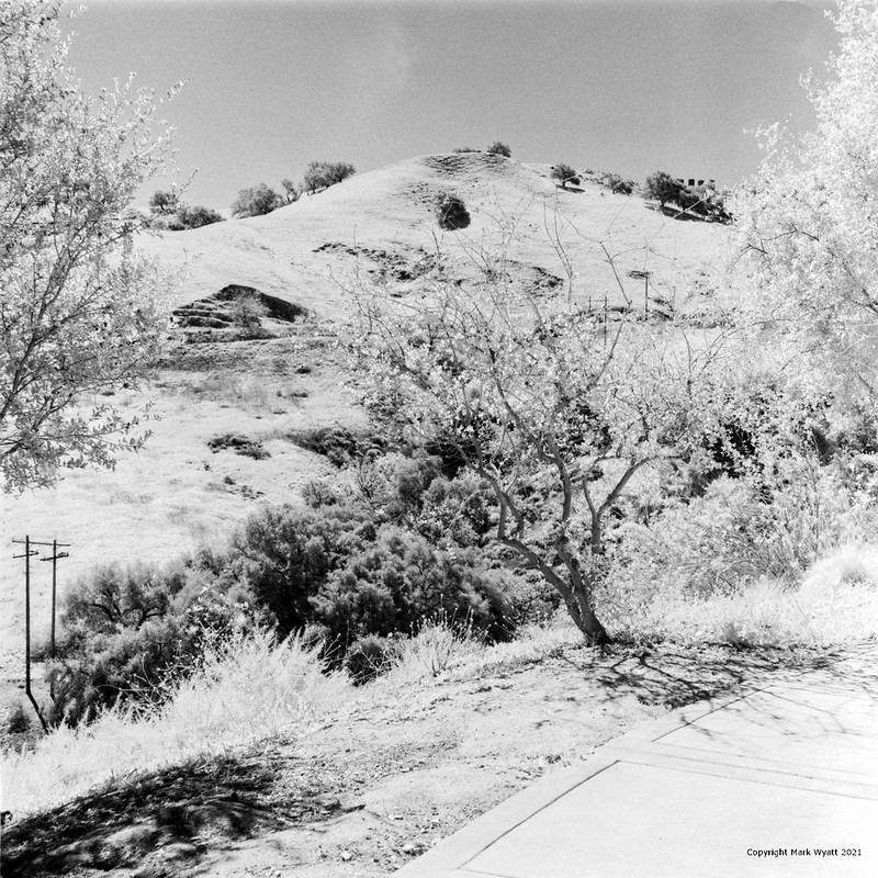

Interesting shot of oaks. I shot Rollei IR 400 w/720nm filter, and the oaks respond much less strongly than grasses and other types of trees (typically lighter green leaves). Here is one. See the oaks on the left side of the distant hill, and the gorge below. There is a little response, but not compared to the [green] grasses, and for instance the tree on the right. Sun was pretty high in the sky. Were the grasses green or dry in your shot? TLR helps for sure!
I externally metered at ISO 6 w/720nm filter on. Looked at incident and reflective (avoiding sky).

all the white leaves in my pict are from new growth leaves. old leaves on other types of oaks will not give me white leaves either. only new growth leaves give off strong wood effect.
The light green (new growth) seems to be key. Was the grass dry or green?

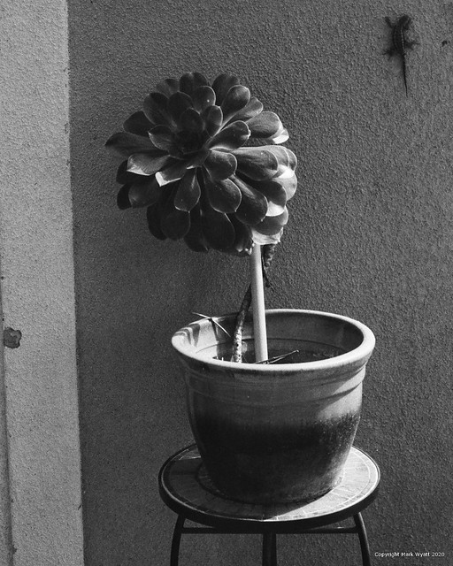

What about this? Look at this succulent. But note that it's trunk is also reflecting a lot of near IR. Even more interesting, there are two wood dowels holding the plant up (the plant is wrapped around one, and there is another right next to it leaning to the right). They may be pine dowels. They also seem to be reflecting a lot of near IR! Maybe they are just re-reflecting light from the succulent? In infrared imaging, you have to watch out for emission sources that can misinform you about a nearby object's temperature. To the right, in the distance you will see other trunks, and other pieces of wood holding a pant up, but they do not reflect near IR to any excessive degree.
Potted Plant
by Mark Wyatt, on Flickr
You can see one of teh dowels in an earlier standard B&W image. It is pretty light in color with a MedY filter.
Potted Plant

I almost want to say it would work better on C3 plants like potato, so one could use EIR to detect wilts. Interestingly thermal IR coupled with near-IR has been investigated for sensing when to irrigate crops (here). Interesting though, the dowel may well be very reflective as pine is a pretty light colored wood. It wouldn't be surprising if the stem of that succulent is photosynthesizing as well, they've got some pretty crafty mechanisms to survive in dry conditions. Anyway, I digress! That's a neat picture with some real fantastic wood effect Mark, it really makes me want to try doing some IR imaging of my garden this year. What film did you use for those?
Potted Plant
