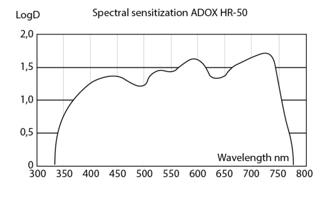

How about Adox HR-50 Speed Boost? Is that also a rebrand?
The curve looks a lot like a smoothed version of the S80 curve and has a clear base suitable for SCALA.
Looks like a pretty nice film and they claim to have “Speed boosted” it whatever that is?
Team Adox do you have any comments?
HR-50 does indeed have good IR sensitivity. It also has remarkably fine grain, more so that any IR film I know. The Speed Boost technology is rumored to be a preflashing technique to reduce contrast, kick shadows off the toe.
