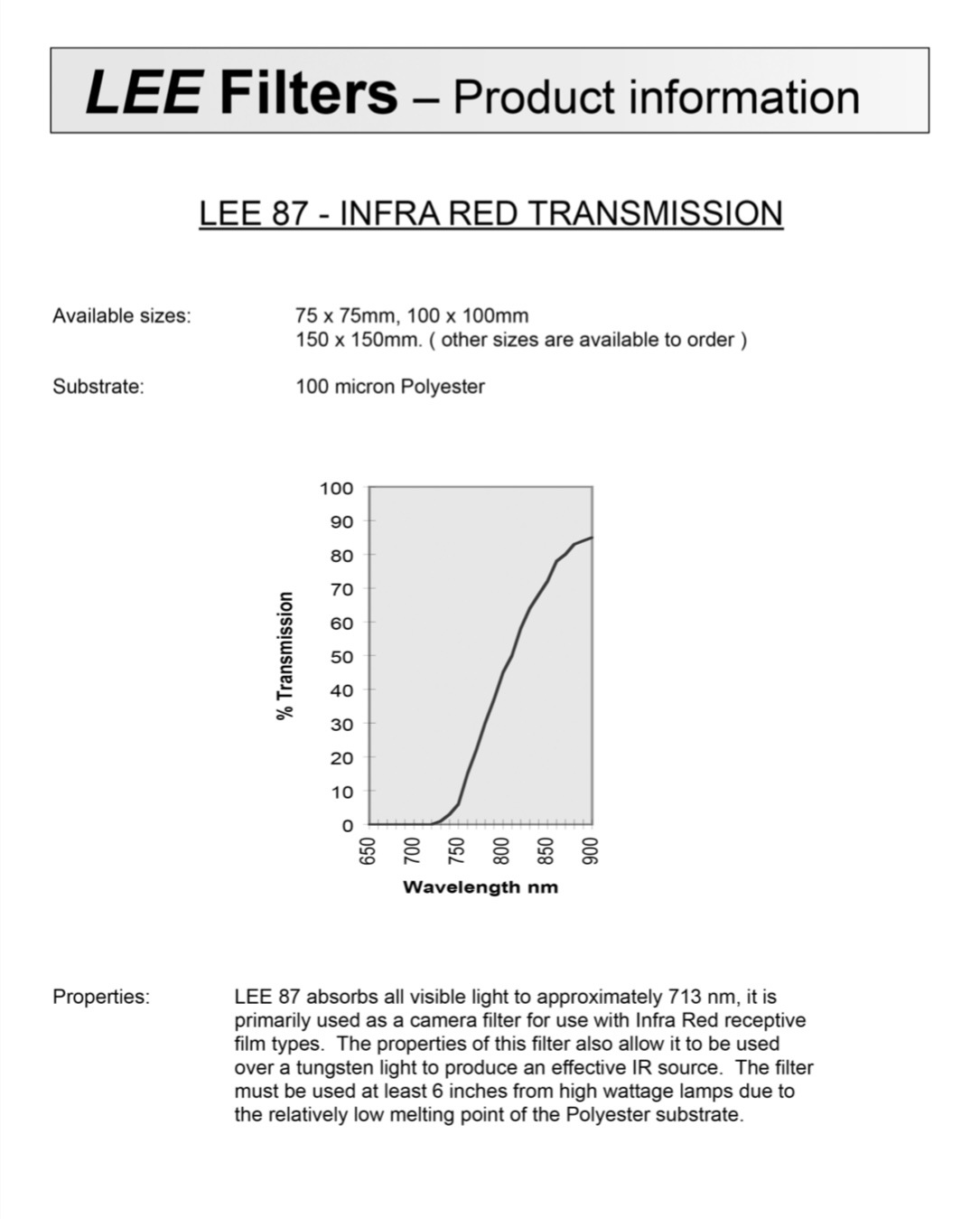

Is this crazy?
Is the cutoff too much for the current crop of NIR films?
Is it close to R72?
Is this a case of the curves just being in differently scaled coordinate systems?
It’s very cheap where I live though.
Some might say “just try it”. But you can do a lot of dicking around, wasting time and money on film, thinking other factors might be at play.
Edit: found this:
https://www.photrio.com/forum/threads/infrared-with-rollei-ir-400-and-lee-87.140963/
Seems it is possible.
Anyone with actual experience with the filter?
