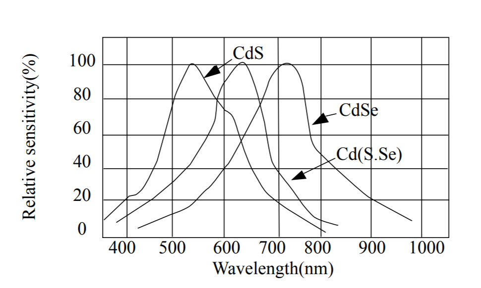

Most electronics are sensitive to IR like silver halide is sensitive to UV/blue intrinsically. Often the peak of their sensitivity is in IR. Youd have to know the particular detector being used in your camera.
CdS LDR
Photodiode
https://www.ti.com/lit/ds/symlink/opt101.pdf?HQS=TI-null-null-alldatasheets-df-pf-SEP-wwe

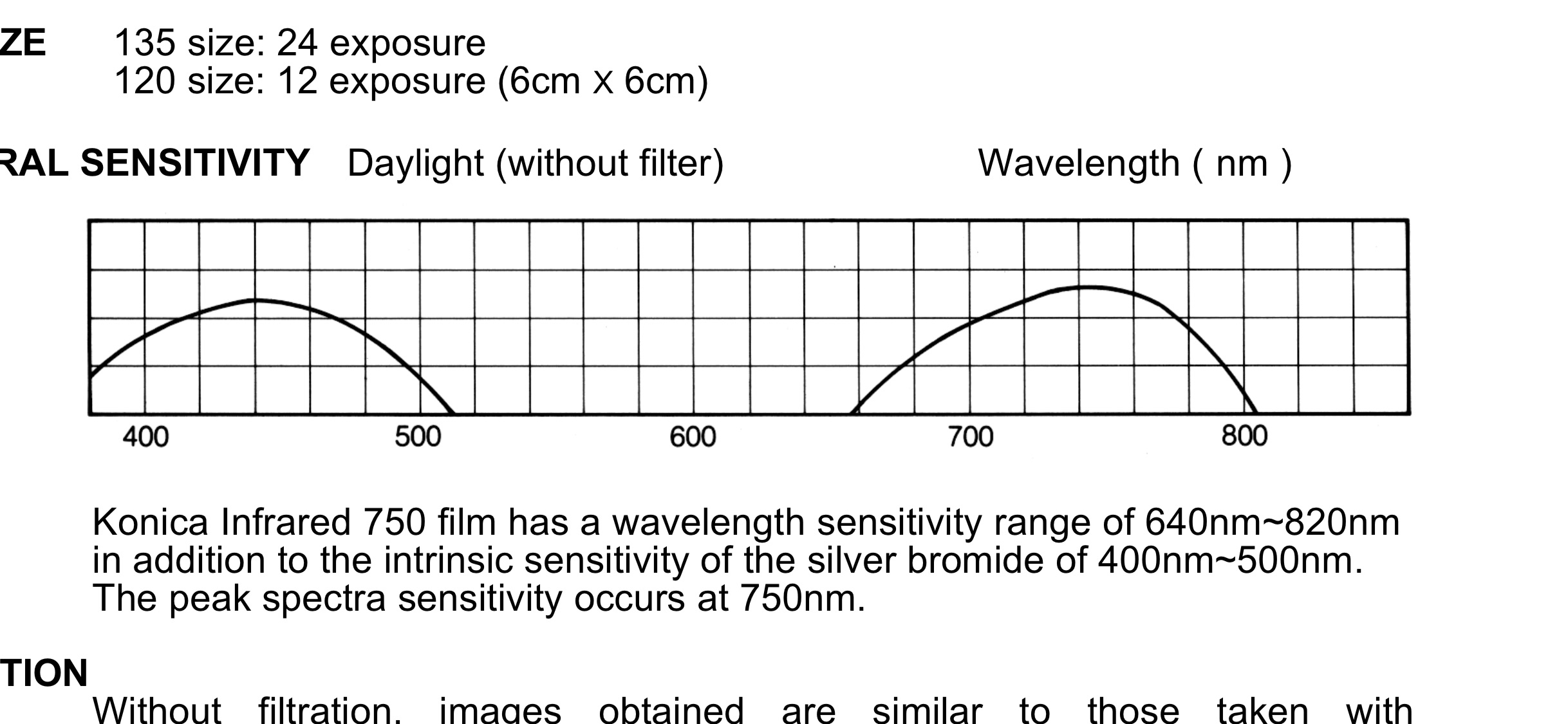

Looking at Laurie White Hayball's book on IR photography the spectral response of Konica 750 would appear to extend further than Ilford SFX So for instance and in a comparison of pictures, Konica with an orange filter already appears to exhibit the start of the "wood effect on tree foliage With a red filter this extends into the grass area but the sky still hasn't gone as dark as in the same picture with an IR filter. In the pictures in the book hardly any of the Konica skies are as dark as in BAC1967 even with an IR filter but this may be accounted for by reproduction in a book and presumably where in terms of clear air and at what height the picture including the sky was taken. I have seen some pics in high clear mountainous area with an non IR film and a mid yellow that in the U.K. at near sea level I would have had difficulty matching it with a red and polariser combined.
pentaxuser
Konica's IR spectral response is as per this document: http://photo-element.ru/book/pseudo_ir/ir_films/KONICA_inf_750.pdf
As a "true" IR film, it shows the basic silver halide reponse to blue light and then is sensitized to IR radiation. There is essentially no response between 500 and 650 nm so there is no need to filter out light in that range. Konica recommended only a red or orange filter. Its peak response is at 750nm. A R72 filter should enhance the Wood effect, but shouldn't really effect the sky much.

I think CdS is likely to be the most common photo resistor used. A lot of Sekonics use a silicon photodiode though. It depends on the maker, they might filter it, or buy parts that have a spectral response suppressed for the visisble spectrum.
I can only imagine the more IR sensitive the detector is, the more it would need an IR-cut filter in front of it in order to get accurate visible spectrum metering. I attached an example from a cheap action camera, which I removed the lens and put another lens on (the IR cut filter in these cameras is usually on the back of the lens, not on the sensor, the new lens didnt have one), without a filter to cut IR you get a lot of IR mixed with visisle spectrum. After that I made a lens adapter both with and without an IR cut filter.

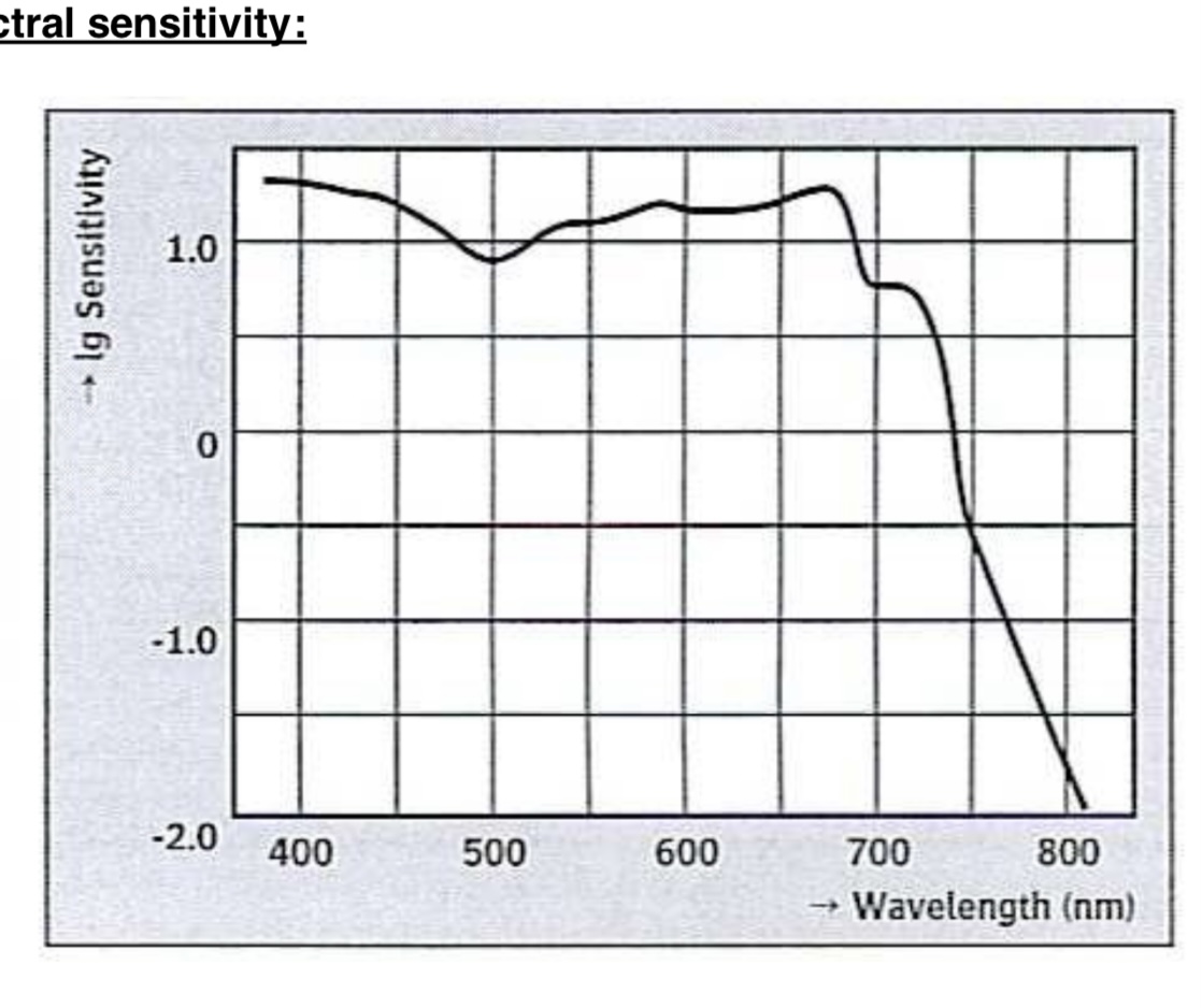

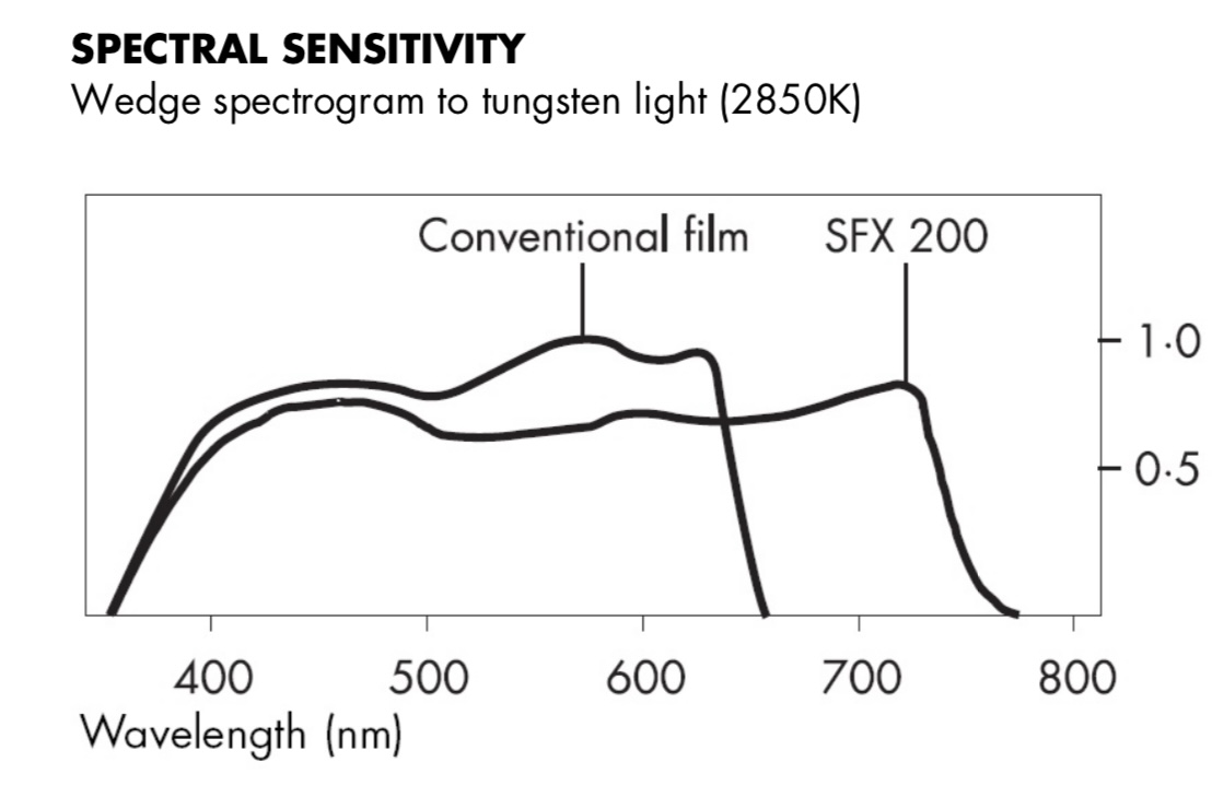

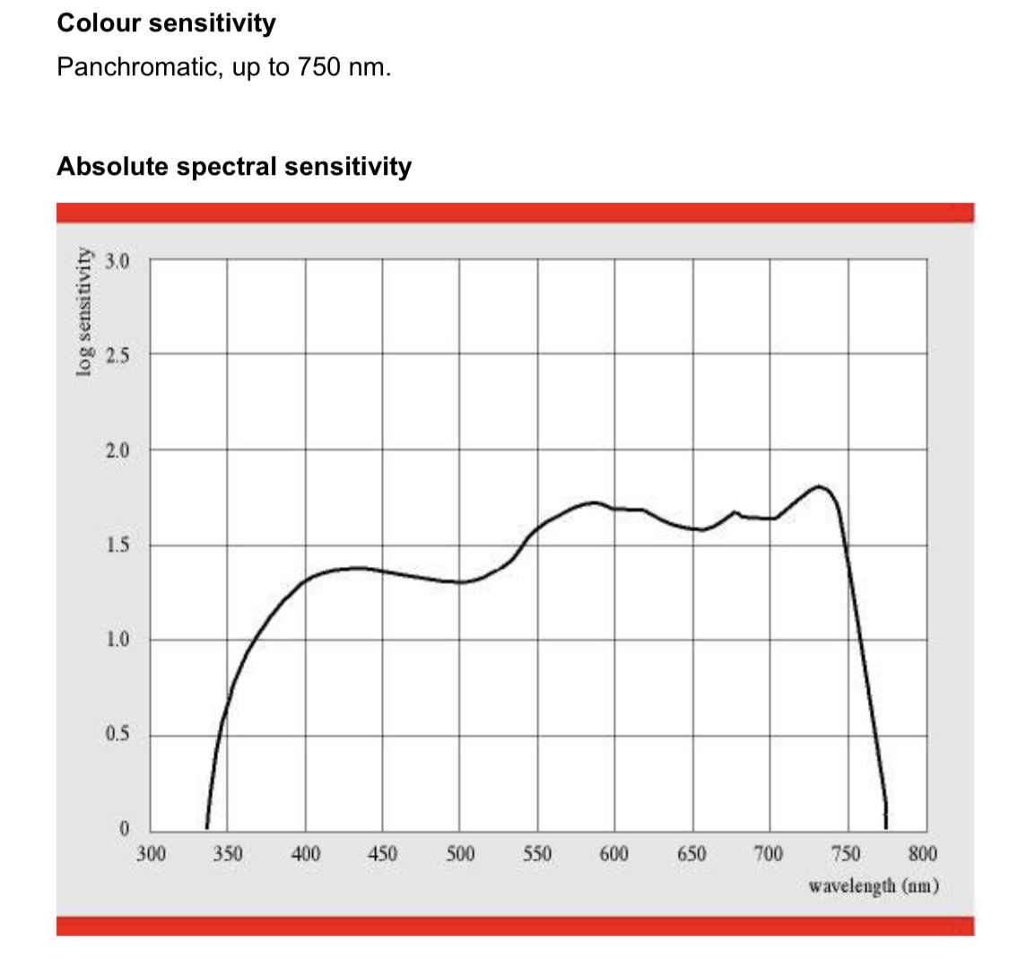

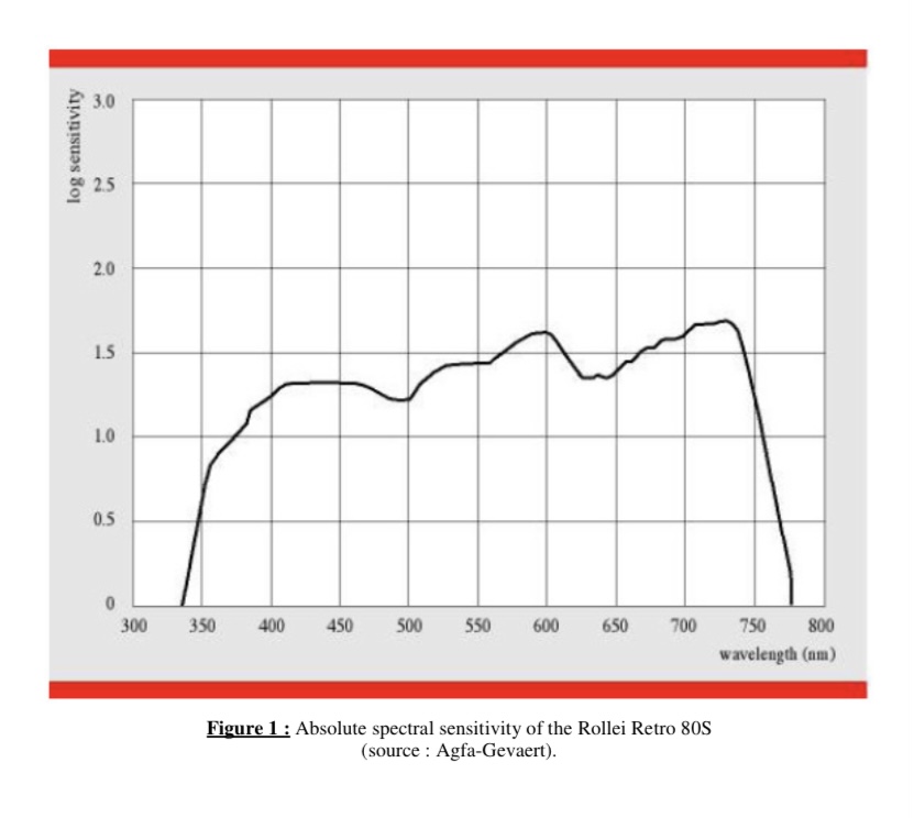

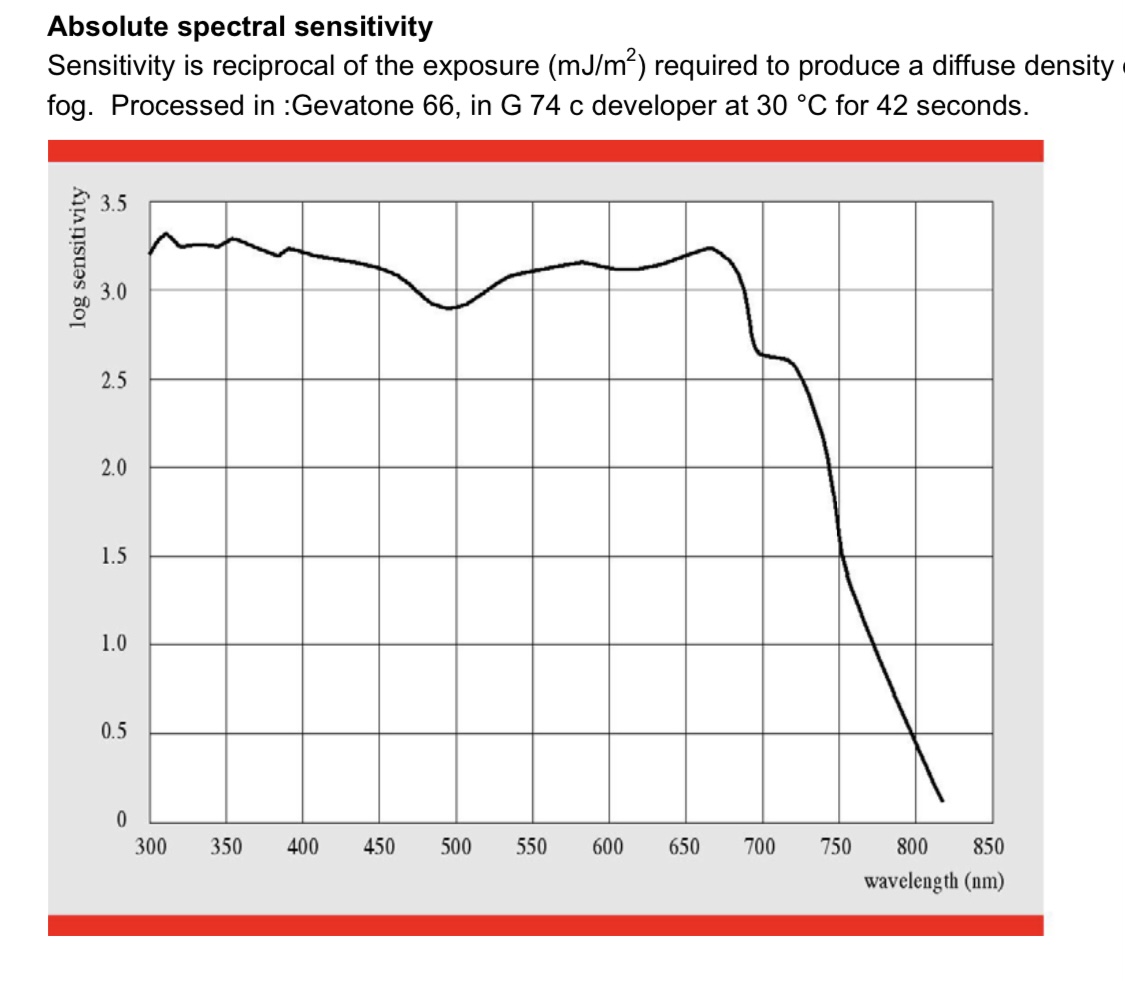

What we lack in this thread is a clear concise list of all of the IR films currently available and the characteristics, pros and cons.
Let me try a first wee step.
SFX 200
Rollei Superpan 200 (not sure if this is the current curve. This is for the Aviphot Pan 200 which Superpan 200 was derived from).
Rollei Infrared 400
Rollei Retro S400
Rollei Retro S80
Is this all of the NIR/IR films currently fresh and on sale?
SFX 200
Rollei Infrared 400
Rollei Retro S400
Rollei Retro S80
You forgot Rollei Superpan 200. But keep in mind that Agfa doesn't produce Avophot Pan 400 for some time now and Rollei IR, 400S and Superpan 200 are likely the same film. The only difference is who does the conversion.[/QUOTE]
Fixed.
Not sure about the datasheet since it appears the A/G stock it was derived from (Aviphot Pan 200) is not produced anymore.
I understand that Superpan 200 is especially good with the Scala reversal process, because of it’s clear base.
Is that something that’s true for the other “Rollei” films?

Fixed.
Aviphot Pan 200 seems to be a current product according to Agfa's website. Over the years, Rollei's repurposed films from Agfa's stocks may have changed. Aviphot Pan 400 might have been used in the past, but it's no longer available, so Rollei IR could have been the 400 variant, whereas today it's converted from the 200. Generally speaking, Maco aren't very upfront about the source of their films, but nevertheless, I'm glad that they make the effort to make some interesting aerial films available to us. And yes, all repurposed Agfa film stocks with the clear polyester base make spectacular slides. They also dry dead flat, which is another bonus.
