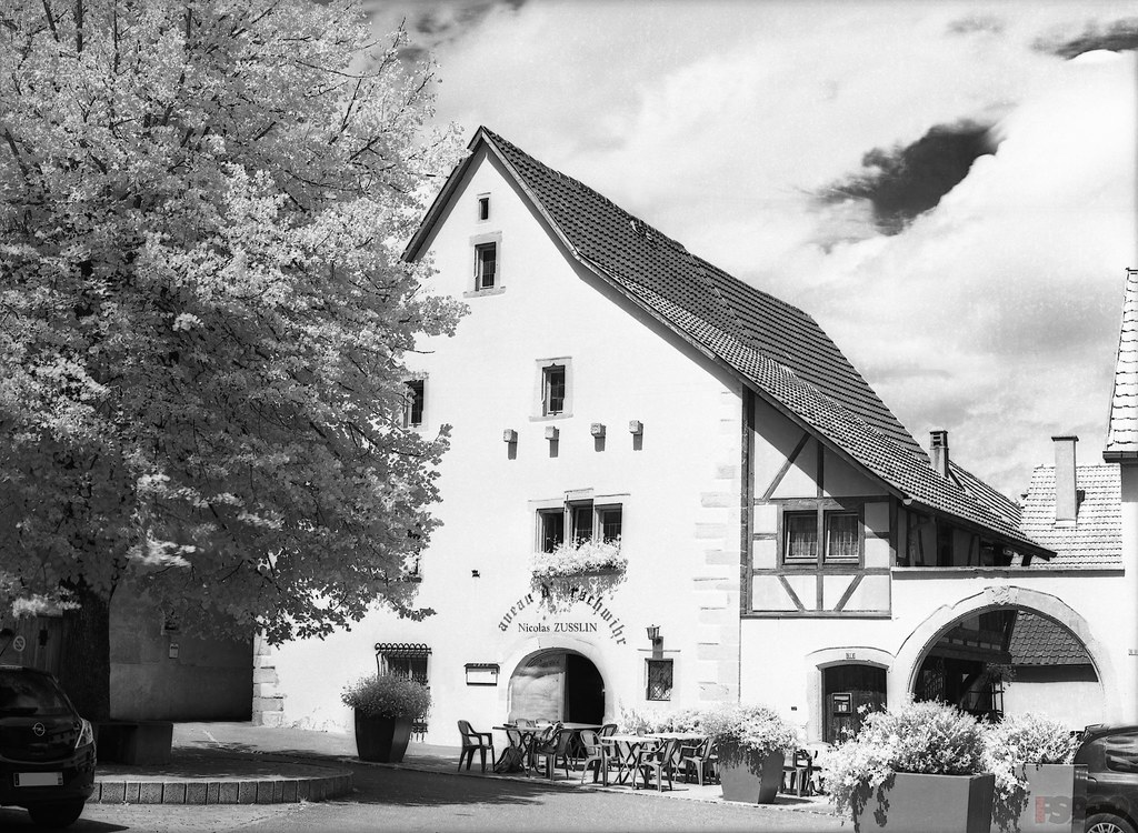

It sounds like fs999 didn't use a filter factor but instead metered through the filter with the meter set to box speed.
With R72. I used the meter of my Pentax 645N through the lens.
Thanks, fs999. I now understand why you cannot give an answer. I would not be able to give an answer either if it was through my lens with a filter on it. Indeed for a long time, like you, I assumed that the camera's meter would properly compensate for any filter so that I had the right exposure without bothering about filter factors

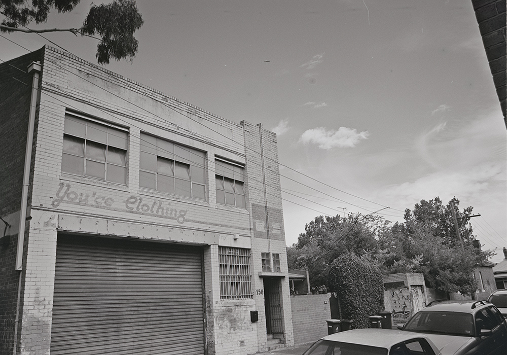

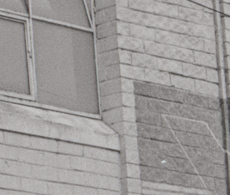

Ive used these films as normal films, not as IR. Rollei Retro 80S. 80S is as sharp or sharper than T-Max 100 with significantly finer grain. Retro 400S/IR 400 on the other hand has quite rough grain. I would not say they are the same film.

Here is what it looks like (as a normal film), the crop is an 8000 dpi crop from a Flextight 949, it is exceptionally fine grained. This is also in Rodinal of all things. EI of 64, and it struggles with shadow detail. It isnt pulled Retro 400S, Retro 400S pulled to 64 would have more shadow detail.

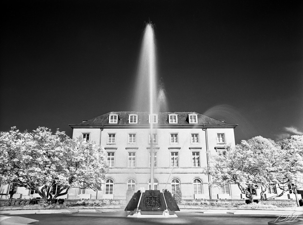

I will look this evening how much this filter increases the shutter speed...
Here some more...
Pentax 645N • Pentax FA 645 45mm f:2.8 ED • Infrared R72 filter
Rollei Retro 80S developed in Caffenol CL 50min stand @ 20°C
PENTAX 645N • Pentax FA 645 75mm f:2.8 ED with IR72 filter
Thanks for this further set of prints. Again I see no signs of underexposure but to at least establish what your in-camera meter is doing with a R72 on it it will be helpful if you can check and report what is is doing so we can all see.
