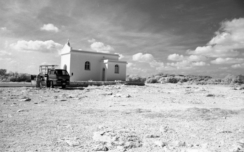

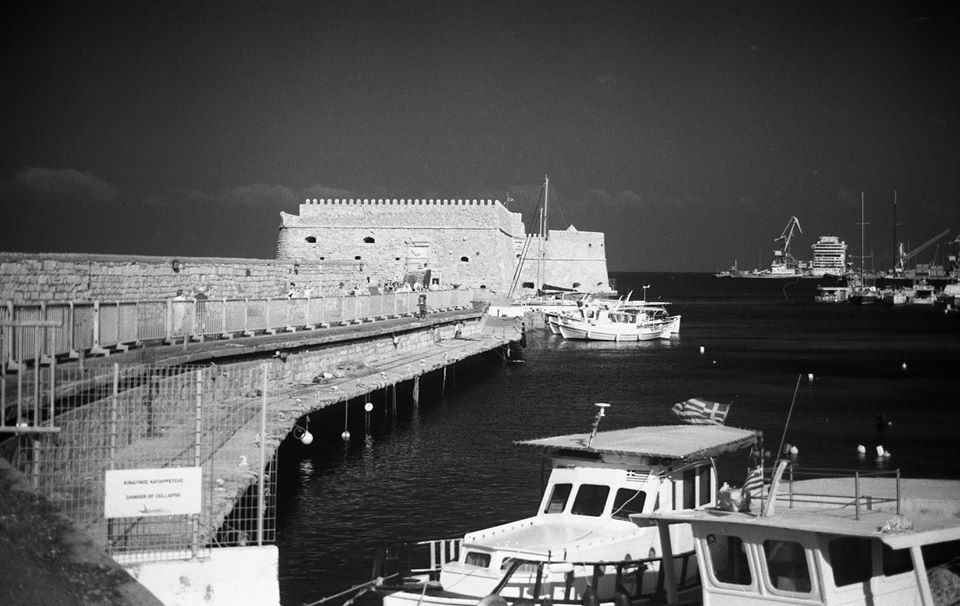

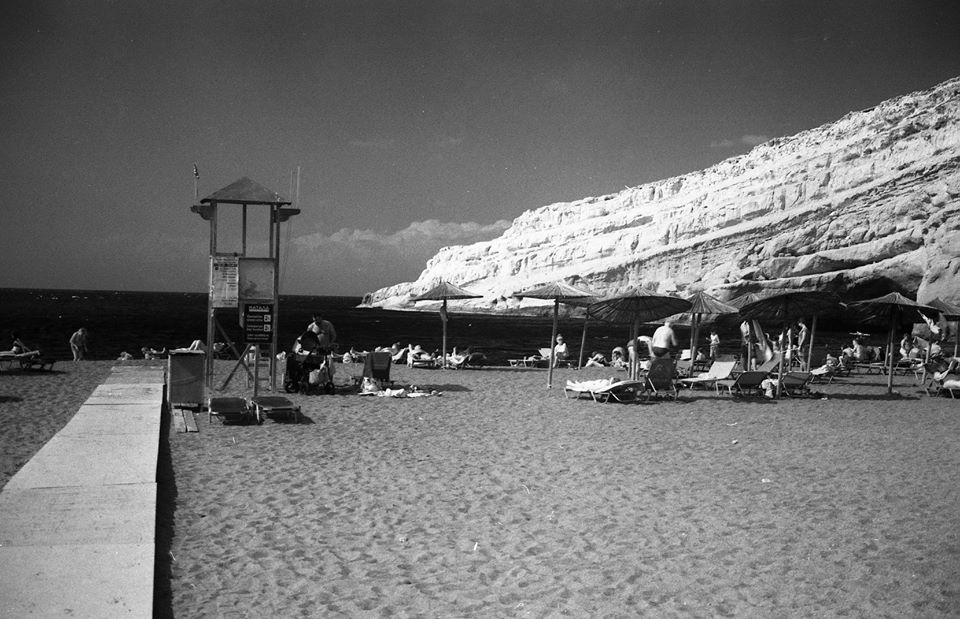

Here are a few of mine....Crete with the Yashica and Malta with the Praktica. Focusing is easier with the Yashica as the rangefinder works with the filter in place of course. With an SLR you must either pre-focus or guess...and apertures are usually quite wide due to the low EI. Both with cheap Chinese 720 filters bought for under a tenner including postage from China via that famous auction site. As far as I can tell the film and filters do a good job, though I'm really just experimenting with this.
