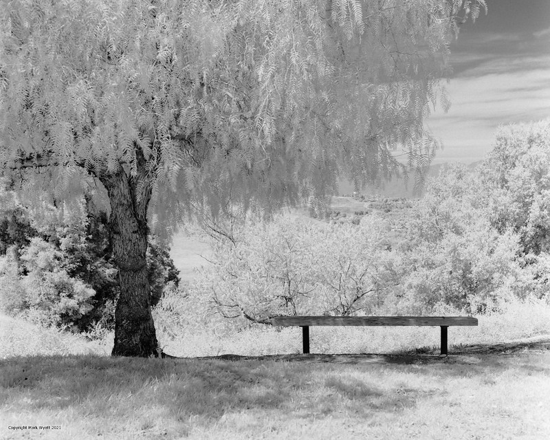

Some recent results with Rollei IR 400 (same Mamiya C330f; 80mm f2.8), 720nm filter. This time using an equivalent ISO 12. I lose less highlights.
bench, surreal
by Mark Wyatt, on Flickr

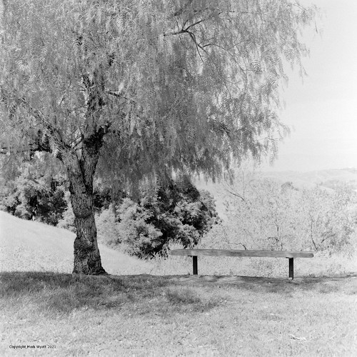

The same scene with no IR filter (and overexposed, i.e., "oops")
bench

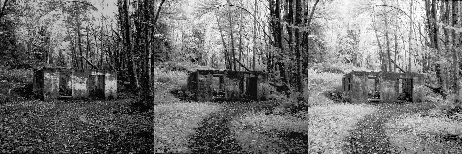

Ilford SFX.
Three different exposures of the same scene - one without a filter and metered at 200, one with an R72 filter and exposed at six (6) stops more than the unfiltered one and another with an R72 filter and exposed at nine (9) stops more than the unfiltered one - all to show variations of how much Wood Effect is available:
Excellent example. A picture tells more than words. Thanks for this!
