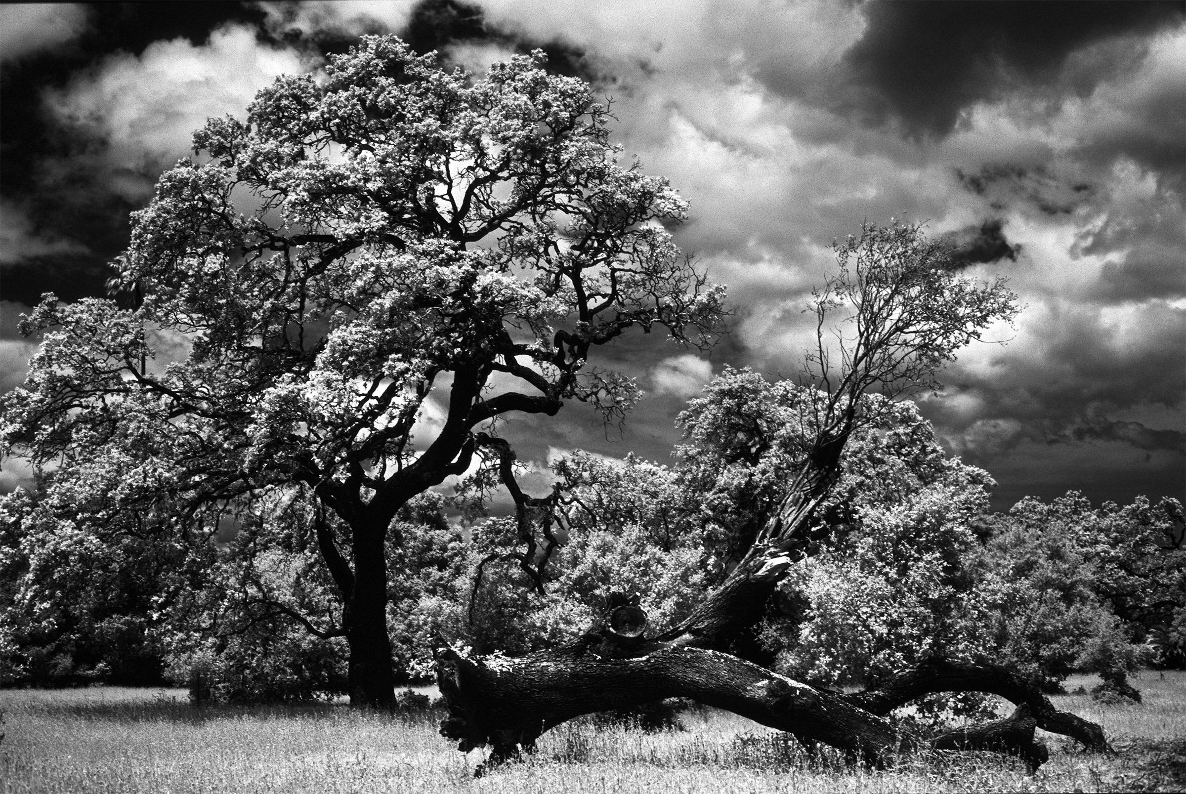

Lake Cooroibah on Rollei Infrared, #9
Gelatin-silver photograph on Ilford Classic VC FB photographic paper, image size 16.3cm X 16.3cm,
from a Rollei Infrared negative exposed at EI = 10 in a Seagull 4A-103A twin lens reflex camera fitted with a IR720 filter.
In the near infrared there is a useful correlation between visible light meter readings and how things will be rendered on infrared film. Some things come out the same and other things come out very different.
In the above example tree bark comes out as metered as does the white sand in the foreground. The white cloud measured in visible light and placed on Zone VIII falls on Zone VIII in the infrared.
On the other hand the water and sky come out darker and the clump of green grass in the corner is much lighter. Metering these objects will deliver misleading values.
Other things that are useful to meter are rocks, bare dirt, dead yellow grass, paved roads, weathered wood. These deliver a good "ballpark" exposure guide.
But the infrared remains wild and delivers surprises, mostly good.

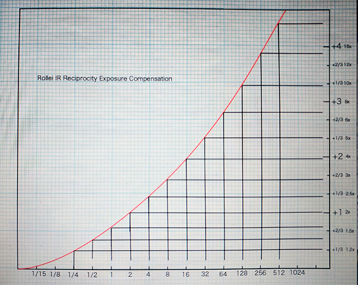

I just remembered that I have a file on my phone with certain photo data that I use when I'm out in the field...
Here's the reciprocity data that I have been using for several years... Metred exposure time is on the X-axis, compensation on the Y...
1+1+100 dilution: 15 minutes 21C (I use continuous rotary in BTZS tubes, and it's no fun standing there twirling tubes in a tray for that long 😄) so I standardised on a 1+1+50 dilution. 7:30 at 21C. You will probably have to increase my times a bit if you are using intermittent agitation regimes. I do use the weaker dilution for when N minus development is required. I hope this helps!

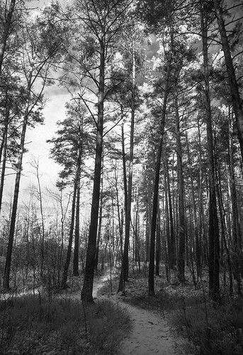

I would very much like to see samples of photos made on HR-50 with the Heliopan RG 715
Have some examples, developed as slides. More to come.

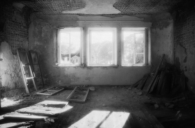

Has anyone experimented with water washing film pre-exposure, to increase speed and IR extension?
Or even using a high dilution of silver nitrate?
I have done prewash to remove antihalation layers to make them render things closer to HIE. Am planning to do so with Retro 80S and Superpan 200. Didn't notice "extended" IR performance, here are some examples:

I put the film on a Paterson reel. Wash with cold demineralized water for thirty seconds, with constant agitation. Then wash with alchol to speed up drying.
Then dry with a hairdryer on cold. Re-roll the film and shoot it.
Medium format it’s real tricky to re-roll, but it can be done with a guide rig.
Potentially you can paint the backing paper. Use retro reflective paint, white or even silver.
This will further aid the halation and speed the film up.
