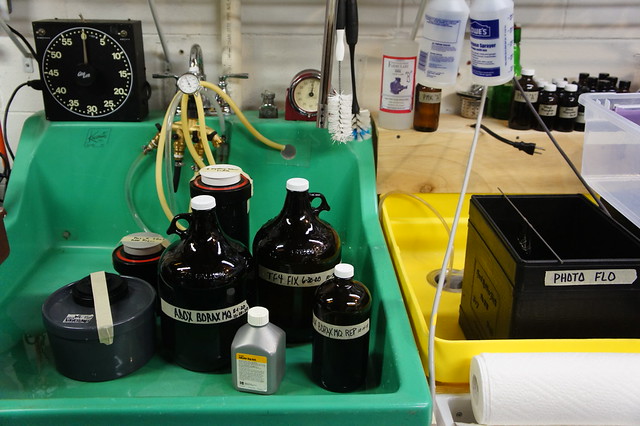

60 6x6 cm exposures on one roll. 70mm Kodak Surveillance film about shot at about EI 250. ADOX BORAX MQ 11 1/2 mins 21C. Kindermann 70mm tank and reel WOW it's heavy. SSSLLLOOOWWW to fill and dump, you have to tilt the tank at a 45 to fill it or it just blows all over. And balance a one gallon brown glass bottle at the same time. Not fun!

70mm Kindermann dev tank filled with Kodak Surveillance film up to 70 exposures now ready to develop. Single Paterson 70mm reel hacked by me to fit) fully loaded with 24 exposures Kodak Aerial Recon Film (this is the razor thin stuff comes in 500 foot roll). Tall Paterson System 4 (hacked by me) holds two 70mm 24 exposure length rolls, plus a roll of 35mm Eastman XX movie film.
This Kindermann tank is a chemistry hog (requires nearly a full gallon) and is -very- slow to fill and dump. Allow at least a minute for filling and draining. Also weighs a ton when full. A unique tool.

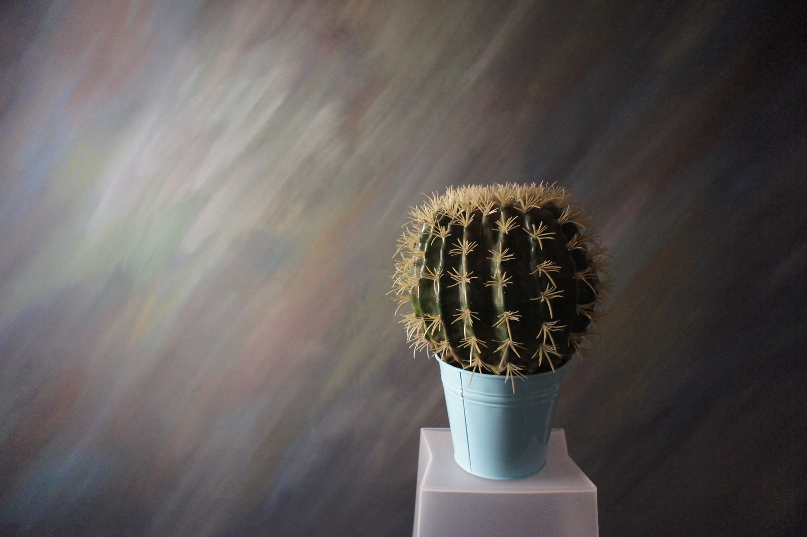

Another digital test shot, building up Tim Kelly lighting in my smaller portrait space. Here I have exchanged the 60x60 Broncolor Pulsoflex Softbox, with the biggie globular Broncolor Balloon head, on a 300 ws Broncolor Impact Monolight. Light measured with Broncolor FM2 digital strobe metered measures F16 at Ei 100.
The idea with this light is an overall soft directional fill, lighting as much background as possible. In these close quarters the Balloon head is definately the way to go, I can't imagine a softer light source with this one. Of course it falls off from side to side, just like windowlight but artifical. A good upgrade from using a small soft box, it didn't light enough of the set for my uses.
This is my other cool James Bright canvas painted 9x12 foot background. I'll be changing up my background setup soon but it's going to be a bit of carpentry involved but well worth it
I'll be adding more lights to build this set up further
