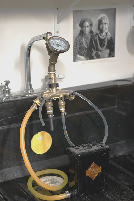

Testing this Combiplan Film Washer, it works great! After fixing into this modded tank it goes. Surgical tubing three feet ID half-inch, fits the screw-in plastic Combiplan insert. Gently tightened hose clamp tight seal, no leaks. Final embellishment will be to add Inline Filter, set of three plus six extra filters, $30 on Amazon. On it's way to me. This will wash any of the Combiplan Rack Configuration, Imperial size or Metric size. Most excellent film washer.

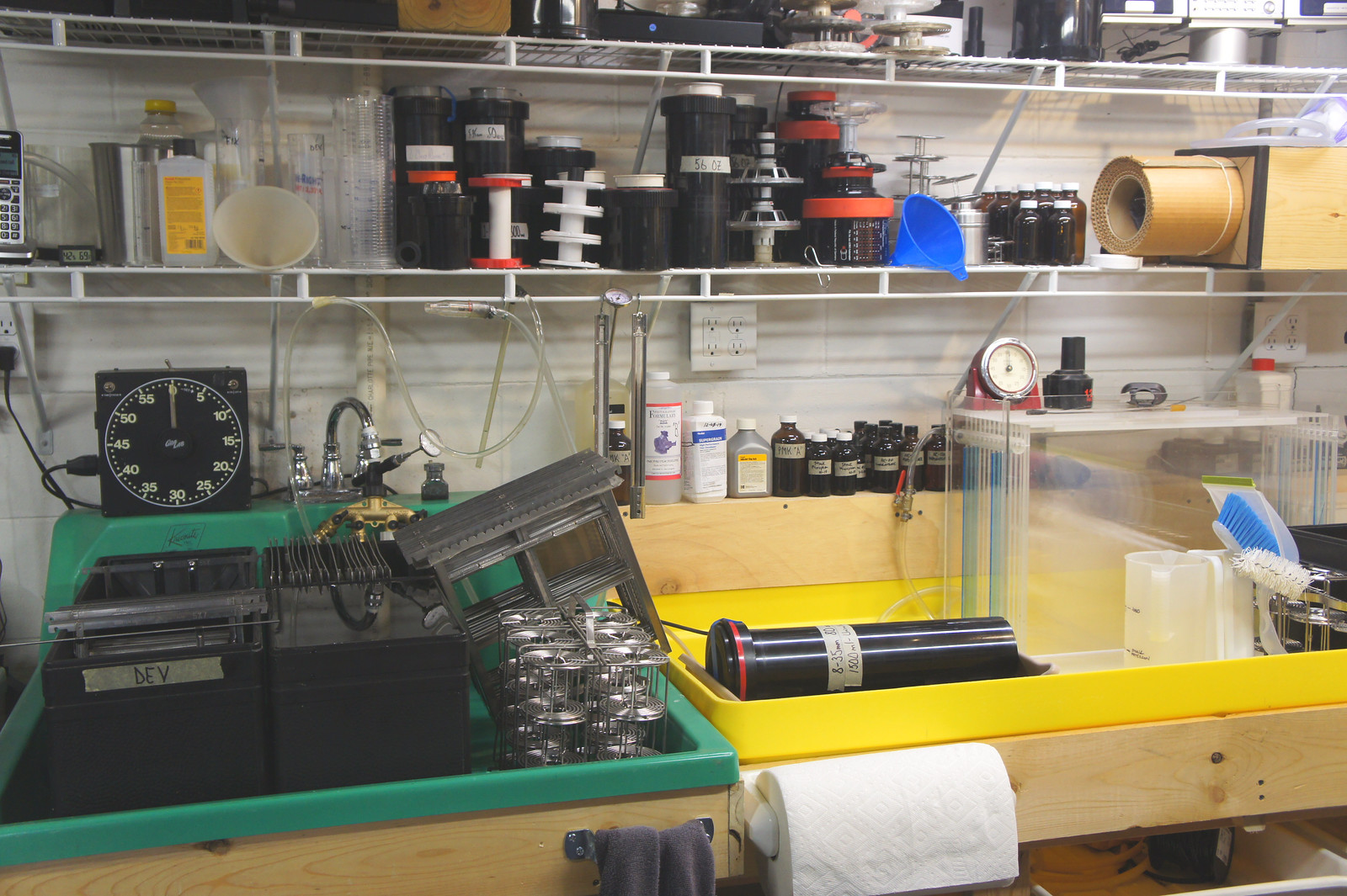

I'm renovating my home basement darkroom. Up until now, I used this space for general storage, film loading, and long ago, color enlarging. I still have a 16" Kreonite CPT16 EP2 Color processor hooked up, but I'm getting rid of that. Want to set this up for B&W darkroom work. Washing and water in another room right now.
Been buying shelving, floor mats, and a LOT of cleaning and organizing. Mind the clutter, it's not done yet. Just wanted to show you guys my progress. What do you think so far?

avoid fluorescent lights if you can. They have an afterglow when turned off

Another view of some of my film processing stuff. Also room to grow in terms of storage.
I solved storage in my darkroom with inexpensive kitchen furniture. That's ideal; it gives you a work surface and storage space simultaneously.
