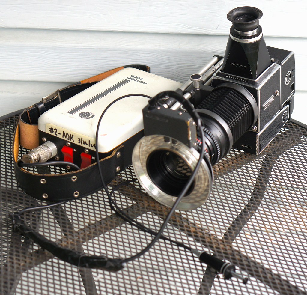

Hasselblad EL/M with CFV16 Digital Back, 135mm C T* Zeiss S-Planar (1:1 to infinity focus with Hasselblad Auto Bellows). Hasselblad Stovepipe, Hasselblad Ring Light, modified by New York City Flash Clinic, to work nice with the Norman 200B 200J Packs. Working good all, will be used for some digital floral photography coming up soon. Actually not too heavy to carry around.
If I can find the right Firewire Cord, I believe I can tether this back to a Windows Laptop.

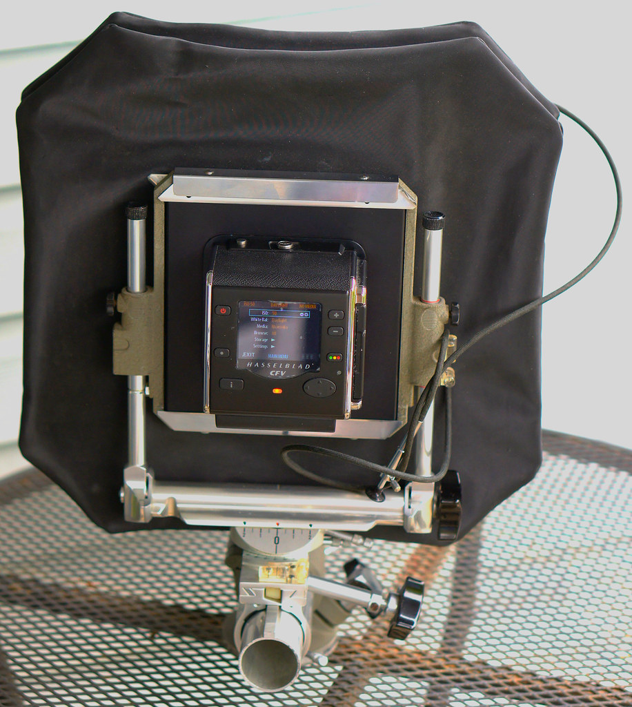

Here's the Hasselblad CFV16 Digital Back on the Main Menu Screen, on my 4x5 Sinar Norma. Capture One Sinar Adapter does the job at low cost. Battery Pack clips on to the bottom of the Digital Back. Need the connecting cord to the PC Socket on a shutter. My Norma Shutters would play nice with this and will be an upgrade. Easy to see the shutter controls from behind the camera. FAST. Image through the 47mm Super Angulon is super sharp and contrasty GG image. At F8 it is kind of amazing looking, being so wide. The precision lateral slide on the Norma Rear Standard means I can shoot multiple images and stitch 'em together. Would make quite a file.

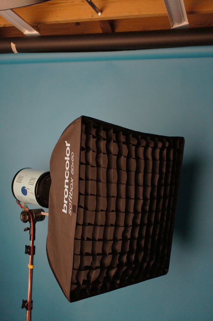

Here I've adapted my fave Broncolor C71 Monolight, to fit the modern Pulso 60x60 Softbox. I grew up with square softboxes, I wanted two of these boxes. Adorama had these for $110 each, a whopping discount. So I bought two of these 60x60. Then I went onto Broncolor.USA website, and direct ordered a 60x60 Supplemental Diffuser, and a 60x60 Grid. Actually these were much cheaper than the ones for the Octoboxes! And they had them in stock, they are out of about everything I'm looking for. So I wait. Notice the beautiful shadow background, that is due to the Octobox 150 with Supplemental Diffuser, which I leave set up all the time. Been moving overhead backgrounds around, seamless paper rolls now moved up front of set. Much better but not a fun job to move around. Another James Bright matching set of backgrounds is coming my way for a good price. Special plan for that set.

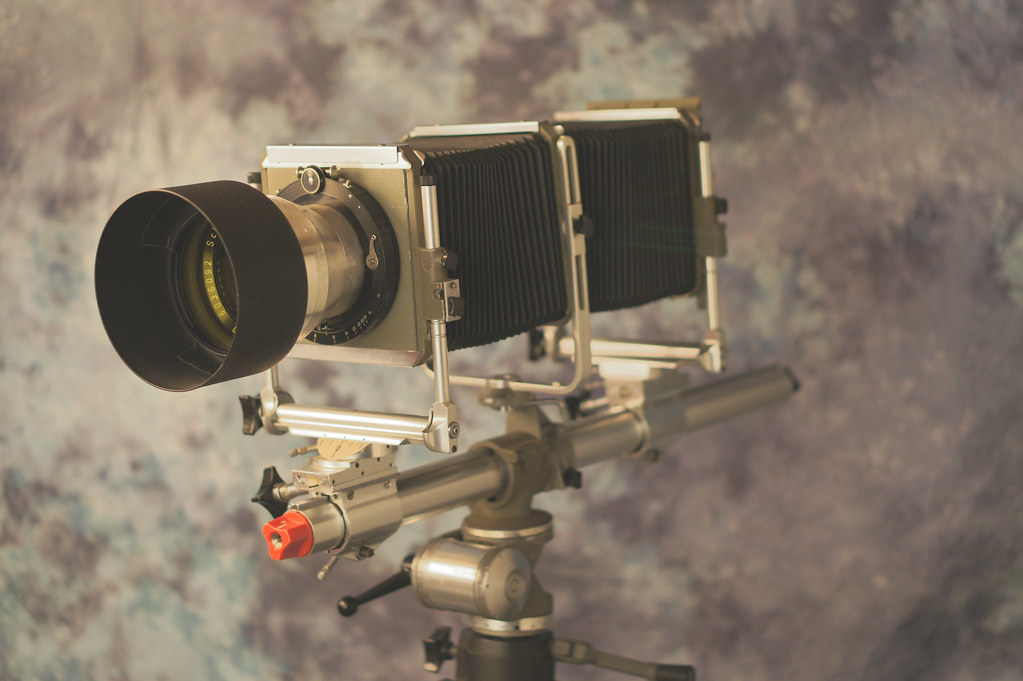

500mm Tele-Xenar 4x5 Norma Two Bellows Auxiliary Standard by Nokton48, on Flickr
This gives same perspective as 1000mm on 8x10, but is more portable, the Telephoto Formula means less bellows extension. For close-ups requires two bellows, but rig is not too heavy to carry to set up in the field. The 360mm Tele-Xenar is a favorite of mine for 9x9cm, looking forward to using this with Graflex Grafmatic Backs loaded with HP5+.
