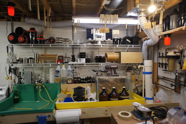

Darkroom Renovation Phase 2 No 8 by Nokton48, on Flickr
Phase II construction now complete! Two new sinks and plenty of new storage space. Just moving everything around and loving it. Plenty of room for future storage.
Darkroom Renovation Phase 2 No 10 by Nokton48, on Flickr
Two new big changes; Ventilation above trays now hooked up (added a new 1500 CFM ceiling fan to pull odors), and in the sink, I am setting up a Kodak 8x10 3 1/2 gallon hard rubber 3F basket line. A deep tank for developer, one for stop, one for fixer, and a Kodak 8x10 3F Wash tank. Want to install additional bracing directly under all four tanks (not filled yet).
On the right side of the sink, is my setup for 8x10 RC paper developing and washing. Hang everything on clothespins in the other room.

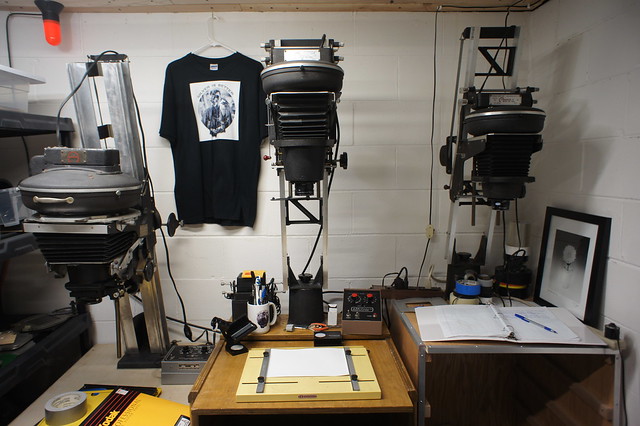

Darkroom Renovation Phase 2 No 6 by Nokton48, on Flickr
Also my Contractor built this Omega Automega E3 5x7 Enlarging table to my design and specs. This is similar to the Omega E3/E4 tables that I have seen in the internet. I am pleased, also note the storage underneath

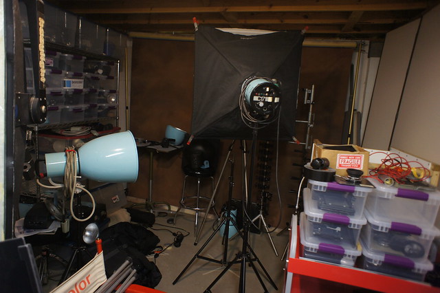

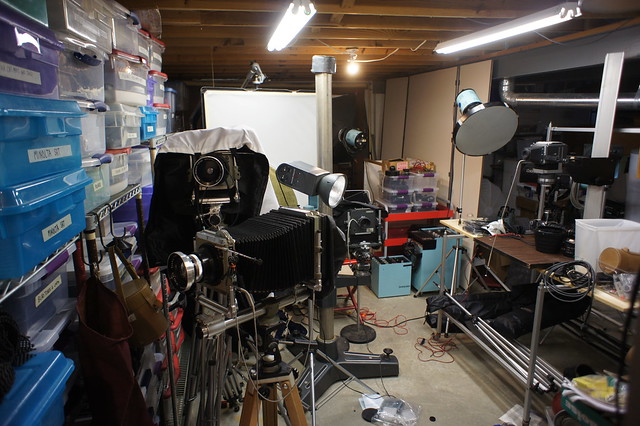

Next Big Project. Studio Reorganization and eventual renovation.
Studio Renovation 1 by Nokton48, on Flickr
I've been cleaning and organizing things. Lots of progress but a ways to go. Just bought a 1500ws Broncolor Strobe Pack, and another Plaubel Peco Profia 4x5 technical camera.
On the FOBA DIMIL Sweep Table, I have set up a copy stand, using one of my Plaubel Makiflexes, which are vibration-free cameras perfect with SLR reflex viewing.
Studio Renovation 2 by Nokton48, on Flickr
Full size background and storage of lighting
Studio Renovation 3 by Nokton48, on Flickr
FOBA Mini Tripod and light stands made from Combitubes, and FOBA Clamps and Acessories. This works on the DIMIL Sweep Table.
Studio Renovation 4 by Nokton48, on Flickr
Here's my lighting stuff now neatly stored away, and I can now find what I need quickly! :smile:

New Backgrounds in Studio 1 by Nokton48, on Flickr
I've picked up a nice seamless paper background system from B&H, which uses three plastic chains to raise and lower the paper at will. Very cool good working system. So far I have black, super white, and blue jay colored paper. Rolls right down, neatly and super quick rolls back up out of the way
I also hung up two painted James Bright canvas backgrounds, which are quite cool. And I have two more narrow hand painted backgrounds out in front, fairly easy to raise and lower.
This is a work in progress but I am getting where I want to be with this. I do have more parts coming from B&H.
Every studio needs a good background system.
