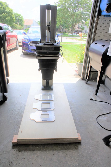

New Omega E3 5x7 Autofocus Enlarger by Nokton48, on Flickr
My new Omega 5x7 E3 Autofocus Enlarger arrived yesterday in three heavy boxes. These are the main pieces in my garage.
IT'S a BEAST.
It looks pretty good for being 70 years old! Having restored three 4x5 DII's I am ready for this. I am building a baseboard by gluing two pieces of 3/4" MTF. Lots of dirt and corrosion but I know how to deal with that. I will build a short 2x4 table to make a little bigger than 16x20s.
I also got a 4x5 condenser DII head with E3 Adapter, a homemade LED 5x7 E3 head (VERY COOL!), three E3 negative carriers, 5x7, 4x5 and 3x4. And two E3 lens cones and three E3 lenses. The two lens goodies are: The 190mm Wollensack, and the 135mm Wollensack. The enlarger came with both of those cams, the 190mm is serial number matched to the focusing cam on the enlarger column.
So, away I go into 5x7! :smile: I also do 8x10 but those are contact printed.
E3 Baseboard Bottom Side Finished by Nokton48, on Flickr
Here the E3 Baseboard is finished. This is the bottom side, I was going to also use wood glue, but really I don't think it's going to come apart. Has over a hundred countersunk 1.25" construction screws holding it together. So this is now a 1 1/2" thick MTF baseboard.
This should support the heavy E3 5x7 Enlarger with no problems, I would think.
Now I will start to put the enlarger together, and see how everything fits together.
