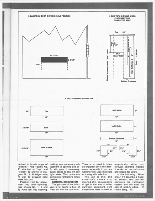

It was published in a Petersons Photographic Book back in the 1970s, entitled "Blueprint Series Vol II". I bought the book for a few dollars on Amazon. The book has 38 how-to projects. The film drying cabinet and enlarging drop table projects are also in this one.
