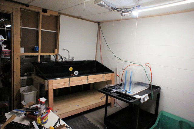

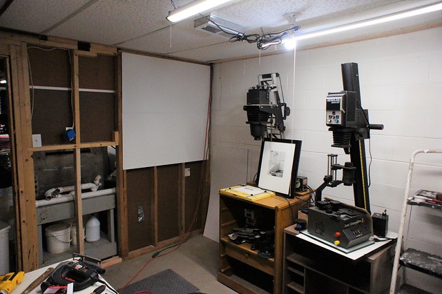

Here you can see I am starting to put up laminated paneling to finish the inside wall space. This is where we will be doing plumbing and electricals, and this is where the sink and Kreonite Water Thermostat/Water Board will go. The six foot sink will also be mounted here, with the 4x4 Kreonite sink just along this side of the concrete wall. Building the base for the sink shouldn't take long.
Big Stuff moved in darkroom by Nokton48, on Flickr

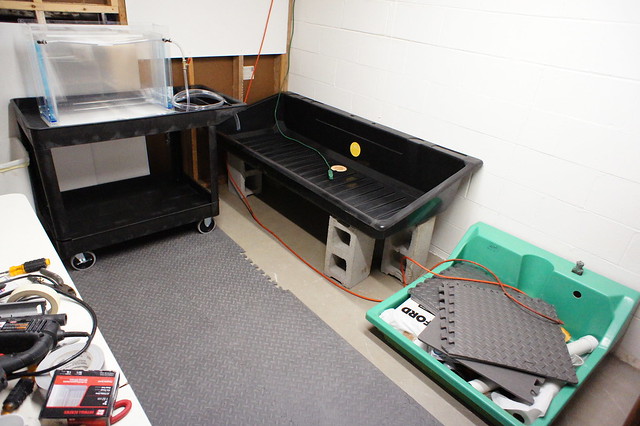

Here I've moved in the big stuff, to get a sense of best gear placement, and to see how it fills up the space. The darkroom is only 10x12 feet so it is now filled up, but not badly so, perfect for one worker (me!)
This will be cool when everything is buttoned up.
Can you put the cart between the sinks?
Hi Matt.
Yes That has also been tried, I'm not sure which will work best for me, but that's a very good possibility :smile:

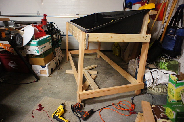

Darkroom Sink Base 1 by Nokton48, on Flickr
Darkroom Sink Base 2 by Nokton48, on Flickr

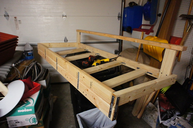

I worked hard all day yesterday and just finished this darkroom sink base. It was not so easy to create, but this one fits my Delta 6 foot Sink II like a glove. And solid as solid can be. Now I will calculate how long to make the legs, so it sits perfectly. I will also install leveling feet on each leg. And a storage shelf under the sink.
This whole sink new at B&H is $1350 plus freight. I'd estimate I have about $150 total for everything for this part of the project.
darkroom stand nearly done 2 by Nokton48, on Flickr
darkroom sink stand nearly done 1 by Nokton48, on Flickr

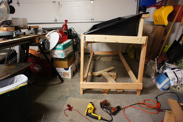

After puzzling around for a bit I figured out how to put legs on the sink frame. It's totally solid. I'll cut plywood for the lower shelf, and I might put in a second shelf. And add super heavy duty leveling feet under the legs. Have to take the legs off to get it into the darkroom, then re-assemble it. Almost done! :smile:
When this one is done I'll start on renovating the Kreonite plate washing sink.

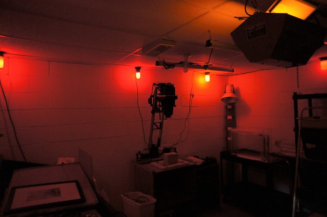

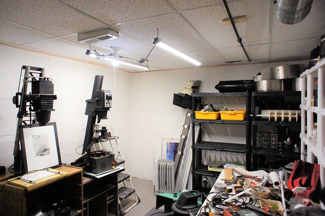

Setting up lights and other devices today, now it looks like a darkroom. Will start using it this weekend, I am hoping.
Phase II will be bringing in electrician and plumber. I want to use it for a while in case I want or need to make changes (which I will). Will be dusting and cleaning for the next few days, and putting away tools and extra materials.
I am getting a second Omega 4x5 DII enlarger, and I'm in the process of building a second homemade enlarger drop table. One enlarger will have the "Omegalite" saucer-like B&W enlarging head (for smaller print making). I love printing with the Omegalite, it's my old friend. The second DII will have the brand new Modern Enlarging Systems Model II head, which is a modern LED enlarging head. Equivilent to 150W this will be great for printing 16x20s with shorter exposure times. Having two identical enlargers side by side will be pure luxury for me

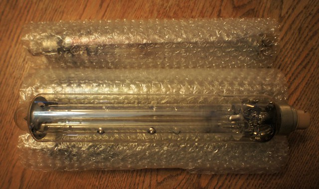

Thomas Safelight Restored by Nokton48, on Flickr
Dismally dark, until I took it apart and thoroughly cleaned it inside and out. Cut new filters and replaced any that had faded. There was dust and humidity marks inside the filters. Now fresh and pristine.
I can read small print on a label, standing all the way across the room,. I love this new safelight! :smile:
Now I am pleased. THIS is more like it!

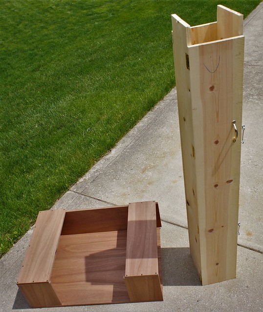

Today I put this second Omega DII Drop Table together. I think it came out rather well, I used the plans right of an old Peterson's Photographic book about making photo equipment. I used an expensive sheet of oak plywood wood (might as well!), and some oak strips, from the local pro woodworking store, and they even cut the pieces for me in the store. All I had to do was put it together.
A few more embellishments and it's ready to use. And some good quality heavy locking casters as well.

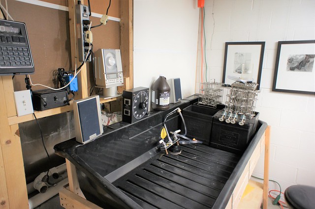

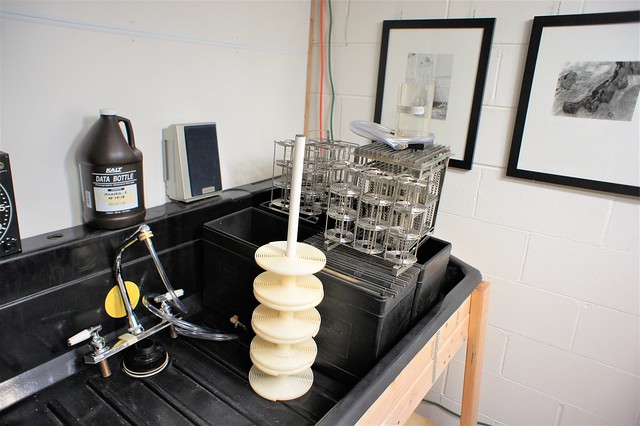

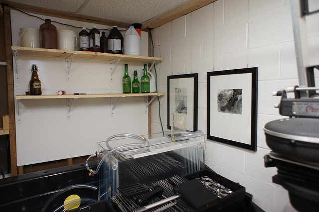

Darkroom Shelving Over Sink by Nokton48, on Flickr
Today I completely finished the "Matte Print Dryer" and the "Ten Minute Film Dryer" And I installed this shelving over the new sink. Another three foot section of stacked shelving will go just to the left of this. The Kreonite Waterboard will come in during phase II. Some of this will eventually change.
All of the bottles are empty but not for long :smile:
Sink Area Done! by Nokton48, on Flickr
Today I cut panels and trim finished them, then finished filling out the hole in the wall. All Good and light tight now. Then finished shelves and rearranged processing equipment and chemicals.
I'm ready to start using the darkroom :smile:
Is that a pancake cold light head on the Omega? Are you using it? With a Metrolux?
It's a 4x5 Omegalite D diffusion head. Has a circular florescent bulb inside. The timer is a vintage Time-o-lite. Has worked well for me in the past with graded paper. Great for smaller sizes.
My plan is to add a second Omega 4x5 DII column and base, with the Modern Enlarging Systems LED head I just acquired, For making larger prints, the LED has 150W output.

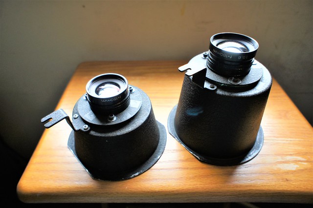

Today I worked on the Omega DII enlarger. First I carefully leveled the drop table using shims, then carefully leveled the carrier section of the enlarger. Then I went out to the shop and rebuilt these two DII lens mounts, adding three-point adjustments for absolutely parallel planes in regards to the enlarging axis planes. I drilled and tapped the cones, and added mouse pad and machine bolts for tight adjusting of the lens plane.
I will use my Laser -Align tool for the final calibrating. On the easel looking with my Omega Micro Focuser the grain is quite sharp at F5.6.
I love my 180mm f5.6 Rodagon for 4x5, I was produced many sharp 16x20s with it. I just bought this 150mm F5.6 Rodagon (identical lens in terms of age) a few days ago, for when I need more magnification of the image. Nice to have both!
