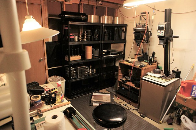

I'm renovating my home basement darkroom. Up until now, I used this space for general storage, film loading, and long ago, color enlarging. I still have a 16" Kreonite CPT16 EP2 Color processor hooked up, but I'm getting rid of that. Want to set this up for B&W darkroom work. Washing and water in another room right now.
Been buying shelving, floor mats, and a LOT of cleaning and organizing. Mind the clutter, it's not done yet. Just wanted to show you guys my progress. What do you think so far?

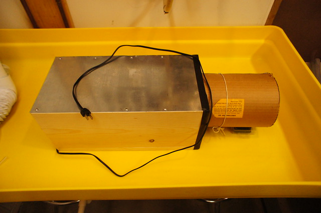

Yesterday I made this Kodak Blotter Roll Dryer, yet another Peterson's Photographic home darkroom project. I have some old fibre paper I want to start testing. This is a quick way to dry it. Right now the dryer has a 100W heating element, which is interchangeable. Also I want to add a switch and a timer for this unit. Adding some filter material is a good idea. Gentle dry heat is the result so far.

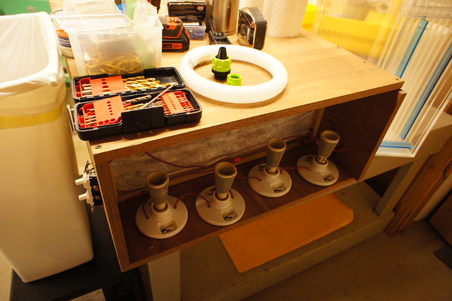

Three unfinished projects I have been working on here and there, as I have time. Two Omega Omegalite 4x5 heads (both trashed) combined into one perfectly working unit. First unit had a bad transformer, bought the second unit for parts. Attaching some adhesive foam rubber to the bottom, and it's finished :smile: Good as new and cheap!
