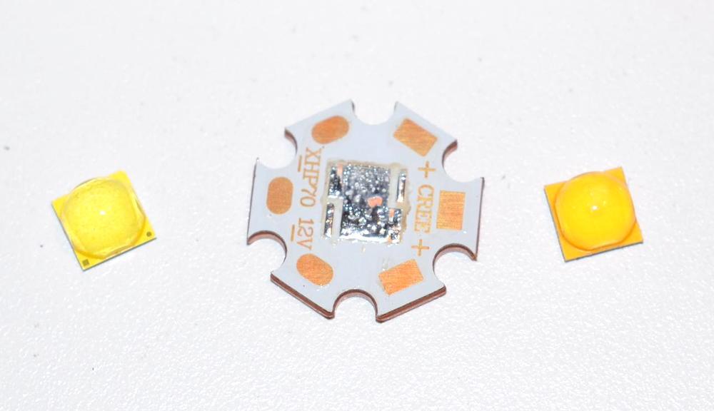

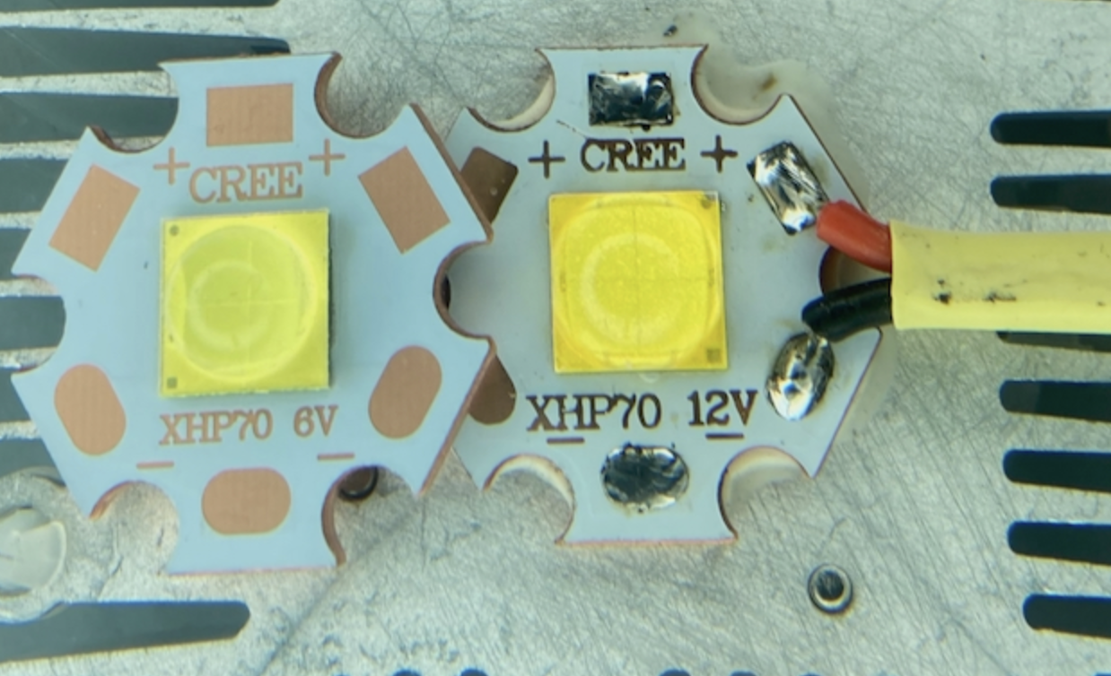

Also obtained a real Cree XHP70.2 for testing:

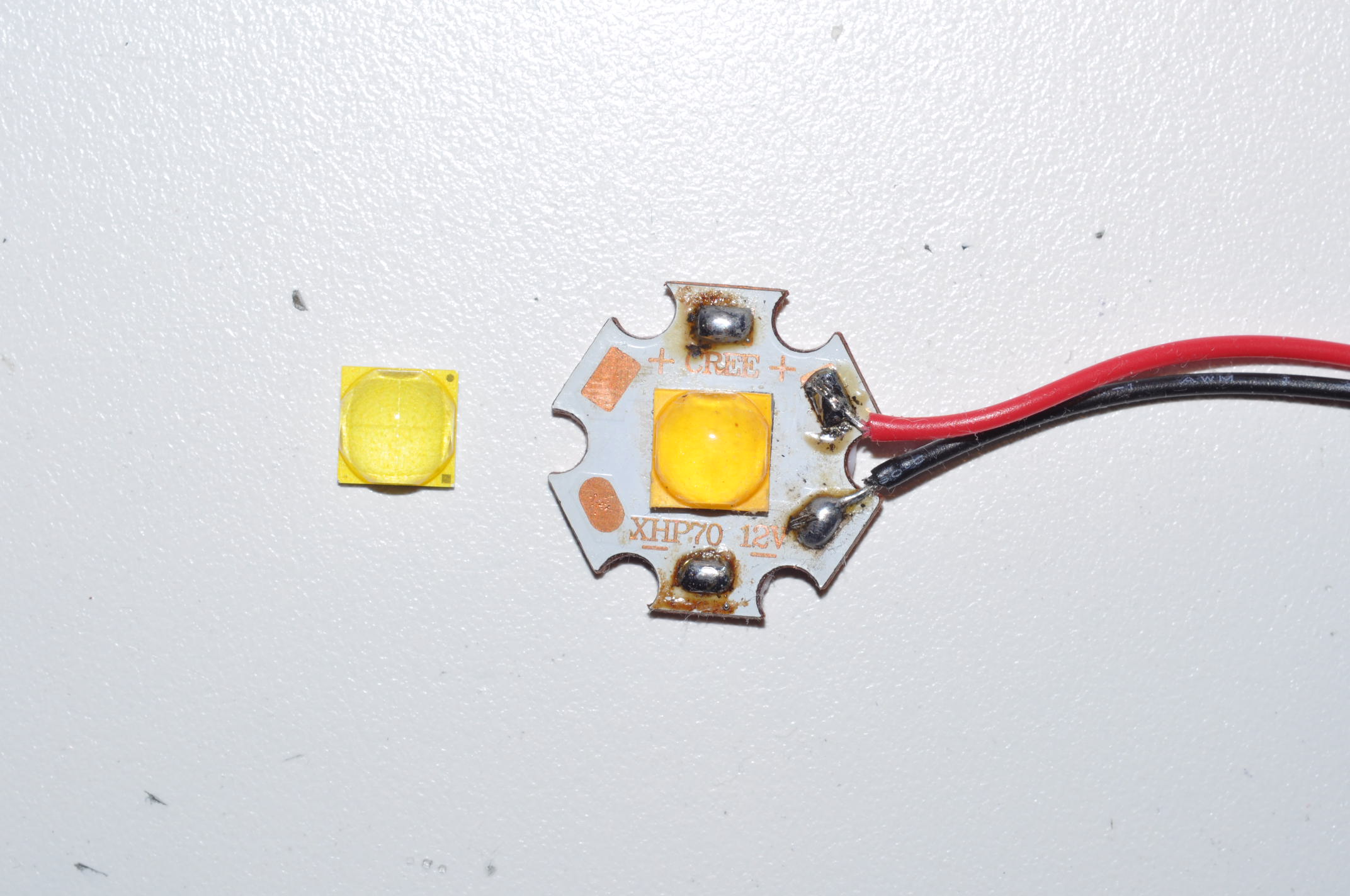

I got the real CREE XHP70.2 LED from Mouser electronics, but it does not come on a star.
My impression is that all the stars that read "CREE" are fake. I don't think Cree makes or sells those stars.
I took the fake LED off a star and put a real Cree XHP70.2 in its place.
Real Cree on the LEFT and fake on the RIGHT:

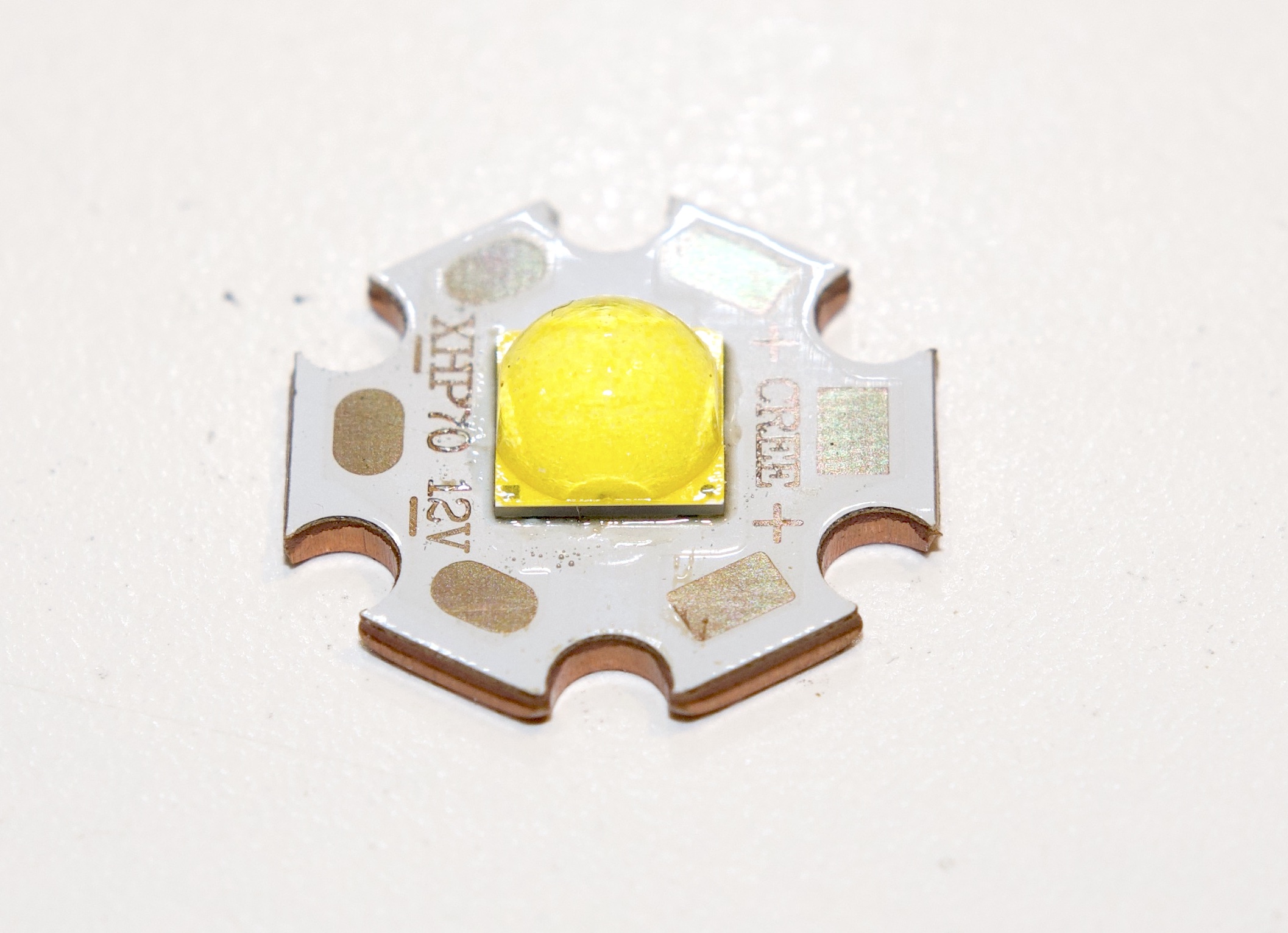

The creator of the projects indicates a fake Cree is needed (Epileds XHP7070.2), and indeed when I installed the real Cree, the EV values were slightly off. The high values with the real CreeXHP70.2 are too high by about 0.4EV and the low values are too low by about the same amount.
This is the image posted on GitHub, of two fakes with the correct one (Epileds XHP7070.2) on the right.
I have tried 3 different suppliers of Epileds XHP7070.2 LEDs, but have not received any that look like either of those:

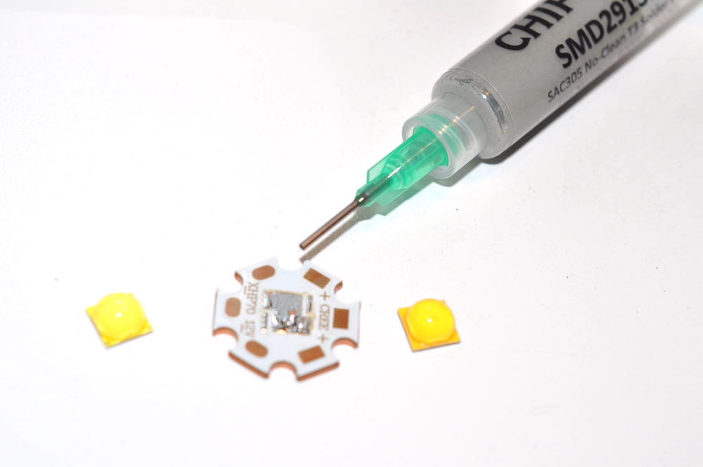

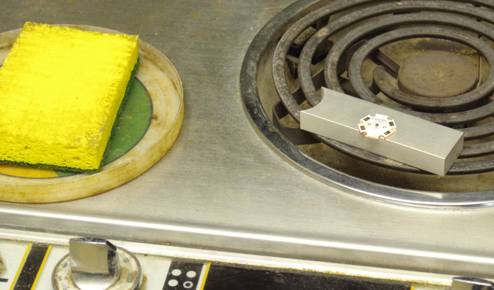

I don't have a hot plate, so I used a piece of scrap aluminum on the stove:
After the paste melted into solder, I'd rub the back of the star over the wet sponge to cool it. This approach works with stars, but I'd be reluctant to try it with a circuit board.

This is my experience so far:
LED #1: "Epileds" faulty on arrival, got refund (below)
LED #2 "Epileds" stopped working after about an hour (below):
LED #3 Real Cree XHP70.2 did not match the firmware settings. Too bright at EV16 and a little too dim at EV5 (below):
LED #4 Currently installed. Seems to be working OK but again, does not match the picture of the one from Github (below):
The reason for the concern over the "correct" LED is that color temp really matters. I have no idea the color temp of the recommended LED or the one I have.

Correct fake? The idea that you must find the correct fake would be amusing if it weren't evidence of all the dishonesty out there.
Nice. My wife won't let me in the kitchen to do stuff like that so I did mine on the gas BBQ out side.

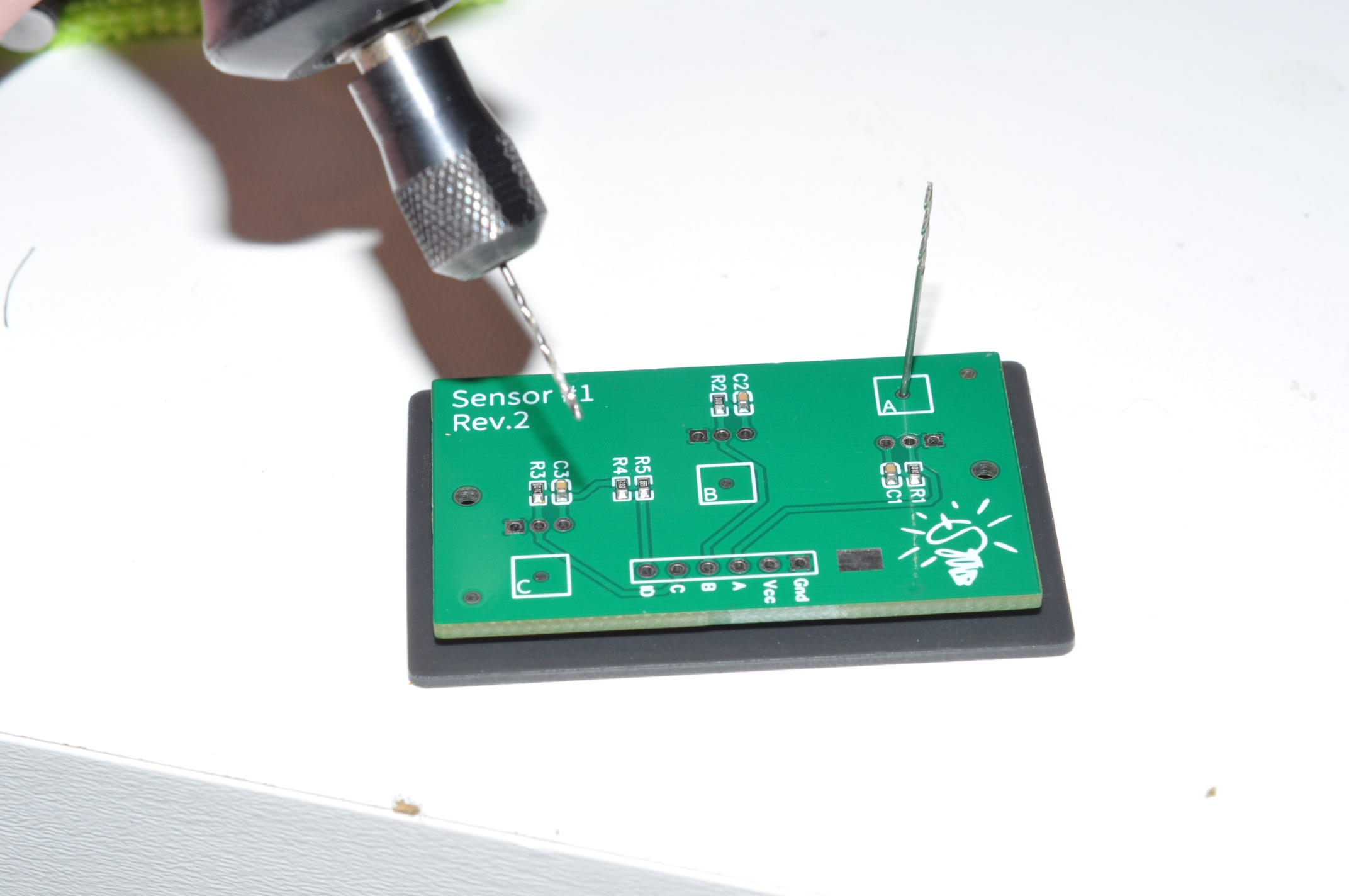

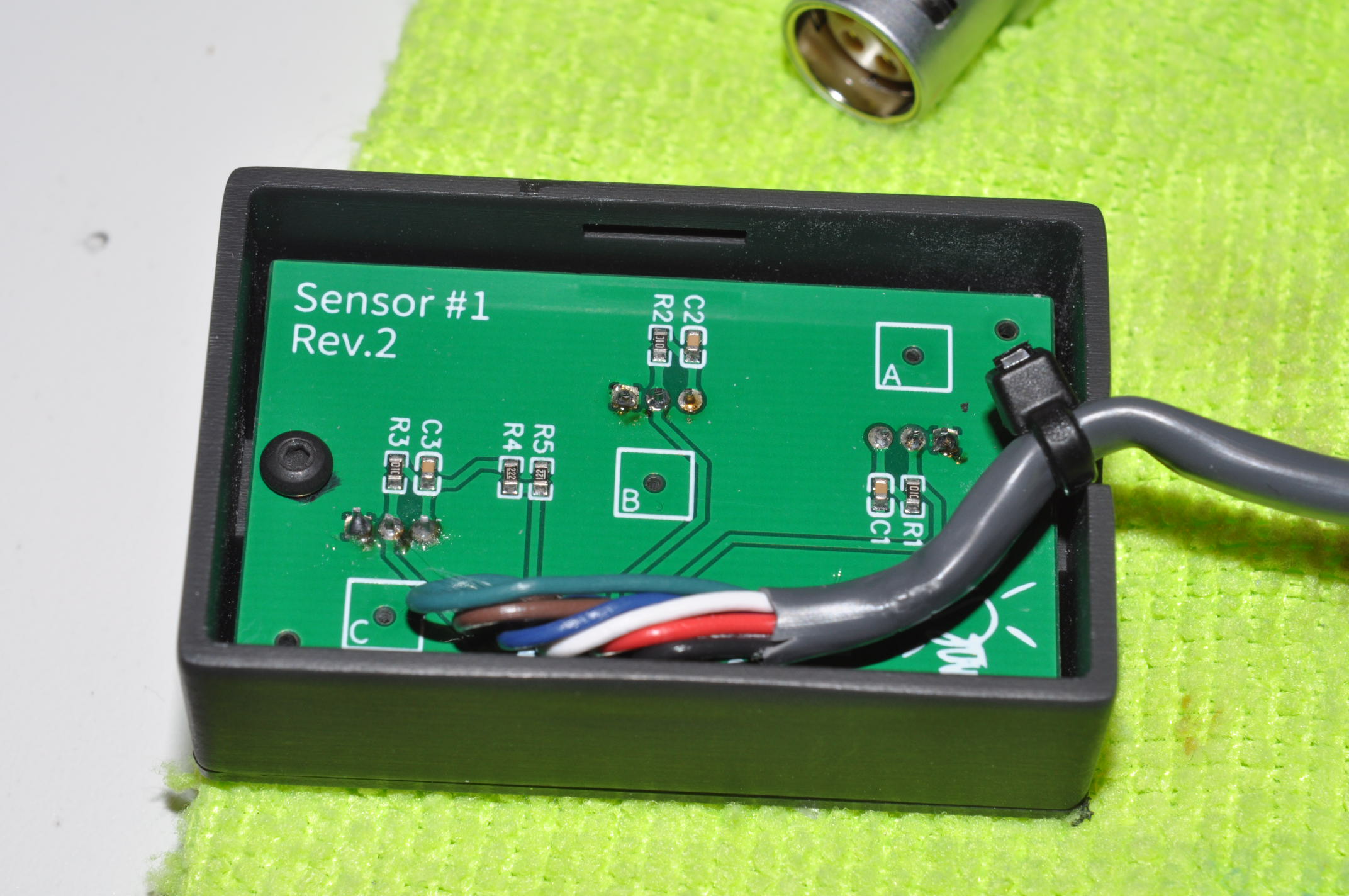

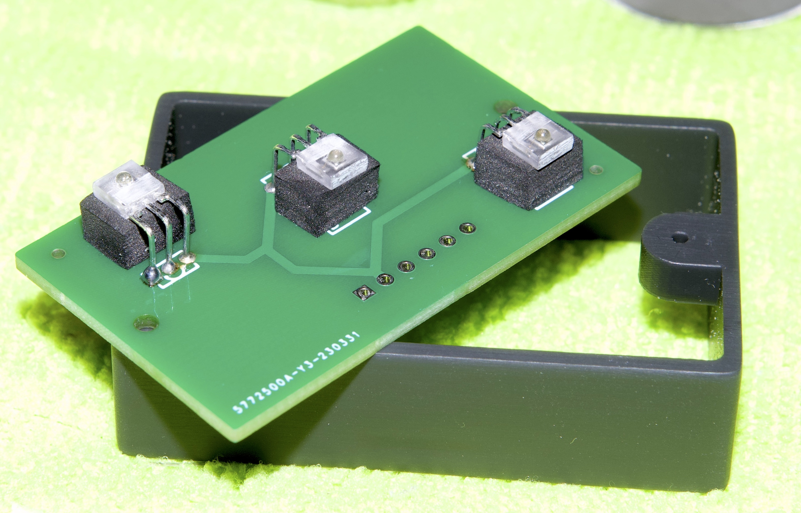

how did you locate the holes for sensor 1?
I did not show these because there is an error in my pictures. If you put the smooth side of the PC board on the front of the sensor plate (like my picture below), the holes will be on the wrong diagonal. You either have to turn the PC board over so the components lie against the face (and it is a little wobbly) or drill from back to front. Since I don't have a tiny drill press, I needed to drill from front to back to ensure the holes are the correct spacing. It is a given that without a drill press, the holes will not go straight through.
Yes, I only noticed my mistake after drilling the first 3, so I wound up with 5 holes, but no big deal for the extra holes. I can get a new piece made if needed.

You can see the holes in the wrong location here.
For gluing, I taped it, then glued the two center locations, and removed the tape before gluing the perimeter. So the glue would not seep under the tape and make a mess.

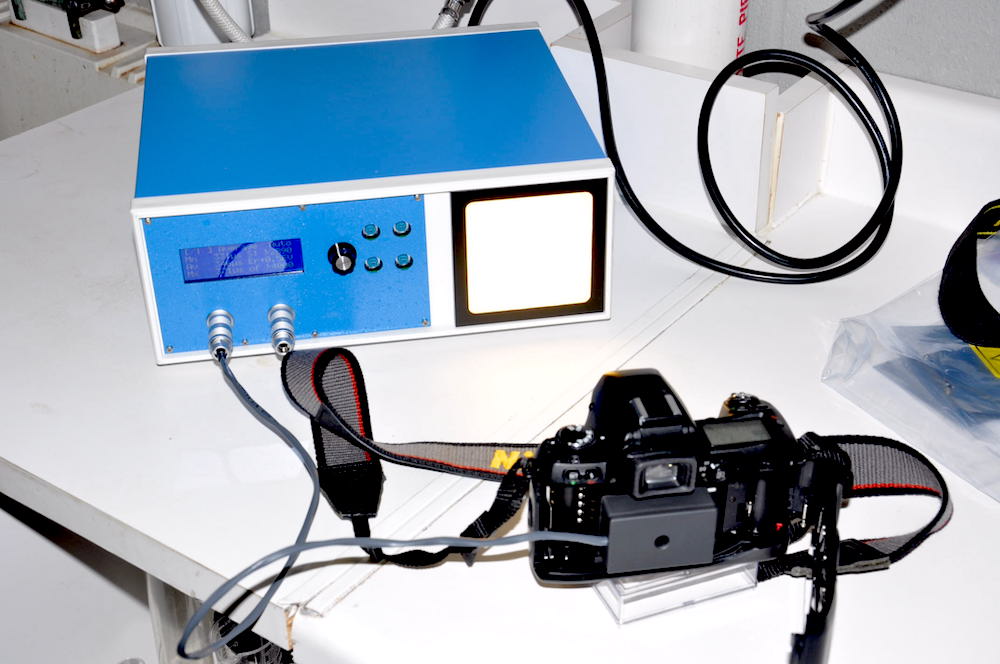

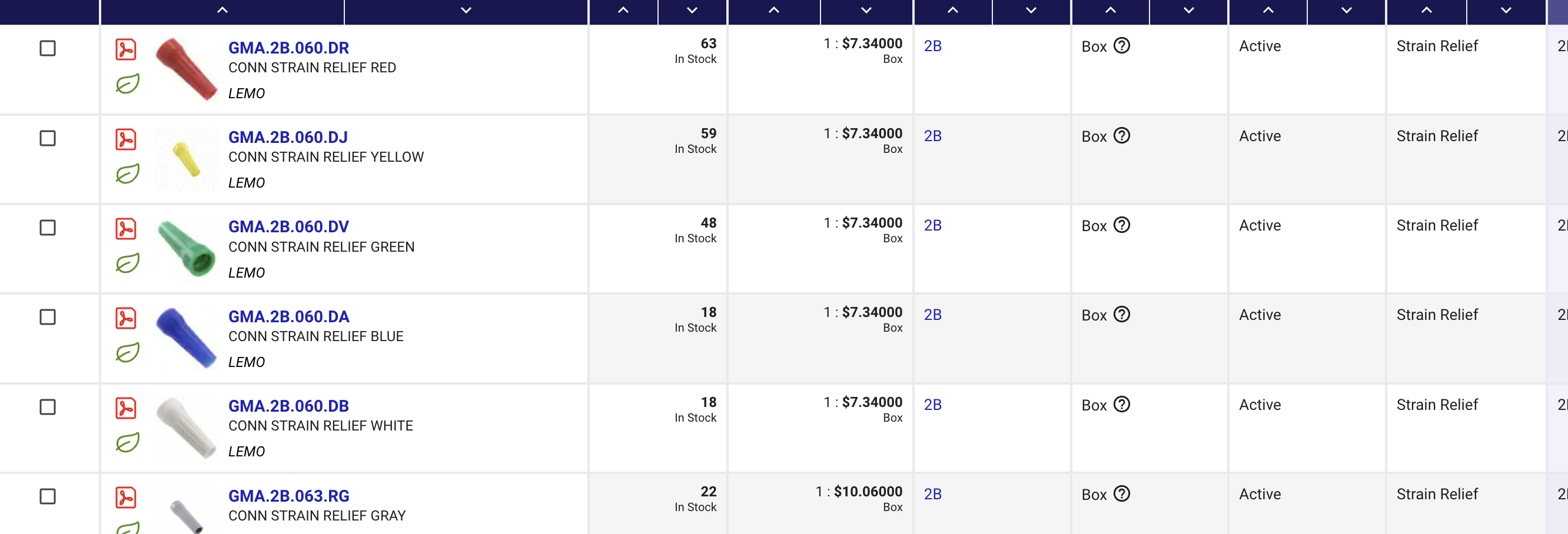

It is pretty much finished. Just waiting on my cable strain reliefs for the connectors and the buttons. Next is to make the "Sensor #3" for leaf shutters.

if you need switch covers for the switches I have those ...extras. Also if you need stuf 3d printed let me know. contact me @ rcksdty@gmail.com
I only ordered some black ones but they won't be here until the end of the month from China. Do you have some colorful ones?
