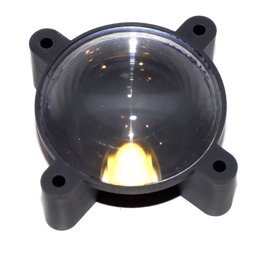

This is the LED you want for the build (warm white, 12volt 20mm diameter)

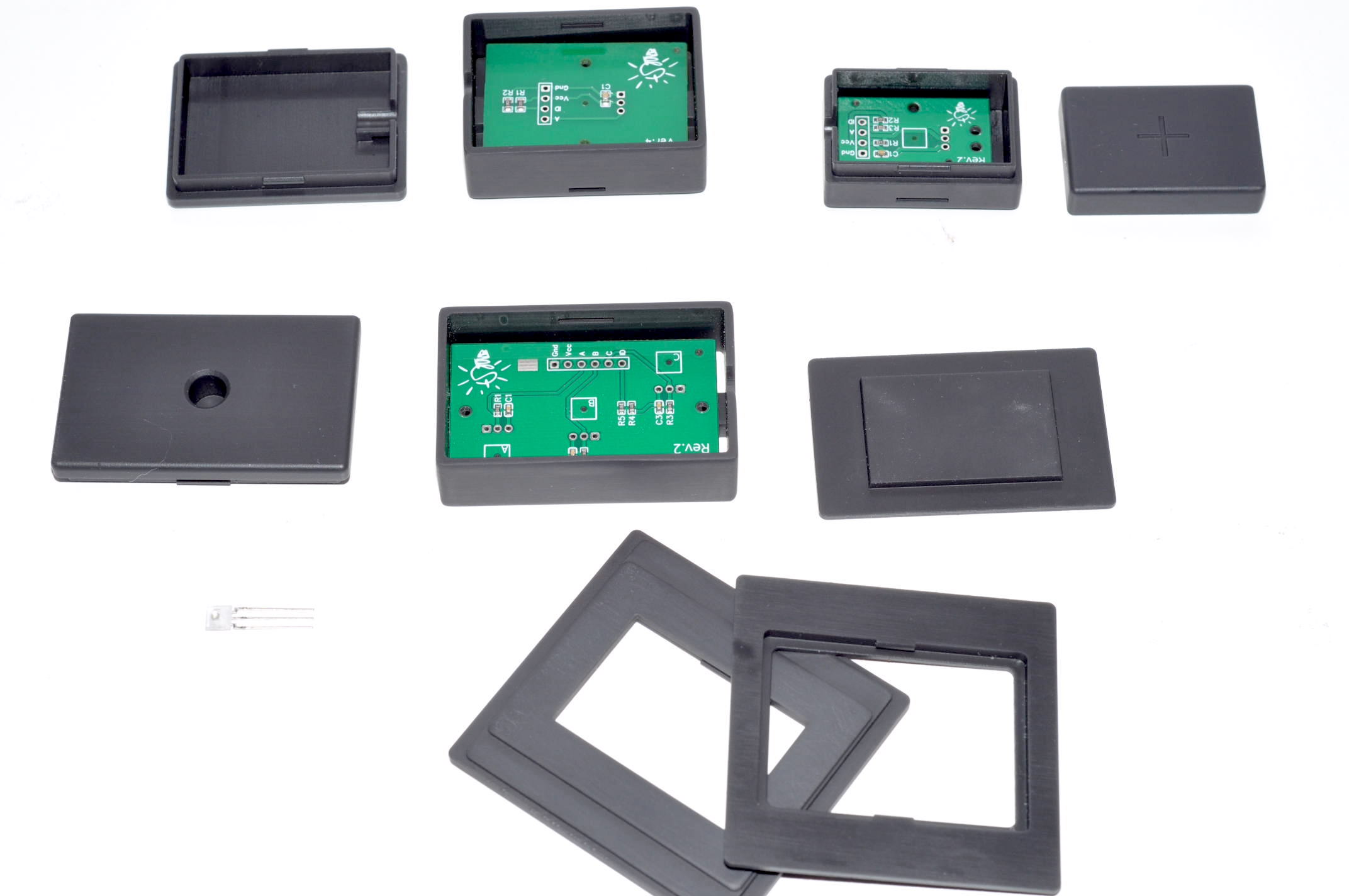

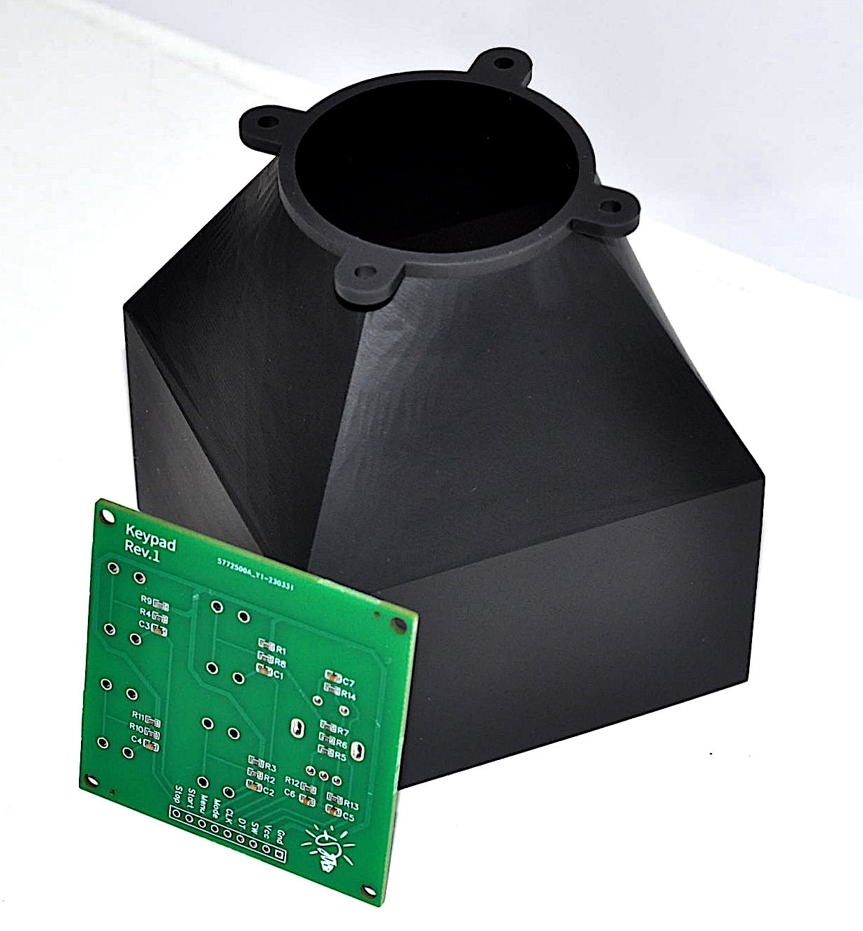

After a month of waiting, the first parts have arrived. I received the PC boards and the first of 18 3D printed parts.
