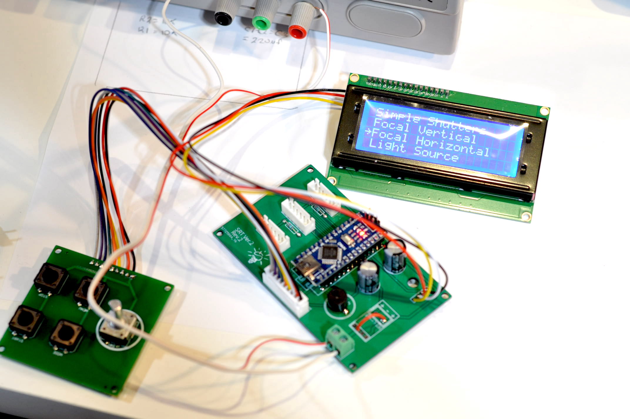

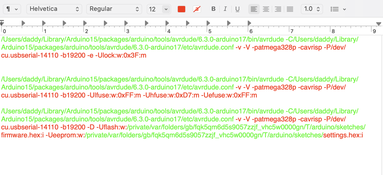

I got the Nano flashed with the software and started making the PC boards. Preliminary test shows all is OK.

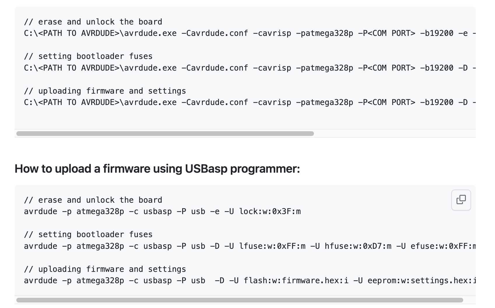

What was the issue in flashing the Nano using a Mac? I’m bound to encounter this at some point.
Over on the Github Wiki, the owner of the project (who is helpful) shows these commands, neither of which worked with my computer configuration:

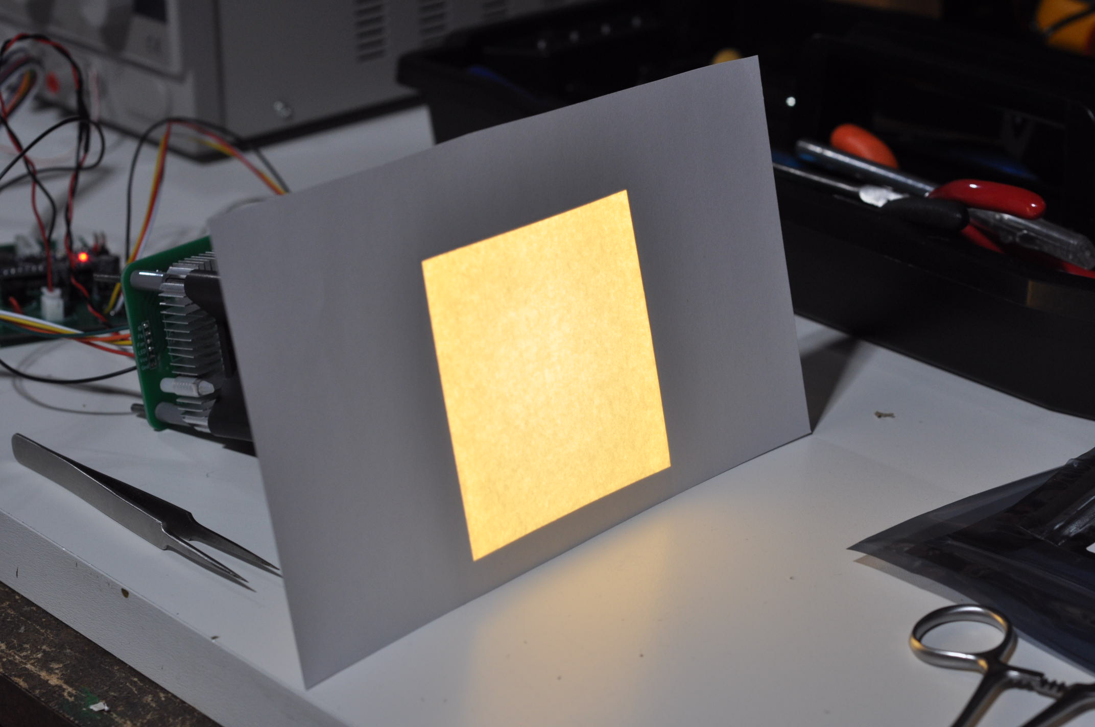

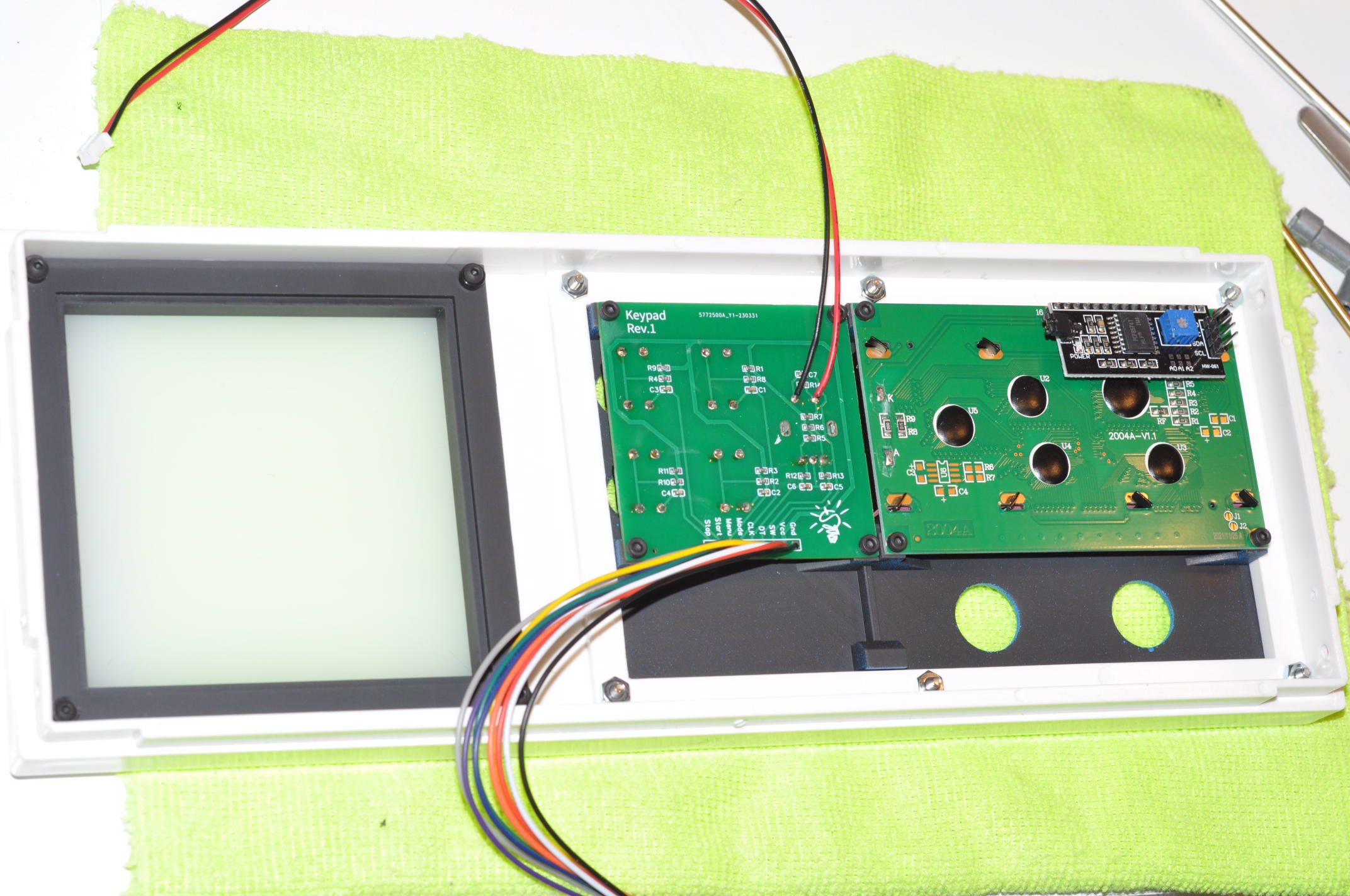

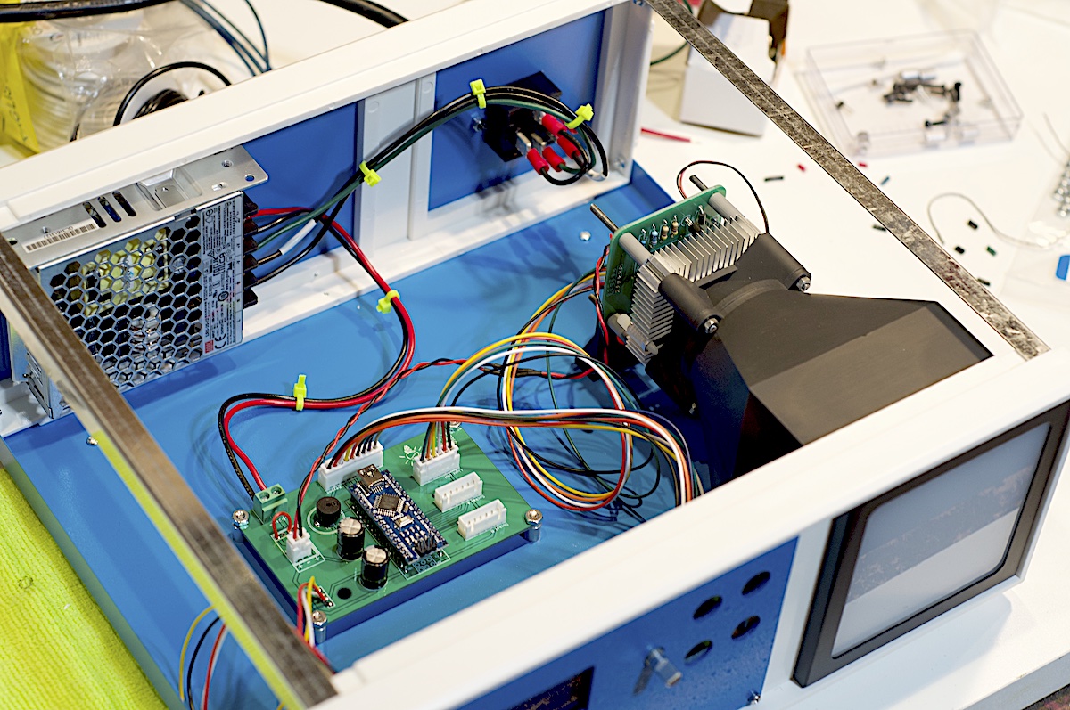

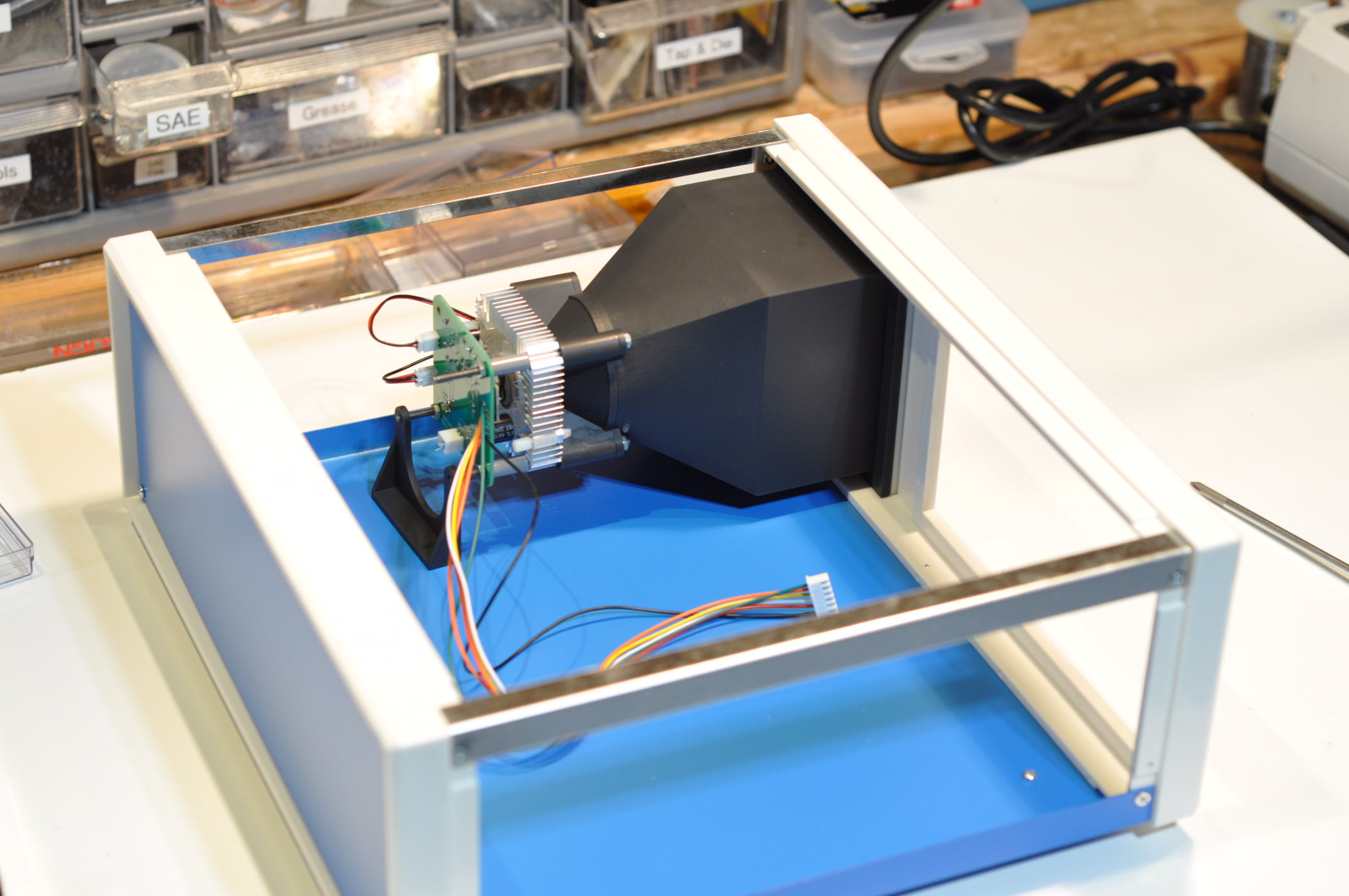

Light unit complete and test-fitting in the enclosure:

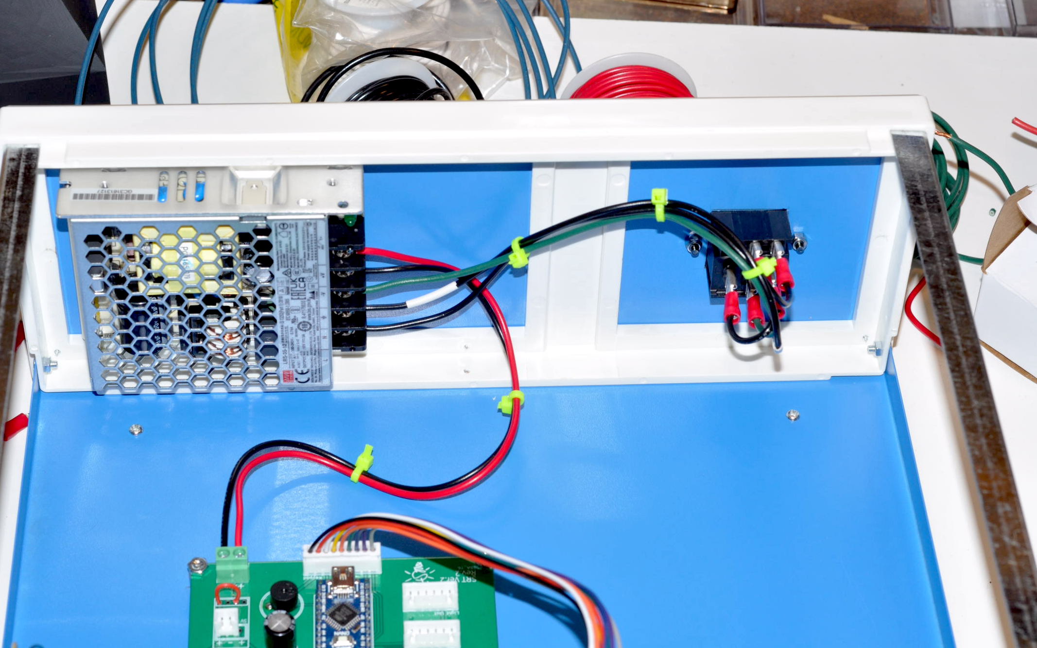

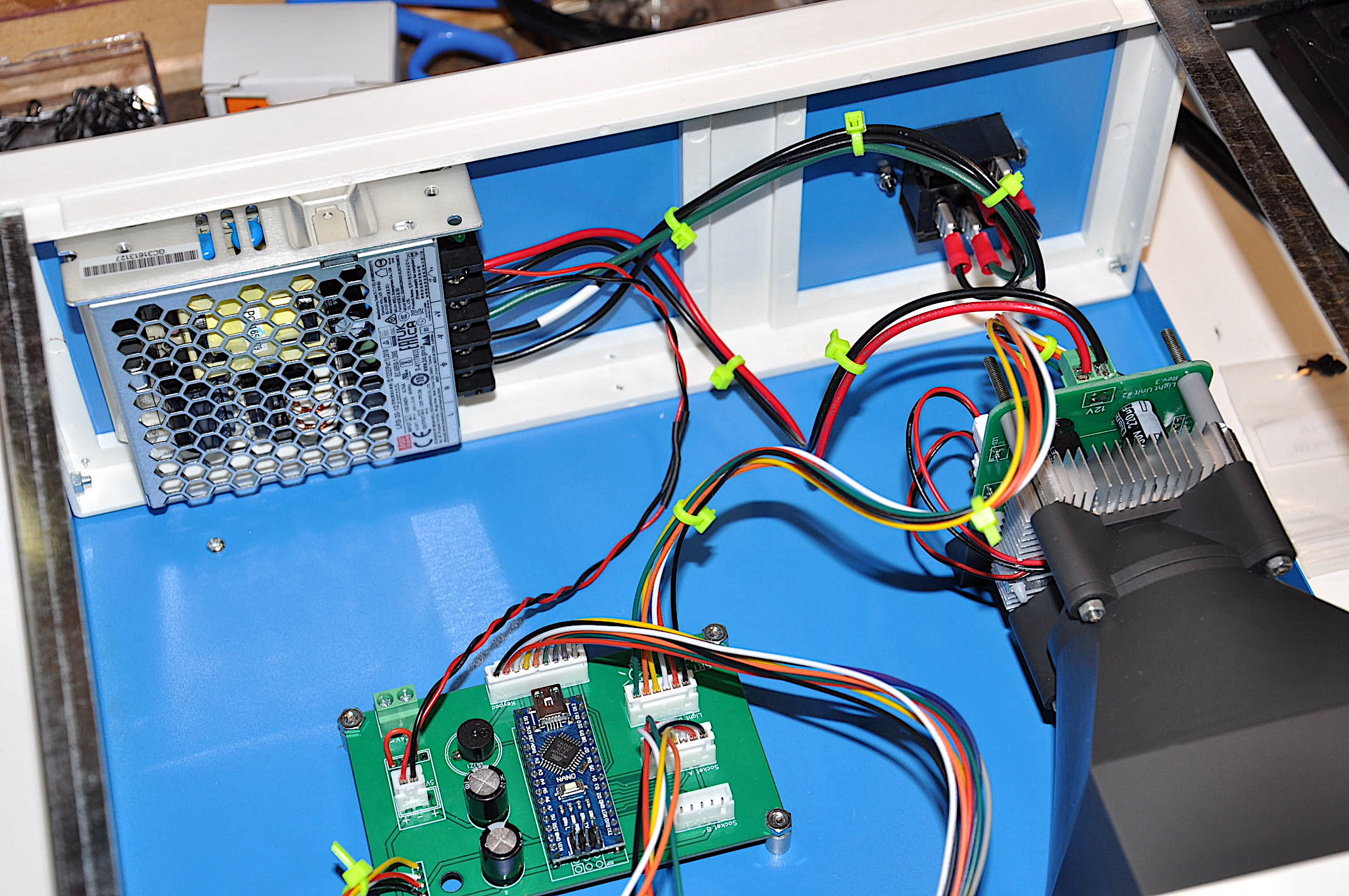

I mounted the Mean Well 12v 3A power supply on the back panel:

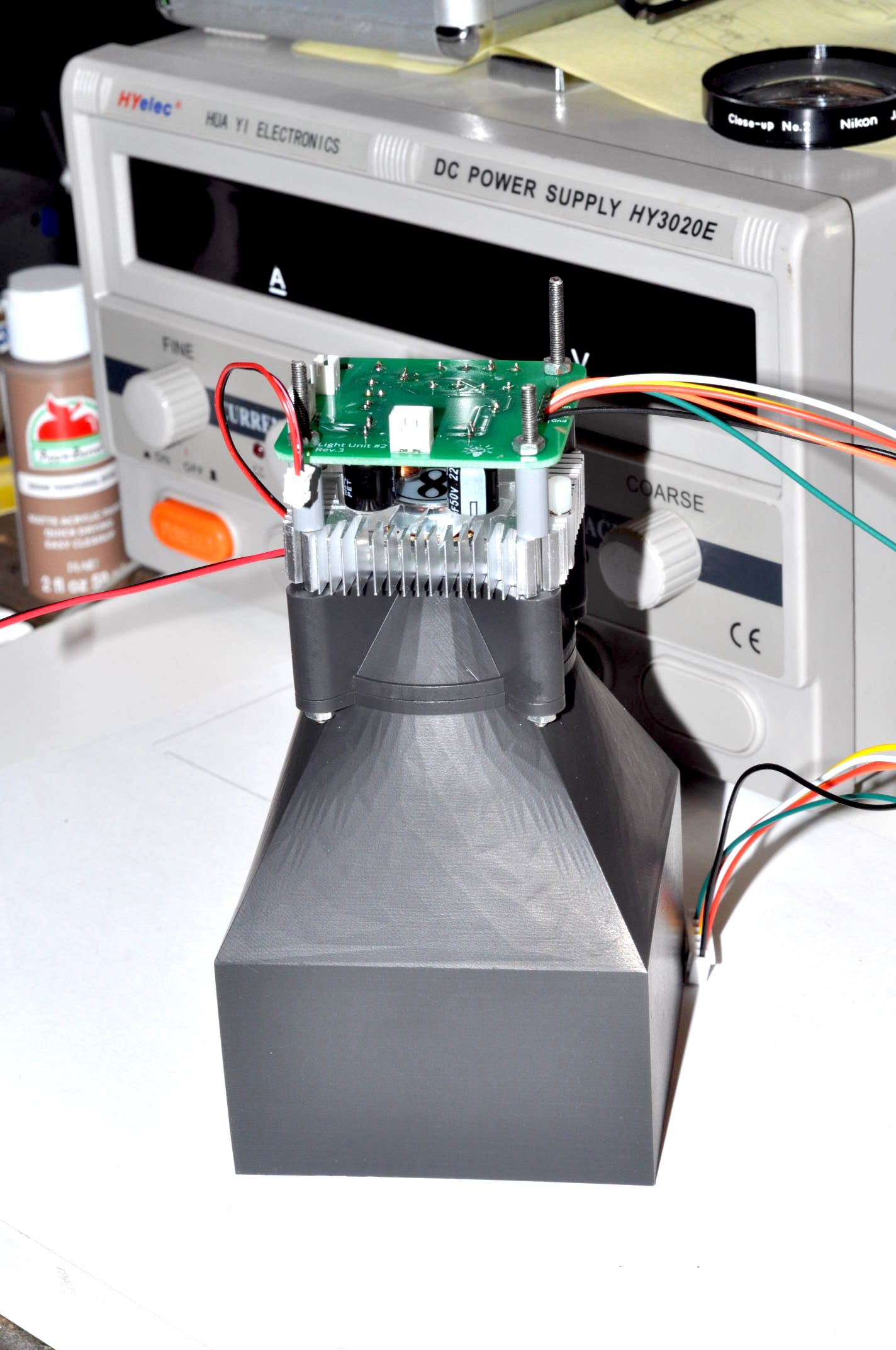

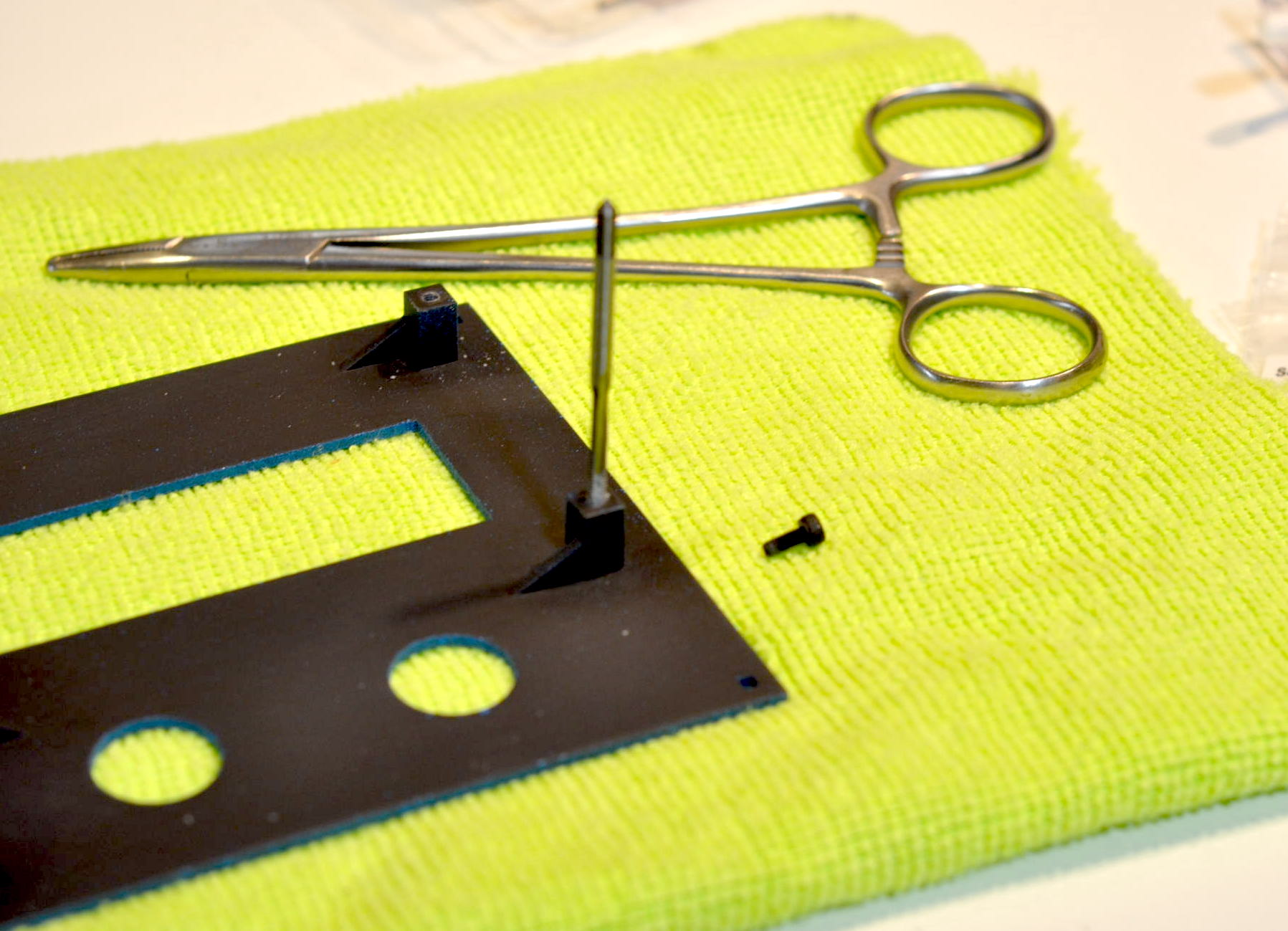

I wasn't sure how well screws would hold in the resin so I tapped them for M2.5 machine screws. They held well, none stripped during construction:

I’ve skimmed through your documentation on GitHub. Phew, what a palaver for the Mac! Your persistence paid off though, you must be feeling good.
Geez, what a workaround!
I probably would have ended-up either installing some version of Windows on a VirtualBox machine or trying to flash it using some WINE variant...

Looks like it is coming along nicely! Have you built the FP shutter probe yet?
I can't tell from you pictures, but I'm not seeing any provision for forced air cooling. With that light source and power supply inside the enclosure, you might want a small muffin fan blowing some air around, particularly if you're going to leave the light source turned on for any length of time. Since the bottom plate has no vent holes, I assume the top is the same. It looks like there are a few vents on the side panels. A small fan running off the 12V or 24V would increase reliability long-term, and it might make the light source more stable and accurate, as well.
Good work!
Actually, now I have those long strings for the avrdude parameters, re-flashing the Nano was easy. I needed to re-flash because my photodiodes are the original style, not the reversed output ones.
I just plugged my programmer into the six prong header on the nano which was already installed in the box; didn't have to disassemble anything.
Good work!

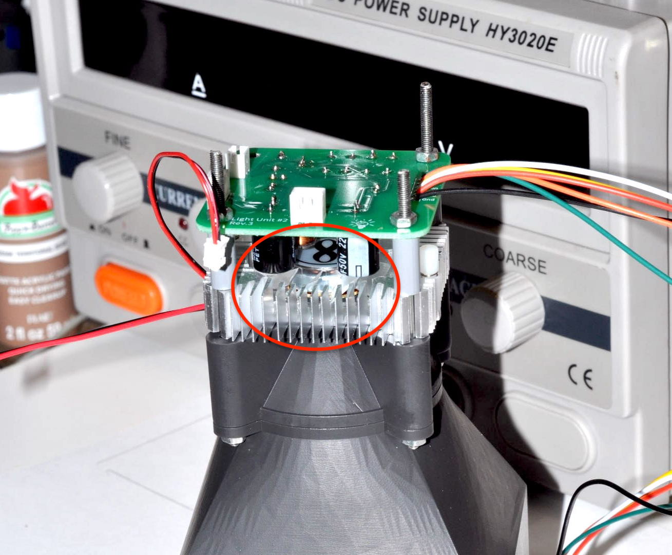

There is a fan circled in the picture.

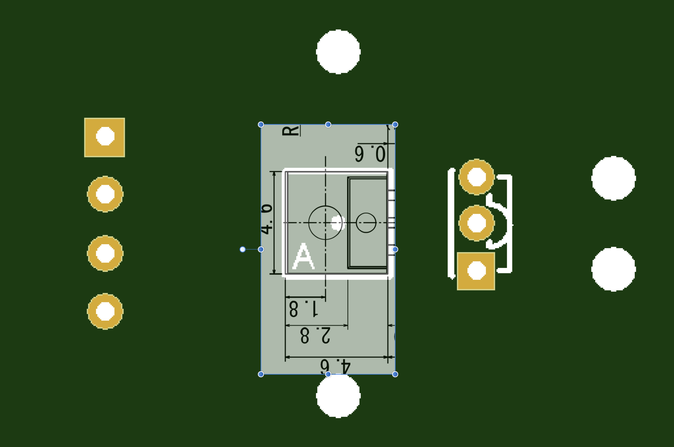

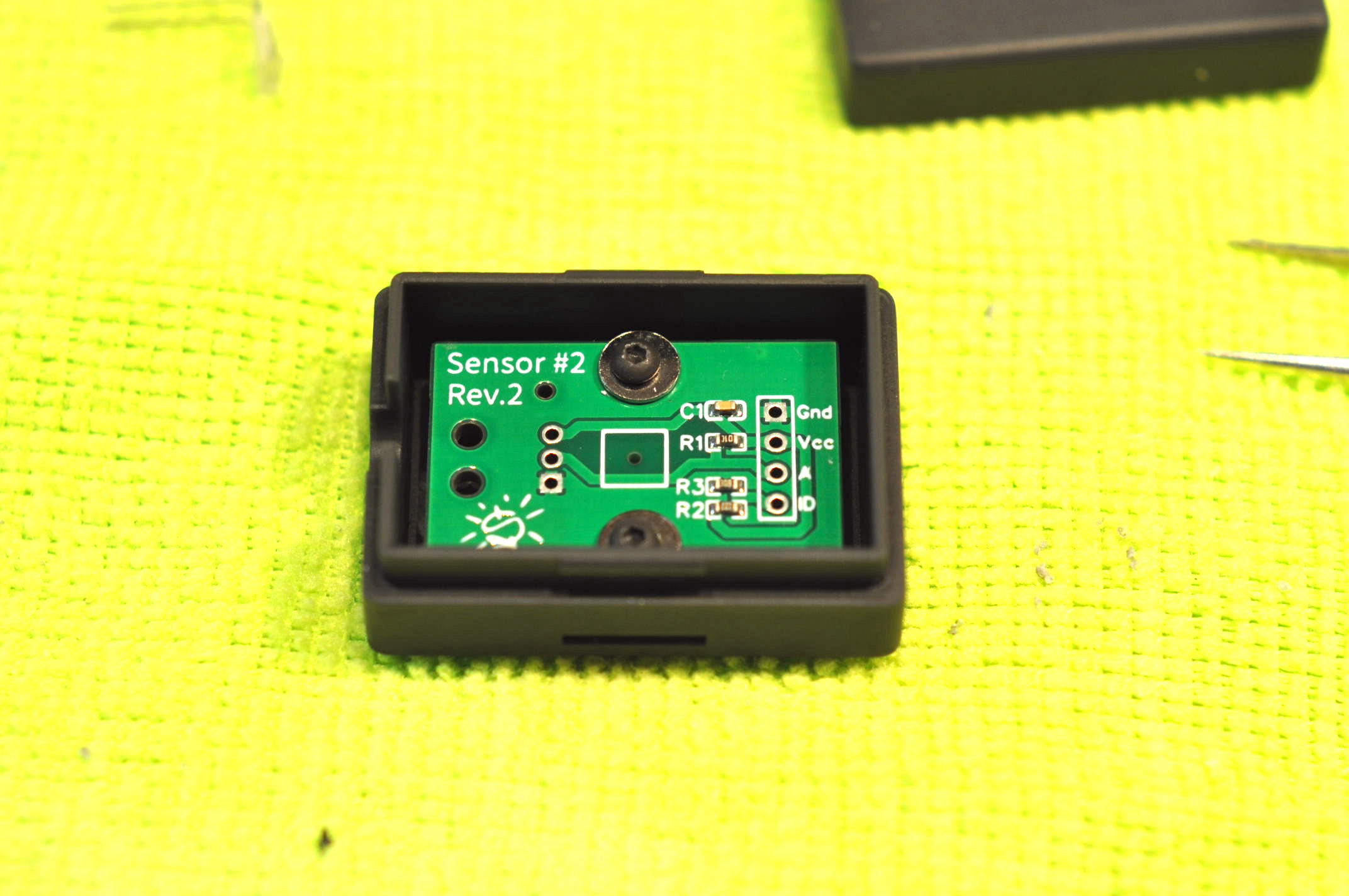

I assembled the photodoide sensor "Sensor 2" but it would not respond to light appropriately. I took it apart and found the photodiode needs to be shifted slightly based on the printout on the PCB board to align the lens on the photodiode to the hole one makes in the assembly. The PCB printing assumed the lens of the photodiode was in the center, but it is not, it is off-center.
I did say "blowing some air around", but what I should have said was removing warm air from the cabinet. I don't know what the current draw from the LED lightsource is, but if it's more than a few watts, you will eventually have some heat building up within the enclosure, since convection won't do much with vents only along the centerline of the side panels.
LED's, unlike incandescent lights, do not emit much in the infrared spectrum, so almost all of the power dissipation is as heat. That's why the light source has it's own fan, but I'd still consider a small fan to push air in or out of the cabinet.
I don't mean to belabor the issue- I think you're doing a great job on the build-- much nicer than my version!
Those are good points. The enclosure does have cooling holes on the sides. The lamp only goes to EV17 which is quite a bit dimmer than maximum intensity. So, the LED does not get very hot.
