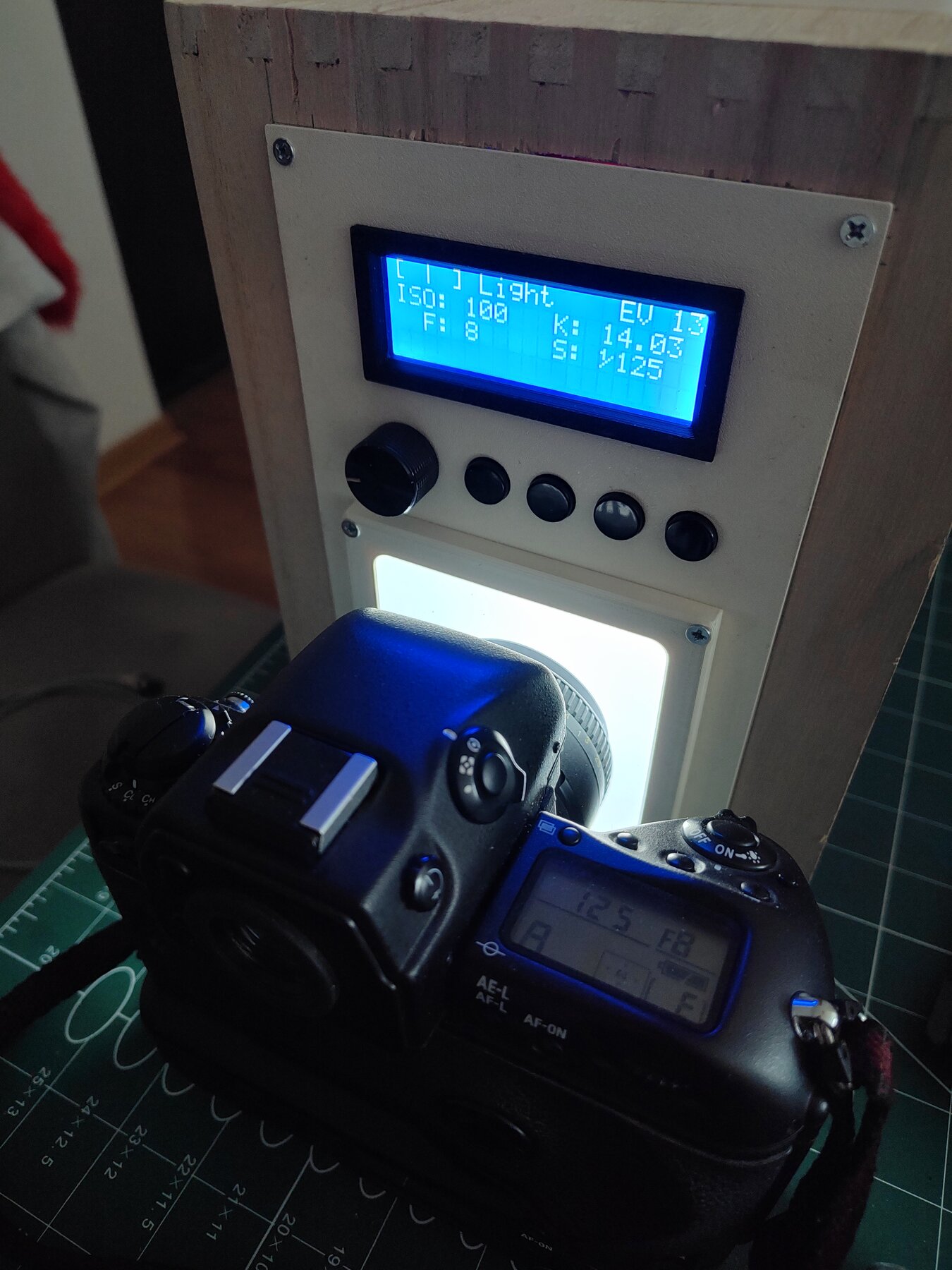

I've assembled the tester, complete with the power supply, and I've tested it a bit. It measures nicely, tested with the simple sensor and a Nikon F5, it's dead on.
I powered everything with a Meanwell LRS 50-12, but the voltage regulator on the Nano gets hot, and I think I'll add a buck converter and power it with 5V, and reserve the 12V for the light unit.
However, I am running into an issue with the LCD or booting. Sometimes the LCD only shows blocks, until I reset the Nano repeatedly 2-3 times by pressing the reset button on the Nano, and then it powers up normally and runs normally. Any ideas what might be the issue?

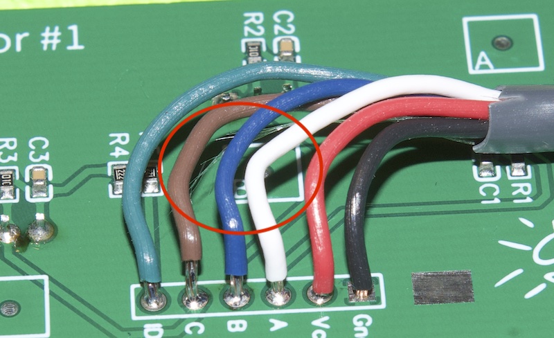

Yes, maybe a short. Check for things like stray strands of wire, etc.
