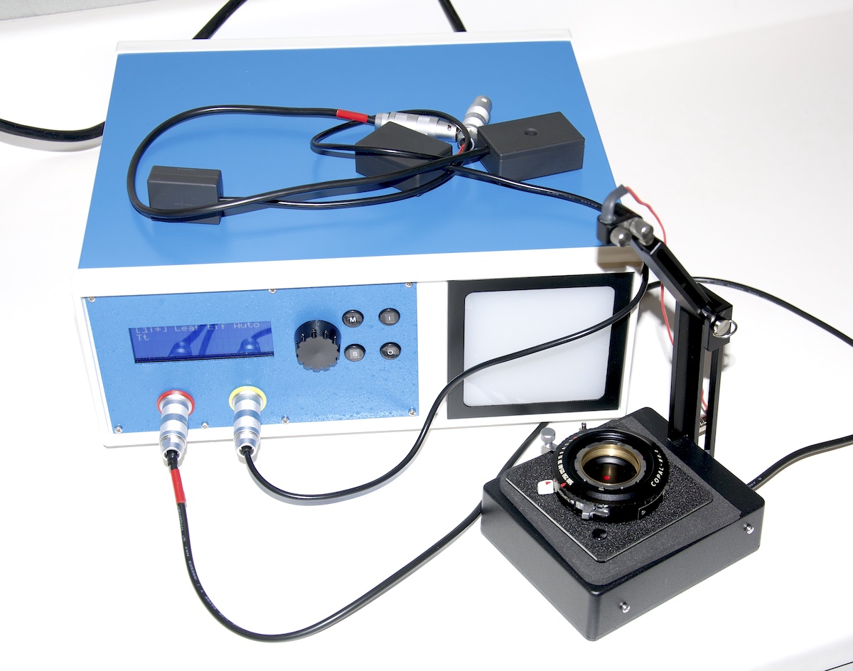

Oh yes, a closed loop system would be great, but the main drawback for any modification of this project is the lack of open source code.
I was hoping someone might offer up some open source code for the device, but from this thread and the on on GitHub, everyone is using the Hex code firmware (that probably won't ever get any updates or changes).
The Kyoritsu testers, on which this project is based, use a series of trimmer pots for the intensity calibration; so it is not closed loop either.
BTW When I analyzed the X-rite sensitometer, it appeared to me to have a closed loop system for monitoring the brightness.

Clever idea! Do you think you will build one of these testers?
After re-reading my X-Rite 334 thread above I thinking out loud about pros and cons of using an electroluminescent lamp as a testing light source since they have constant color temperature when dimmed and a near perfect even illumination.

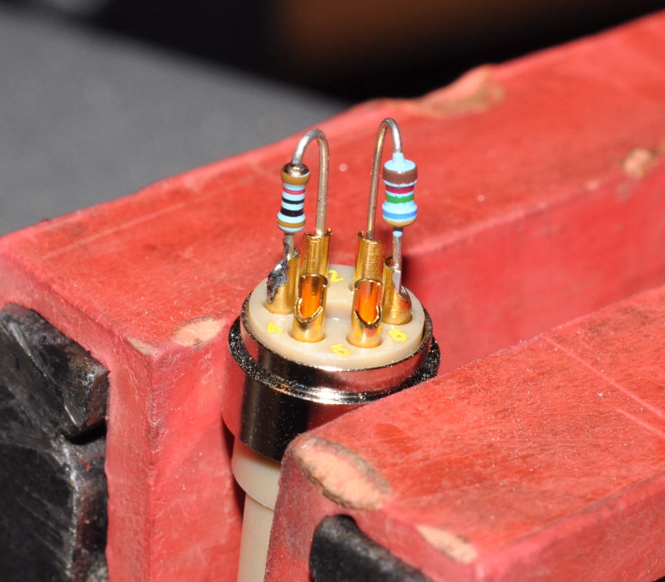

I finally finished the flash synch tester cable. First thing I had to do was to redraw the schematic to match the connectors that I'm using:

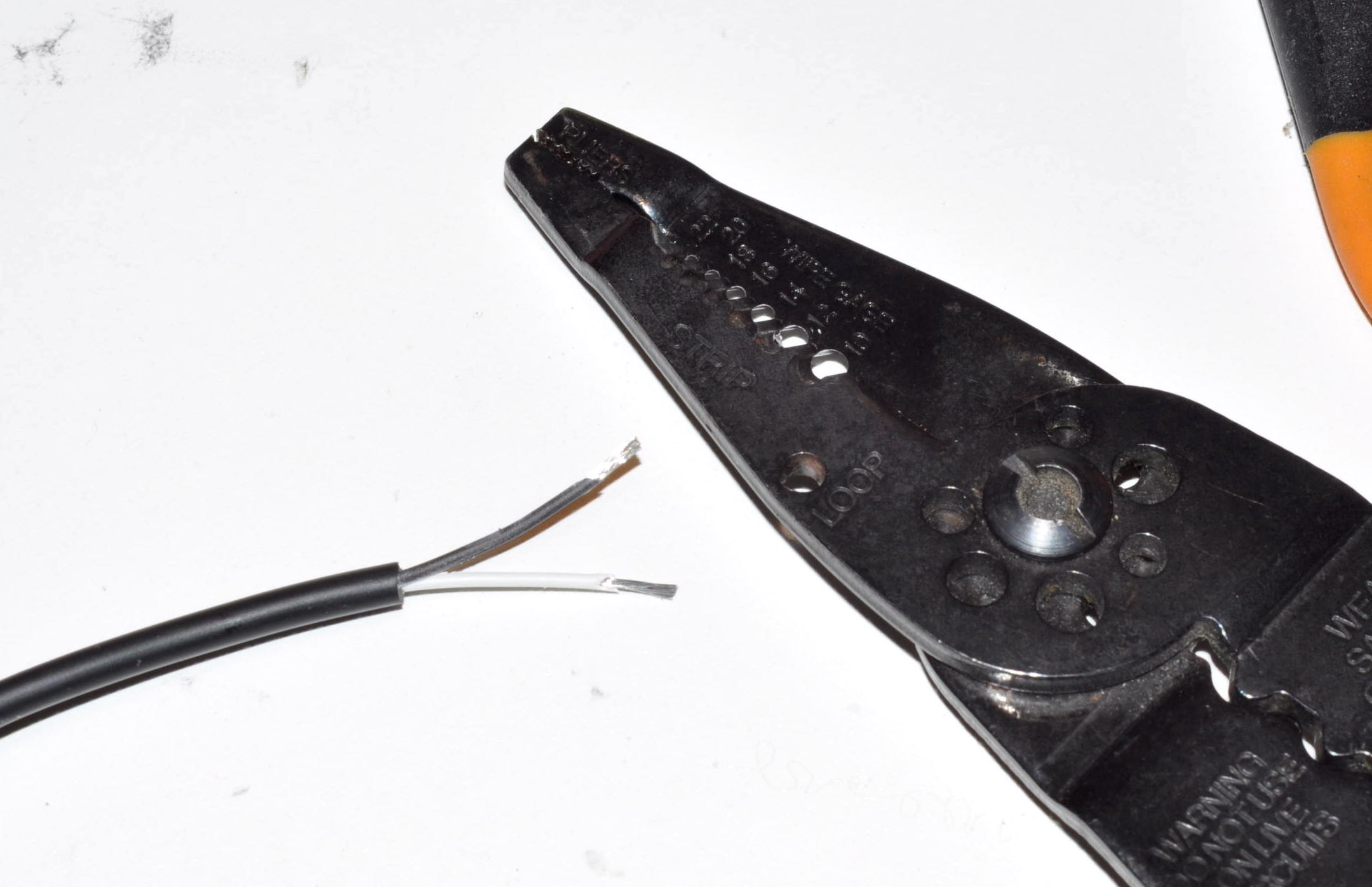

This synch cord was one of the cheapest I could find. I guess because the odd connector on the other end and the length (everyone is wireless these days? No one wants a 33ft cable).
ic-racer
ic-racer
Feb 25, 2007
16,756
USA
I bent the resistors like this so they would fit on the multi-connector:

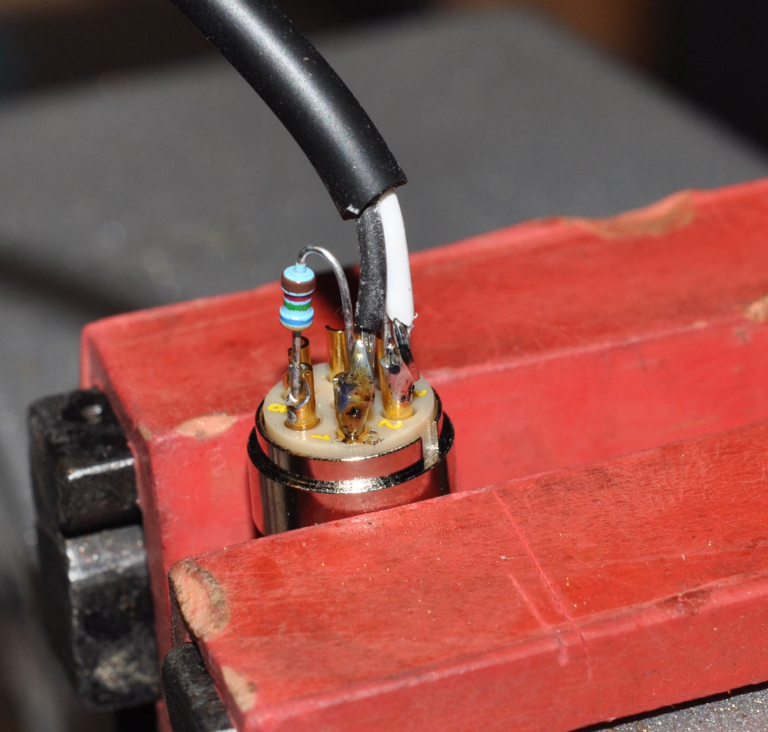

ic-racer
ic-racer
Feb 25, 2007
16,756
USA
Then solder the leads to the correct terminals. Make sure the Vcc goes to the correct side of the resistor. When the synch terminals in the camera are closed, it is shorting the 5v Vcc to ground. Without the 10k limiting resistor the Arduino can fry.

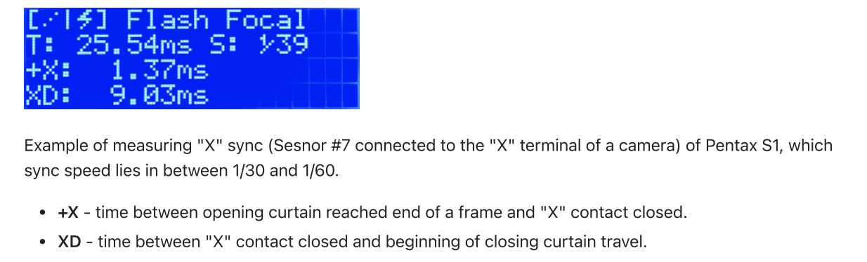

@ic-racer
I bought a synch cord and will build a flash sensor soon for my tester. Can you school me in how to test flash synch? That is, how do i use it to make sure a camera with TTL flash is correctly adjusted?
ic-racer
ic-racer
Feb 25, 2007
16,756
USA
With this tester, only the timing of the flash can be measured. The exposure produced by a TTL flash system cannot be measured. Good old fashioned film testing would be needed for that.
The timing of focal plane shutter and the x-synch is measured as follows (from the user's manual):
