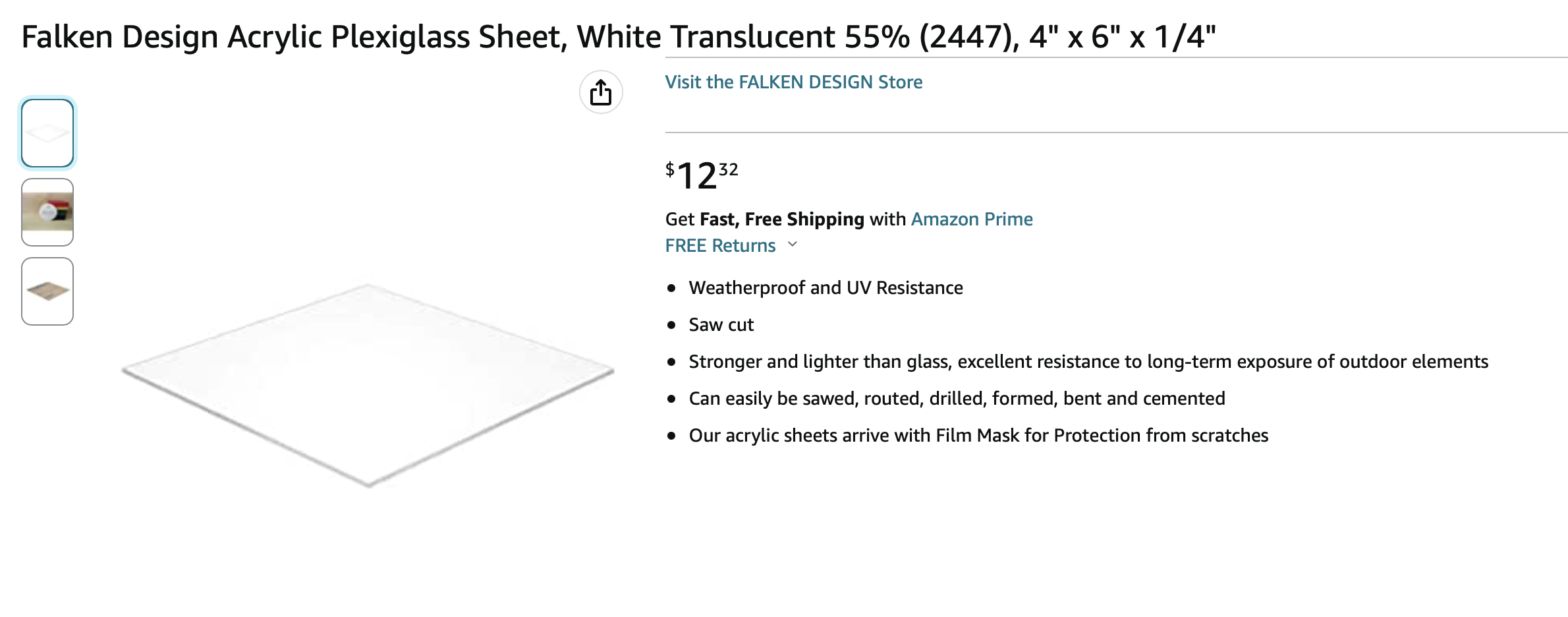

This is the exact sheet I ordered. It is glossy, whereas the instructions ask for a mat finish. I found out "P95" refers to this mat finish. So, if I were to order again I might look for the 2447 with the P95 designation.

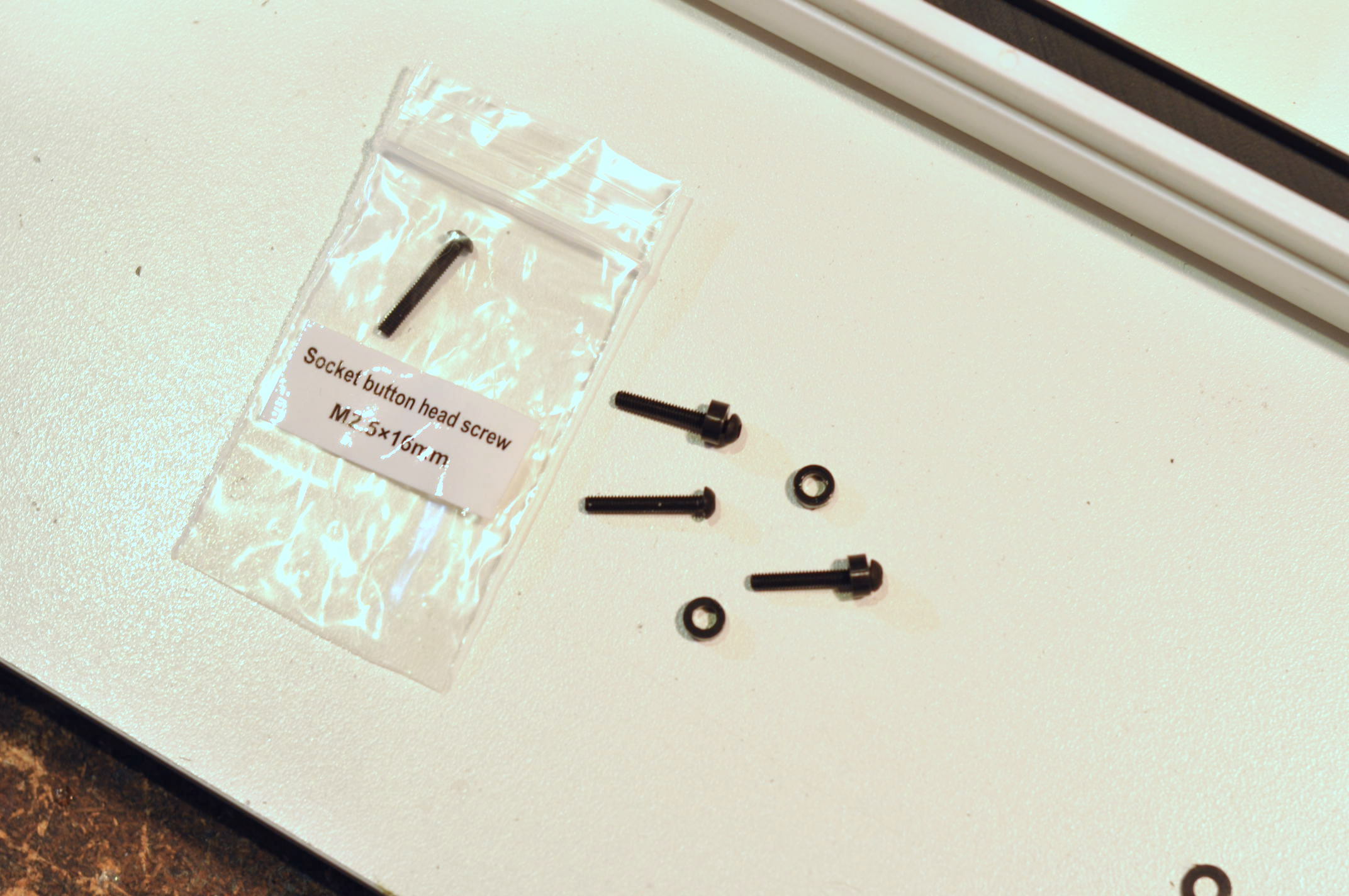

The screws I got were just a little too long, so I put washers under them so they did not push through the front.

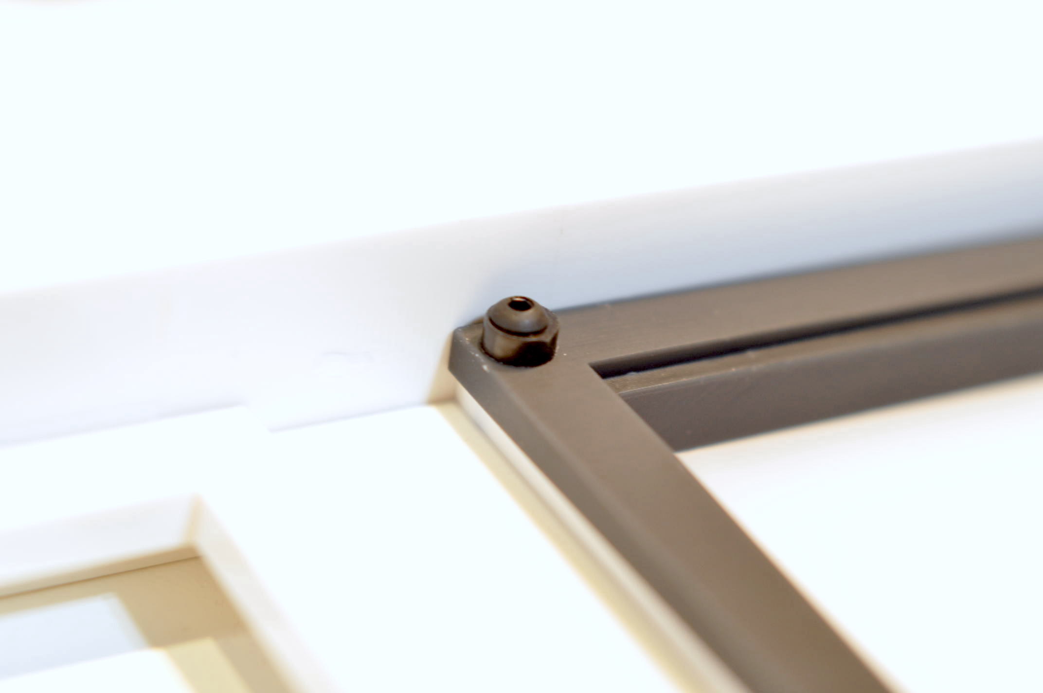

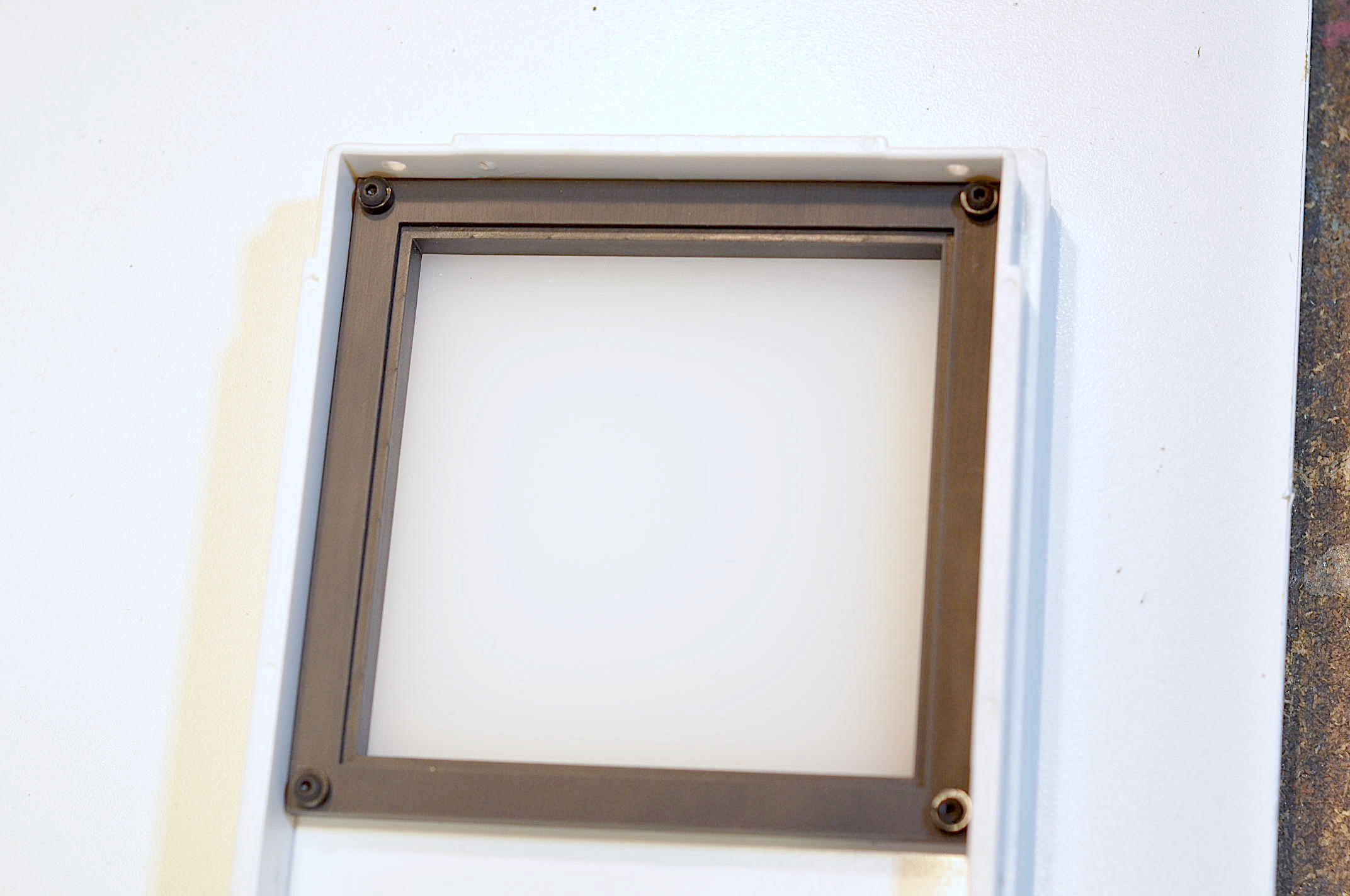

Without a drill press, I drilled from the outside in. Then countersunk the holes from the inside. I made a little jig from the end of the drill to make sure the front side did not get too thin.

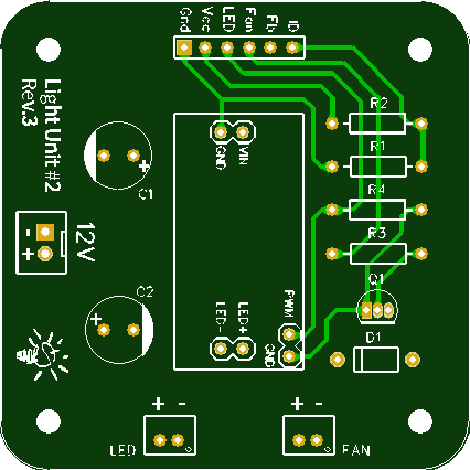

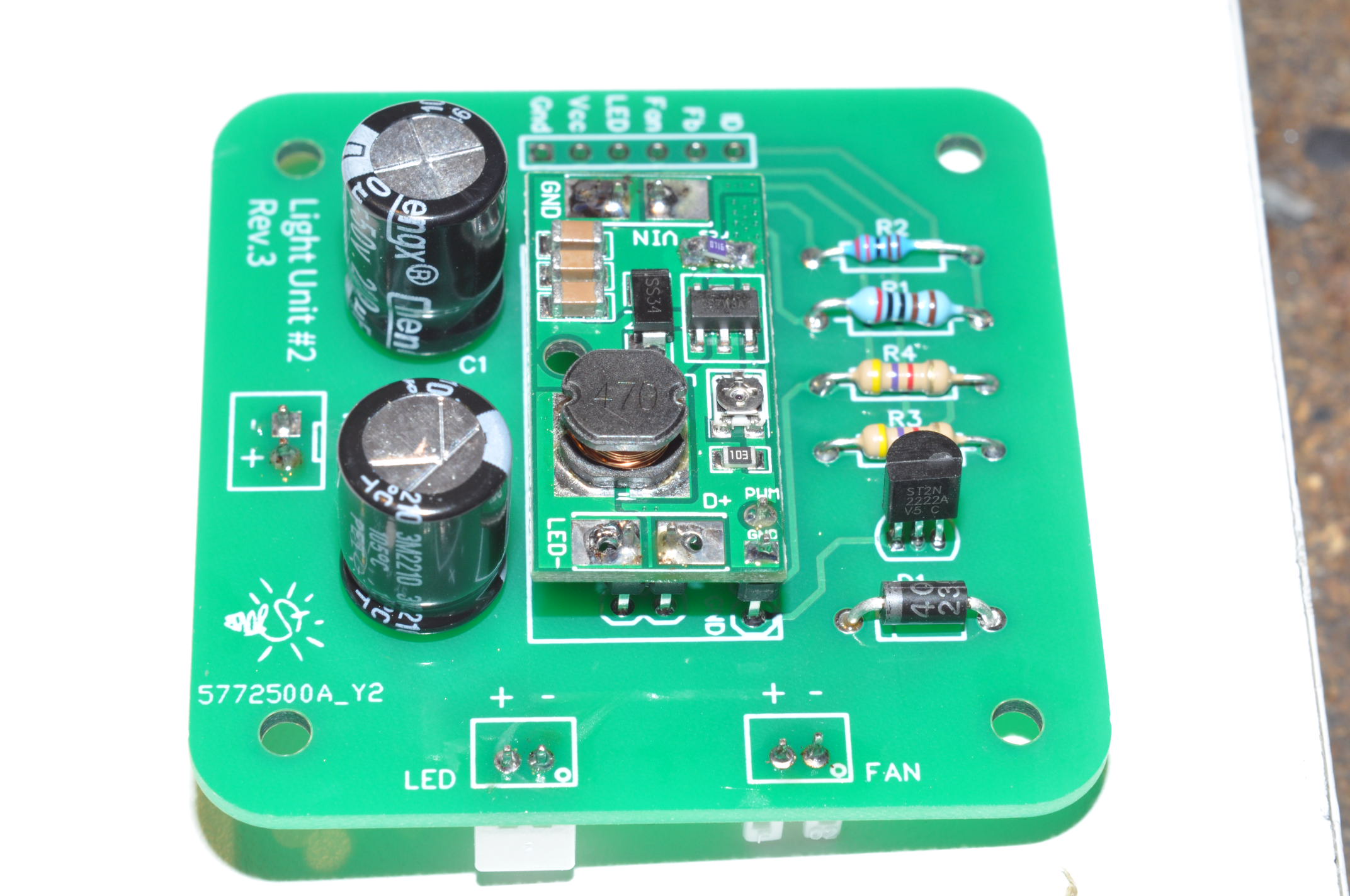

Ugh so many questions - the BOM in the wiki lists parts for a "Light Unit #2 Rev.4" but the pcb assets list only a directory "light_unit_2" which has a BOM file "BOM_PCB LightUnit2 Rev.3.csv" (noting the Rev.3 here) and the parts disagree with the wiki. I'm inclined to believe the Gerbers and BOM but also curious if folks have also noticed this.
ic-racer
ic-racer
Feb 25, 2007
16,755
USA
This was asked and answered but not captured by Way back machine. I believe the answer was merely an insignificant change in capacitor values.
I also went with the "BOM_PCB LightUnit2 Rev.3.csv" file – the wiki does not even state which resistor goes where. Let's hope for the best..
I used the parts from the BOM file (Rev 3), rather than the WIKI (Rev 4). In that case, resistors locations for R1-R4 printed on the PC board would be:
R1 = 2k
R2 = 2.2k
R3 = 4.7K
R4 = 4.7K
C1 = 220uf
C2 = 470uf
Resistor
ic-racer
ic-racer
Feb 25, 2007
16,755
USA
This what I built. You can see the two capacitors (440uf in front and 220uf in back).
You can see the replacement 0.091 ohm resistor on the driver board.
Also shown are the resistors R4 and R3, the same value.

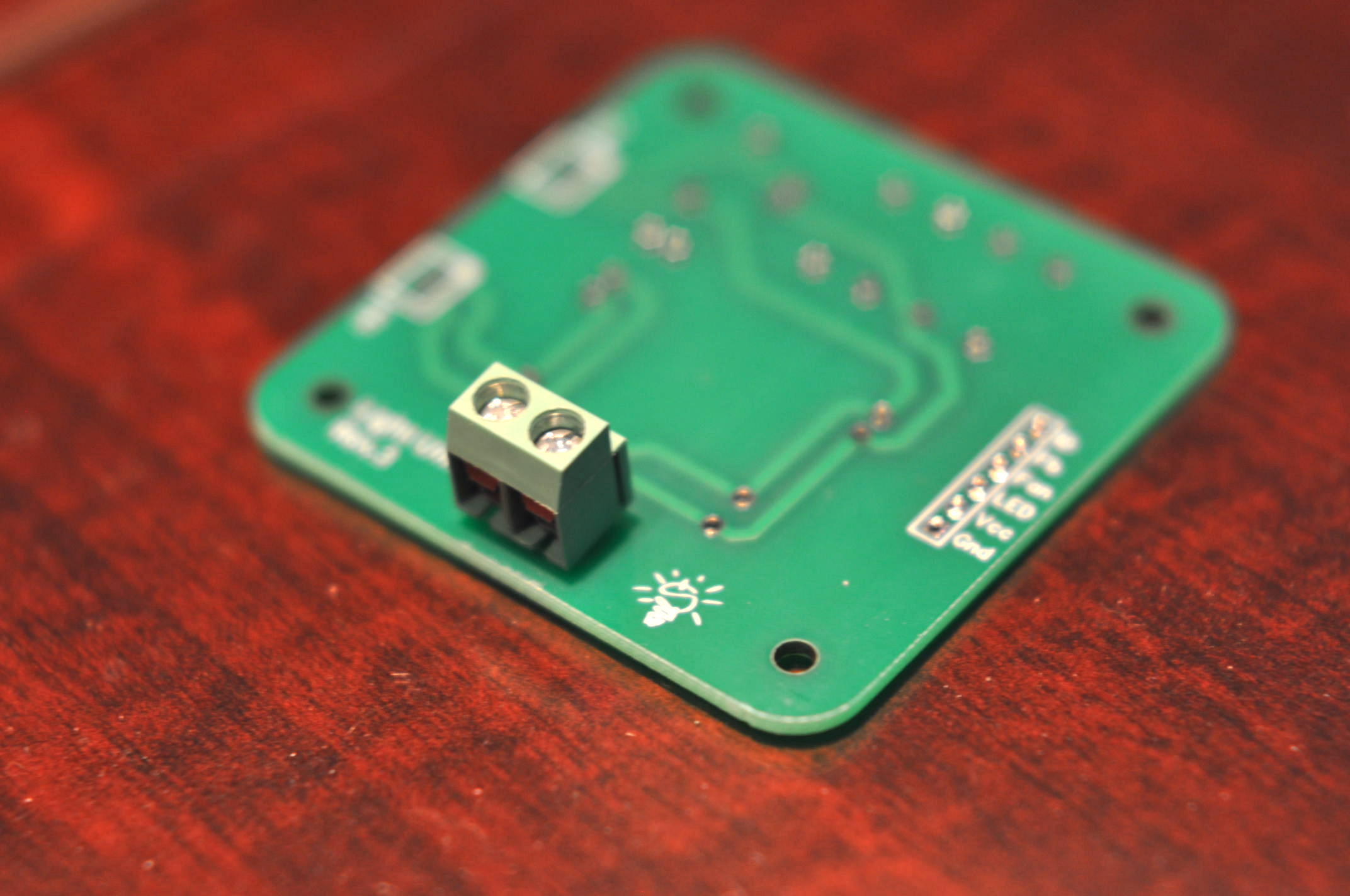

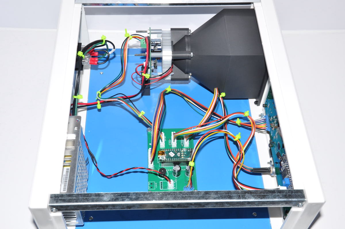

I bent the legs on this connector to fit into the holes of the PC board. Thicker wires from the power supply should go straight to the LED unit.
