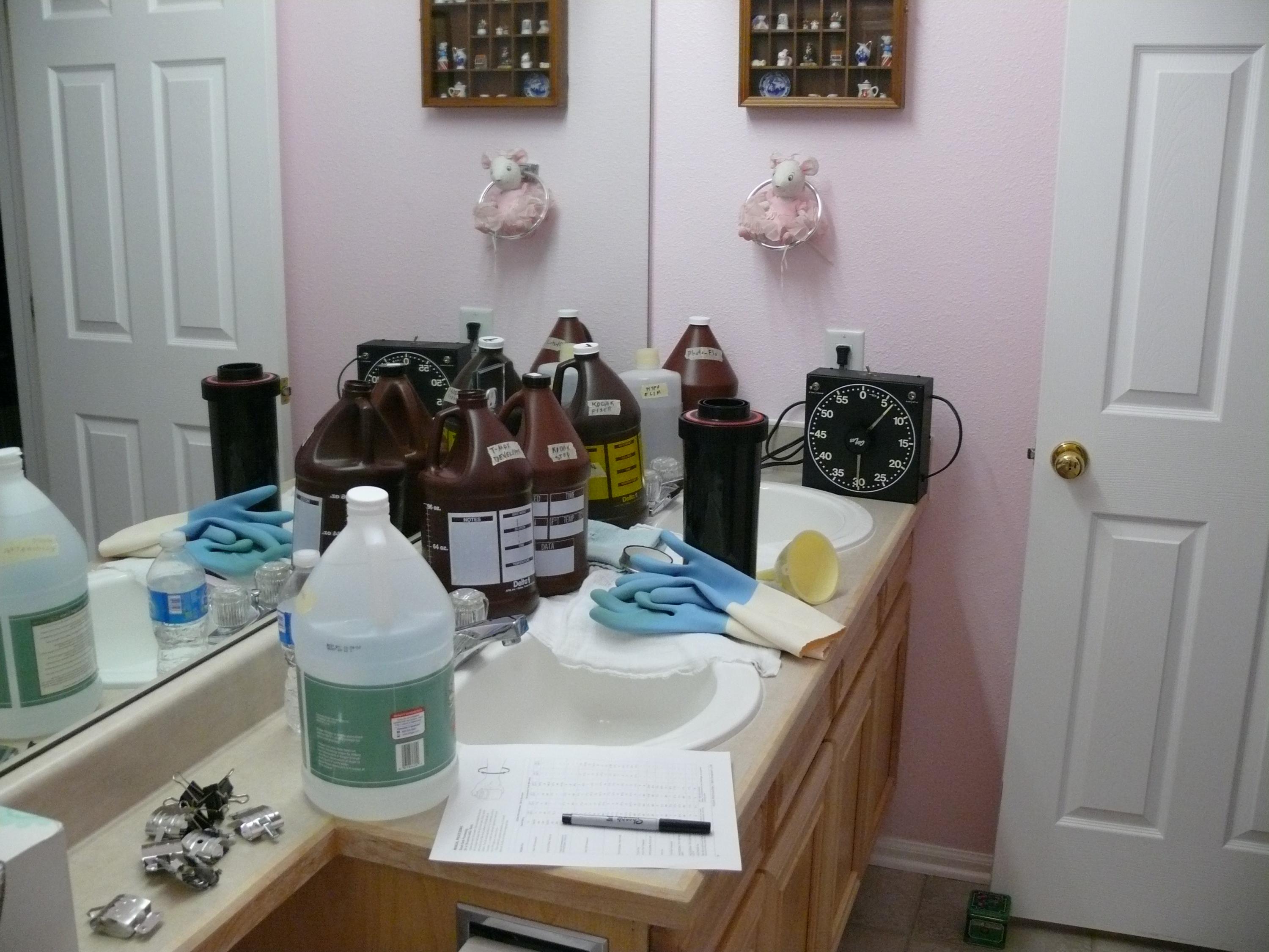

Last weekend, ready to do 5 rolls at once, with Angelina supervising.
Hey, it's her house. I just live there.

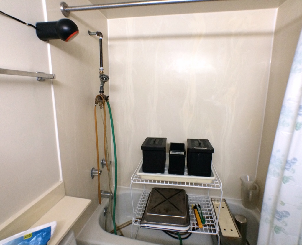

My latest darkroom in progress in a second bathroom in our apartment here in Honolulu. Toilet and sink will still be usable, but the bathtub is now the wet side.
Chemical storage will be outdoors in a plastic cabinet on the balcony, where I also keep the film freezer. I also have a closet for photo/darkroom gear just outside the darkbathroom, and we have a storage unit in a climate controlled building down the street for additional storage.
Dry side:
Wet side:
I'm working on a solution to make more tray space, but I may just print small for now.
My Thomas safelight is just way too powerful for this space, so it's going into storage for now. I've got two Jobo LED safelights, which seem adequate, and they can be pretty close without fogging.
I also had to consolidate my paper, and I'll probably sell off or locally trade my single-sheet feed paper safes.

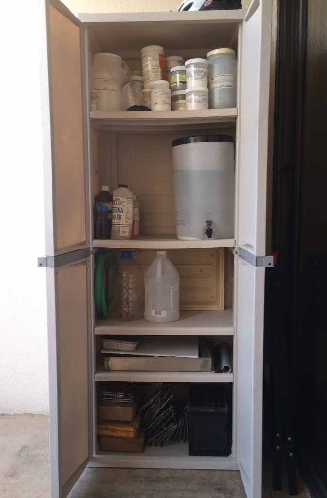

Chemistry cabinet set up on the balcony with first batch of fixer in the large container. I'm liking the idea of storing all this stuff outdoors, and just bringing in what I need, when I need it.
MartinP
Jun 23, 2007
1,569
Netherlands
Some of those shelves look a bit bendy!! It might be comforting for leak control to have trays, or shallow 'storage bin' things, holding the bottles instead of having them separately on the shelves - just as a worst-case reassurance. Ideally the total volume of chemical should be less than the capacity of the tray of course.
I was also thinking of another problem with the whole thing being on a balcony, but I don't suppose that Hawaii often has weeks under minus 10C, unlike here !!

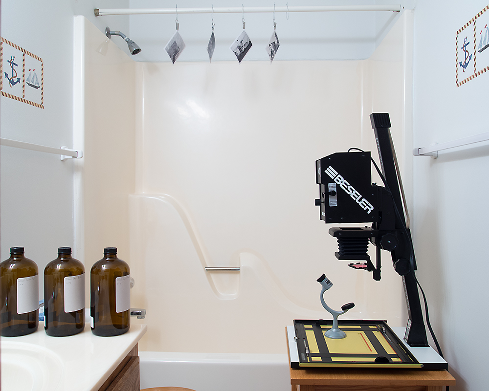

You really don't need much to set up a darkroom. Excellent prints can be created with a good enlarger and standard bathroom sink, everything else is a luxury. My darkroom is a very, very cramped unused bathroom. I have a sturdy end table with the enlarger across from the toilet, which I use as a chair. The bathtub will hold four 8x10 trays. When I print using larger trays I have a folding table that fits in the bathtub. Two of the trays go on the table and two below in the bathtub bottom.
A large piece of think black plastic mounts over the door with velcro and makes the room absolutely light tight during the day. Since I took this picture I have added a piece of black felt that I suspend from the towel rack behind the enlarger, which stops any stray light from bouncing back to the paper.
