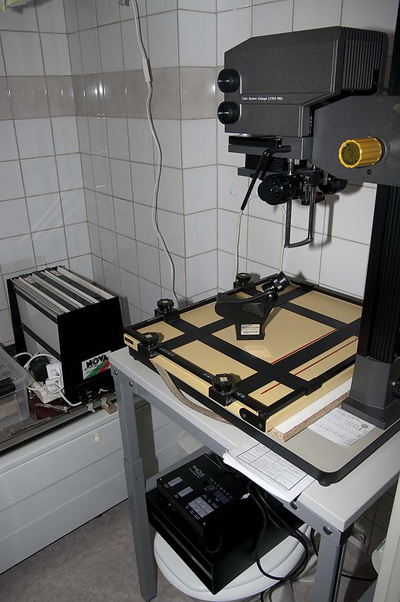

Hi Jason!
I have used the bathroom as my only darkroom since 1992. I published pictures of my darkroom under Darkroom portraits in 2012, and it still looks essentially the same today. My top tips to the beginning darkroom worker with access to a bathroom would be:
1. Doors are seldom light tight. Hang a blackout cloth over the door.
2. Use a board over the bath tub for trays (preferably plastic or stainless steel).
3. Get a sturdy table for the enlarger and place over the toilet seat.
4. Bring the negative carrier to a place next to the bathroom, insert negative and do the de-dusting there (for more space, better lightning conditions and to avoid keeping negatives in a wet environment).
5. To save space and reduce exposure to fumes, get a vertical tank (NOVA). You may still need a few trays, depending on your choice of papers/toning etc.
6. If you have white tiles on the walls (like me), tape black cloth on the wall closest to the enlarger to avoid stray light (although stray light never seemed to be a big problem to me).
7. If you you use selenium (or other nasty) toner, put tray in container with lid. Increase the ventilation while toning if possible (you get dizzy if you inhale this stuff, and I can guarantee it is not good for you).
8. Water and electricity is a dangerous combination. For safety, use a earth-leakage circuit breaker.
9. Even though I have access to running water I could do very well without. Fixed prints can equally well be placed in a container with water and exposed to a final wash at a later stage.
Those are the tips I can think of right now.
