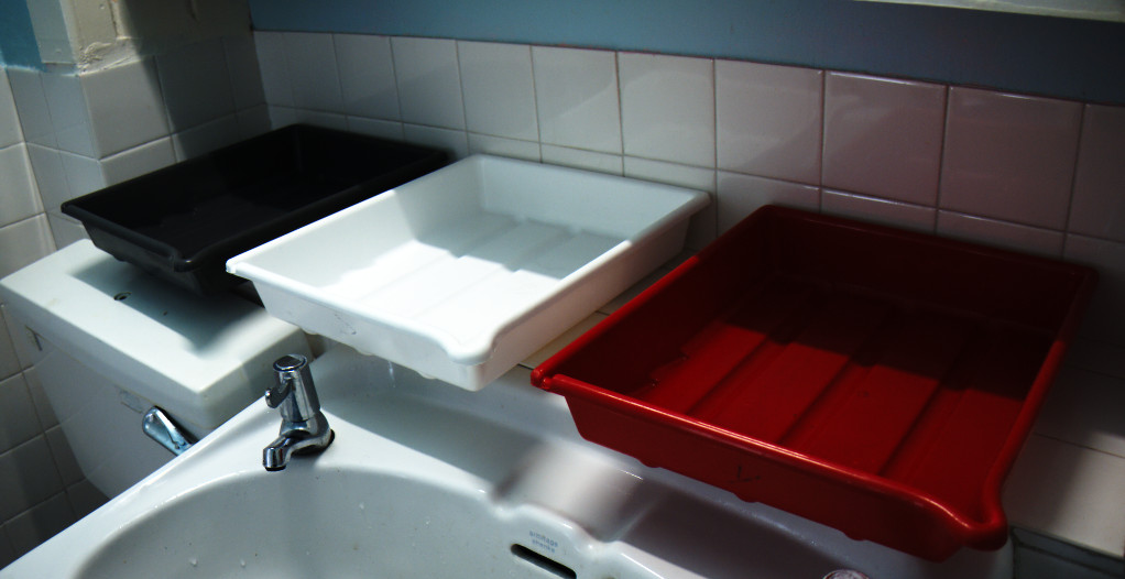

No the trolley simply holds the enlarger and easel on top, with papersafe (actually a shoebox), spare boxes of paper, and the various whatnots one gathers on the shelves beneath.
As mentioned, behind the sinkbasin is a shelf just deep and wide enough to comfortably hold 3 trays, and that's just a stroke of luck in how the bathroom has been built.
So I manage to have a dry side and a wet side in one room, albeit not separated by very much space.
I think if I tried to use the trolley for the trays it would be more trouble than it's worth for me.

pdeeh
Jun 8, 2012
4,770
UK
Sorry analoguey, I haven't described things clearly enough. I don't have them stacked.
A picture will be best :smile:

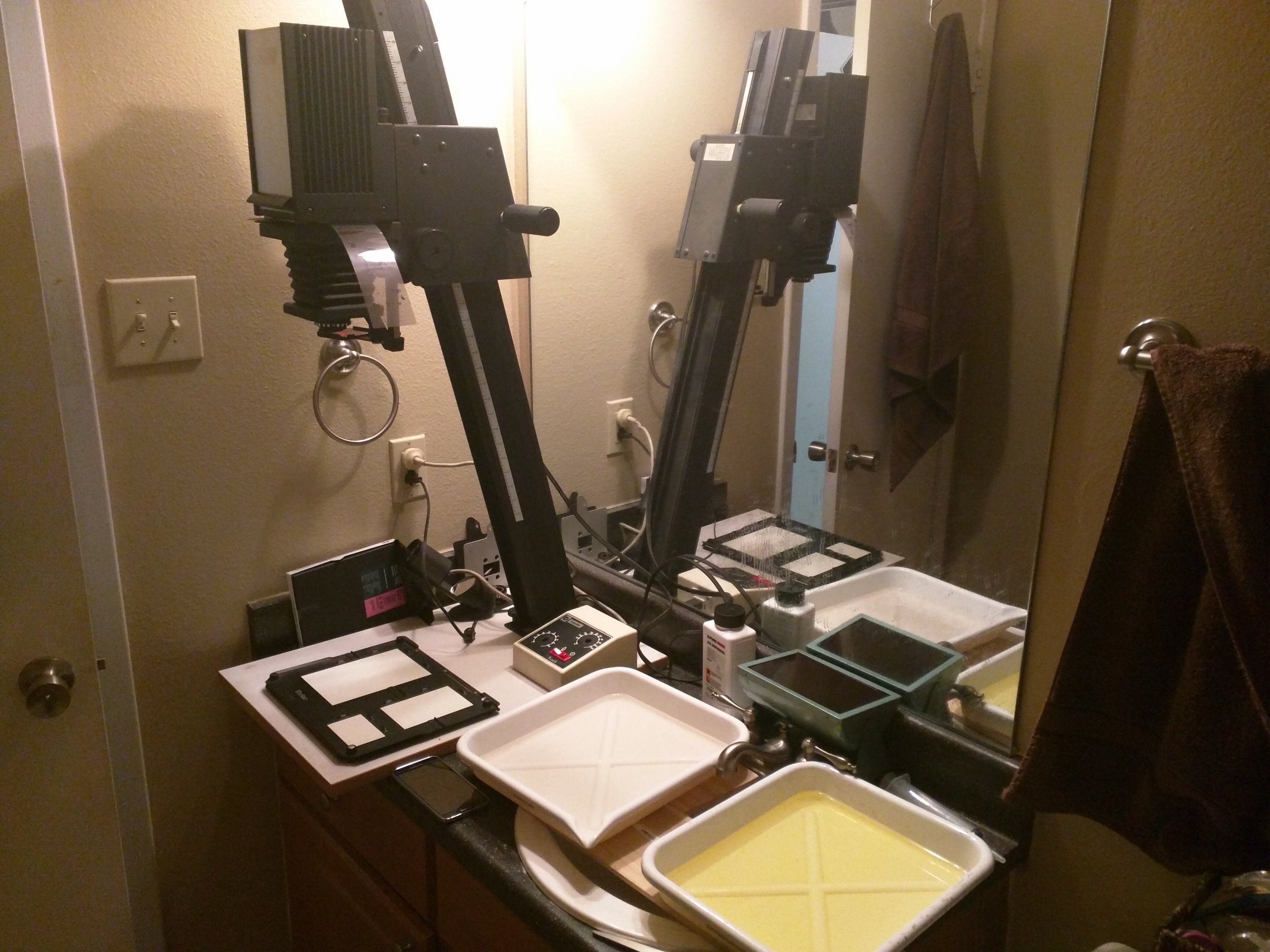

Here was my cramped little temporary/makeshift/bathroom darkroom that I had in my 1 bedroom apartment. I managed to cram a Beseler 67 in there, and had three trays sitting on a 1/4in wood plank that was sitting over the sink.
I placed a wash tank in the bathtub and had a slow trickle going into it whenever I was washing a print. I also used some magnetic clips to hang prints from the shower curtain rod to dry.

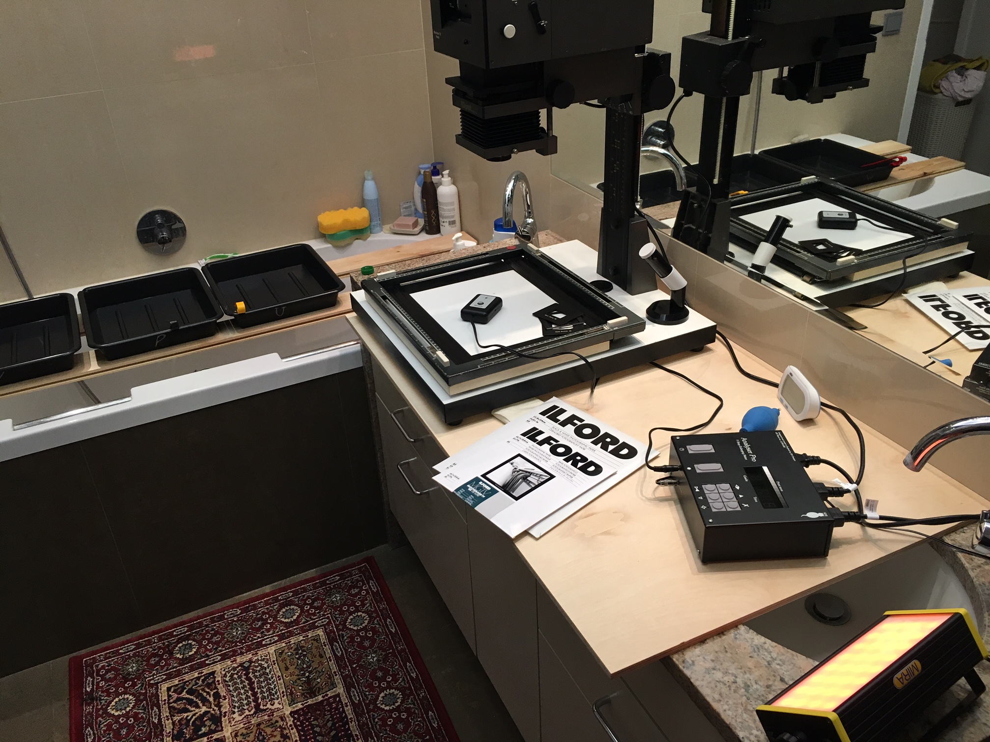

This thread seems a bit dead, but here's my contribution anyways. I finally remembered to take some pics while it was set up.
It's the only bathroom in my apt so the toilet is always accessible...

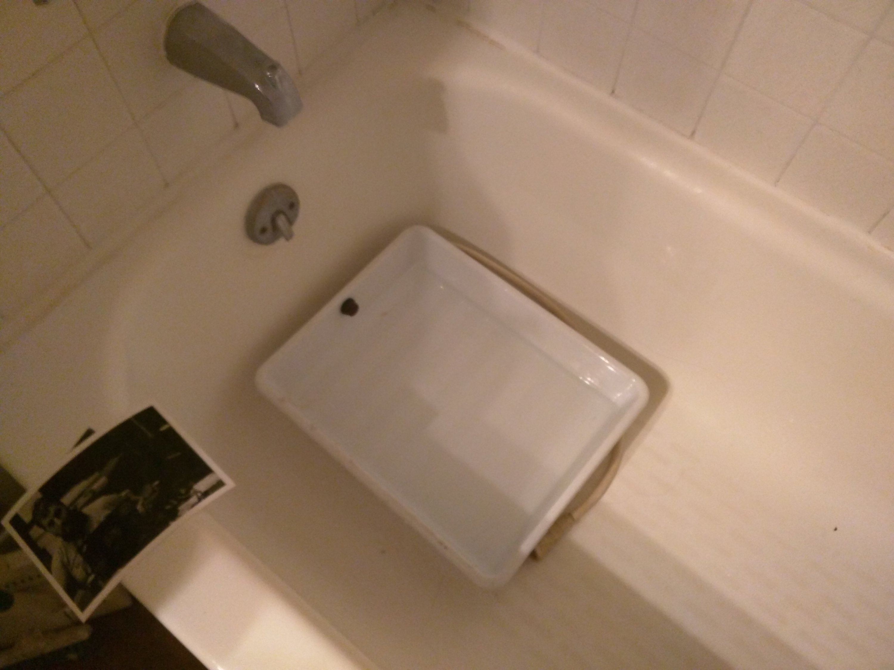

Picture of the wet side, an old Ikea dining table fit above the tub. A second wash tray sits in the tub under the faucet.
Picture of dry side. A small particle board covers the sink. A copy of "way beyond monochrome" happens to be where I started keeping notes, so it's always in the darkroom. Two kitchen stools provide the main support for the enlarger, making it *almost* countertop height. Another scrap piece of particle board holds the paper under the enlarger, and a footswitch to start and stop the timer sits under the stools.
There's enough space for a chair which is good for the back.
