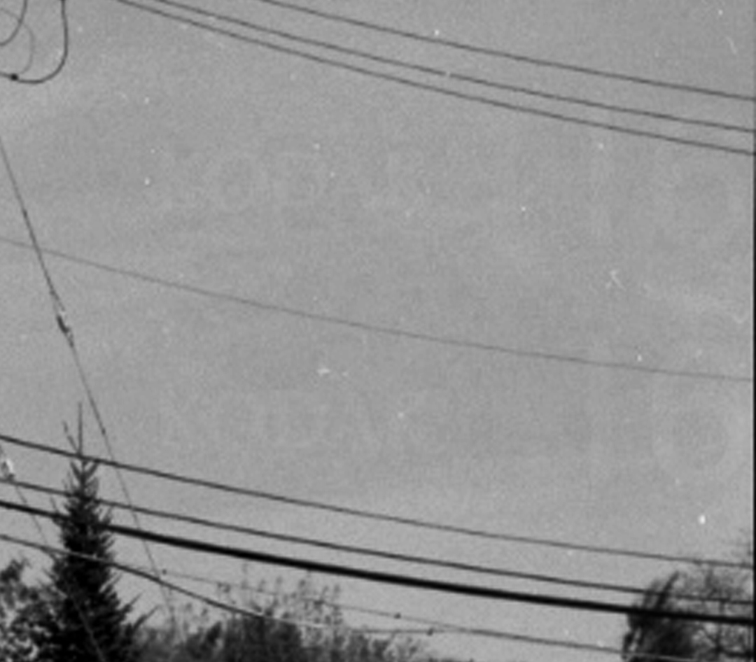

Just got off the phone with Kodak. I have 4 Propacks of film that leave that watermark. I scanned the negs and sent them by email to them. They called me and are immediately replacing the film at no cost to me. The Batch number is 0151 002 with expiration as 09/2017. The rep explained that somewhere in transit the film may have been exposed to high heat, most likely.
I am attaching a pic of the very enlarged part of the neg scanned so you can see the mark. I also noticed that the backing paper is very different, whiter and the inks way blacker than I am used to seeing. It may be heat OR a manufacturing flaw. Nonetheless, it is NOT a light leak or any such thing.
Hope this helps those of you who have had this happen. Call Kodak.

OK, I have the batch number thing figured out, it is on the film proper like Matt has shown. My bad roll is 0151 001 / 09/2017. I have no more of that batch number in the fridge but what number I do have....and a fair amount of is 0151 002 / 09/2017...so I could be kind of screwed. I do know that I only buy my 120 film in boxes of 5 so there are likely at least 4 more bad rolls in my to be souped bag, but I already knew that.
It would be great if we could start looking at batch numbers that have the issue, that way people can decide what to do with them if they have suspect rolls too.
Please note my post from today. Same batch but 0151 002 09/2017. Watermarks clearly visible. Contact Kodak at 1-800-431-7278 and ask for Jenna who got me to the right person.
