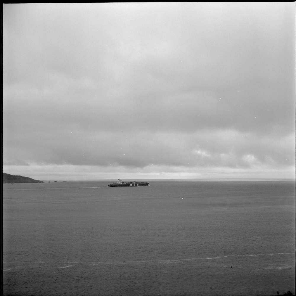

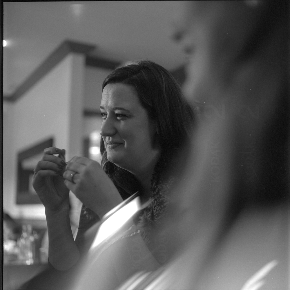

So, any updates on this problem? I just started experiencing it myself. I shoot with a Yashica-mat 124 (no red window!), and first noticed the numbers in March 2016. Here are home scans of shots from two different rolls of Tmax 400 that have the problem. While my camera does occasionally have a light leak issue (it's old, and i usually have it on my shoulder banging into things), frames with light leaks don't have the numbers, and frames without light leaks do have the numbers (sometimes frames with light leaks have the numbers too), so I don't believe it's correlated.
I just read three different threads, and still have mixed messages!
I'm not the most scientific type, but I can tell you all that I have used this camera for five years. My behavior with it is no different than it ever was.
I've seen the problem under various shooting conditions, from arid Death Valley to rainy San Francisco (I see a lot of mention of humidity as a factor).
So... any new news on this?

You need to get the attention of Kodak, not that of APUG.
Who is contacting them, and what is their answer to date?
PE
How old is your film? I've had this problem with older rolls of Ilford films, but not Kodak. Regardless, I agree with Photo Engineer. You need to let Kodak know about this, especially if the film isn't that old.
I believe this has been done on the other thread - Where Ratty mouse being the OP.
Kodaks answer was temperature in excess of normal storage.
The issue is settled! It's not humidity and it's not temperature. I emailed with someone at Alaris who told me there is a problem with the backing paper itself, and Kodak has changed up the backing paper as of the beginning of 2016 to correct it. I asked if there is a way to determine if you have a fault roll... will update if I get a response. I had two propacks worth and Kodak is sending replacement rolls to me.
It is most likely still a problem with temperature - with the backing paper exhibiting an unpredictable greater sensitivity to temperature variations than previous materials.
Otherwise, all rolls using the "new" backing paper would have showed the same wrapper offset problems, instead of the relatively few rolls that did.
That being said, I am hoping that the recent change will prevent normal re-occurrence of the problem. There will always be some occurrences of wrapper offset, as extreme storage and handling conditions will always tend to make the paper and the ink perform in non-optimum ways.
