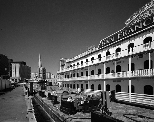

I spent six weeks in san Francisco, shooting my Mamiya 7. i also shoot a linhof technikardan 69, with rollfilm.
I shot Kodak Tmax 400, exposed to 800 ASA, pushed one stop in developing, developed in Tmax developer.
All my films show the markings of the backing paper numbers on my clear sky portions. They are darker than the surrounding sky.
I developed the film eight to two weeks after it was exposed. I didn't refrigerate the film, it was kept at room temperature in a cloth bag.
I've been using kodak Tmax 400 for a few years, and never had this before. this is the first time, however, that I didn't develop the film immediately.
I'm 100% sure it isn't a light leak problem.
I'd like to continue using roll film on longer trips, with the Technikardan.
Does anyone know what causes this and what I can do to prevent it? like putting the film in bags with silicagel?

WoW! Bad news! So far I haven't seen this effect on Kodak 120 film. Have seen it on 120 format films from Foma (fresh) , Agfa and some Iilford (both expired).
No. It's not light leak problem, it's storage problem or to be precise, chemical interaction between film emulsion and paper and printing inks used for backing paper.
How fresh rolls were? I don't think that a few weeks wait after exposure made any difference.
Do you have any more unexposed rolls left from the same emulsion #. kept in the similar condition to test it?
How was the film stored before your travels?
This happened to me before, but only on extremely expired film which I experimented with
I've had it happen with colour Lomo film, but rolls from the same batch were not consistently affected. I've been advised it was caused by loading/unloading the 120 film in bright light, rather than subdued. Haven't seen it since I began making sure I loaded in a dim room. I've never seen it with Ilford film, no matter where I loaded.
I need more information such as a full frame scan and if possible a full frame scan of the paper backing and how it was aligned with the film.
Thanks.

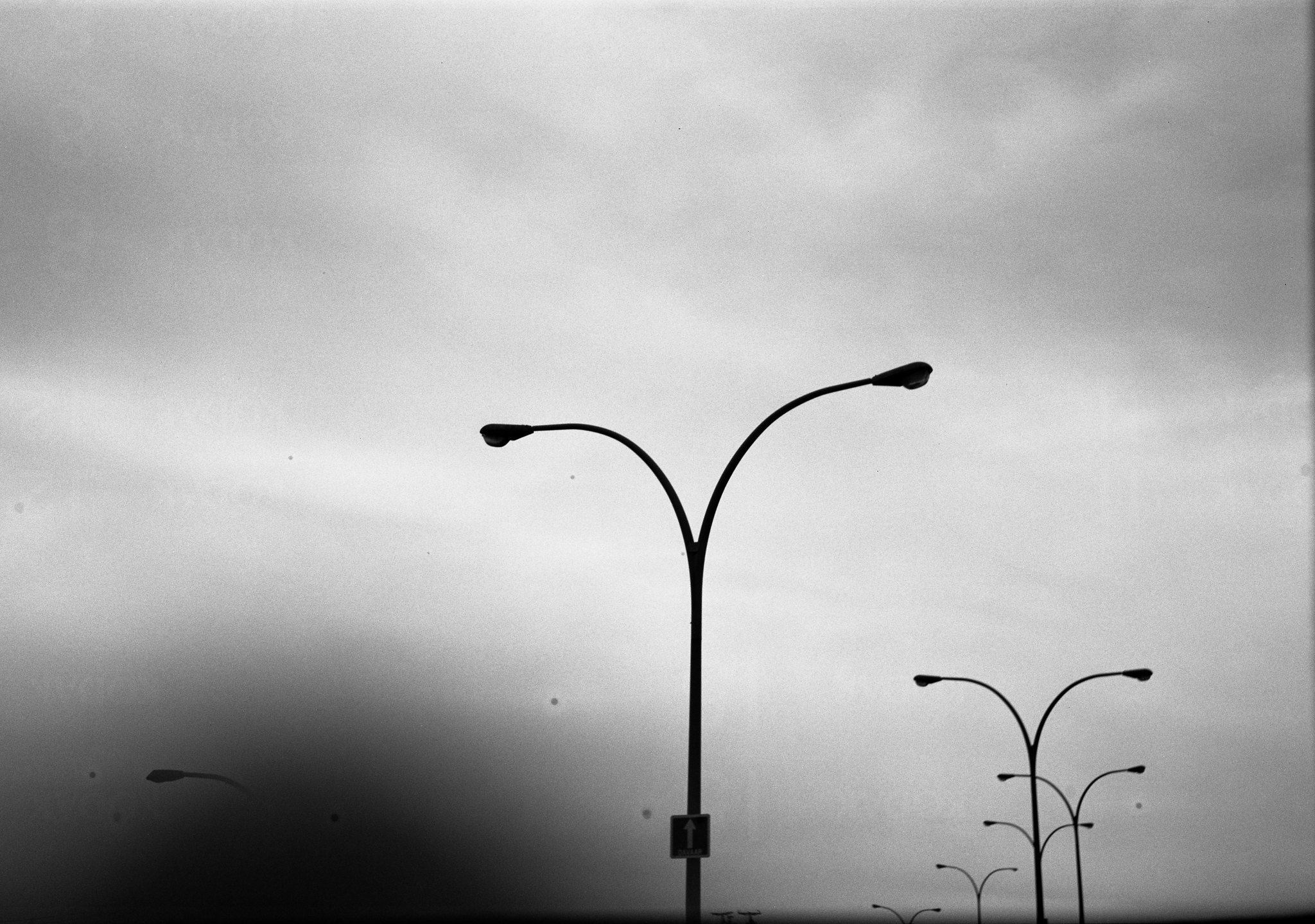

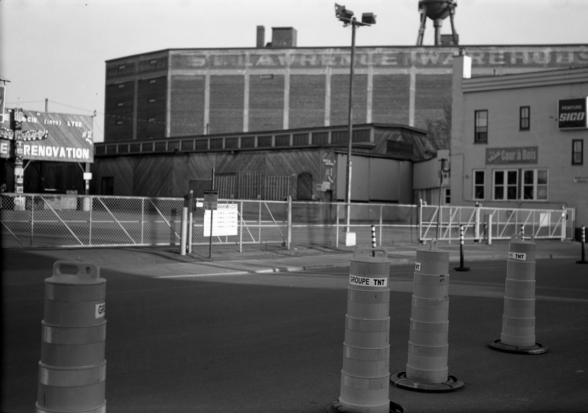

I have had one roll with backing paper numbers on some negatives too
2015-05-11-zeiss-sic-007 by Gijsbert de Haan, on Flickr
This photo has all three rows (8, 12, 16) numbers (along left, and lower edge). These were developed in xtol 1:1, btw.
2015-05-11-zeiss-sic-004 by Gijsbert de Haan, on Flickr
This one only has the 16 numbers visible (lower left, next to the pilon).
At least one other negative has the 16 numbers, but very faintly, the other pictures seem ok but they also have more detail that would it less visible. The whole roll: https://www.flickr.com/gp/roidelapatate/2pAkH7
I still have the backing paper, it's the old format according to that link in the previous post (yellow goes all the way to the line-up arrow). I can't really see anything out of the ordinary on the backing paper.
At first I thought I might have left the red windows open (shot on Zeiss Super Ikonta 531/2 (I think), with red windows on the 16 row), but then the first photo with all 3 rows visible should not have happened.
I have shot another roll of 400TX in this camera without any problems.
