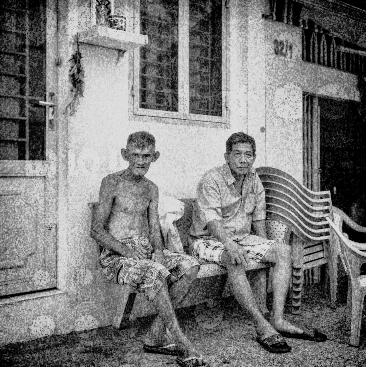

This was another Chinese 120 film not ShanghaI. I have had bad backing paper with Rollei film, Fomapan, Shanghai. I read about the Kodak batch and threw away a few rolls in my stash. I recall there were problems with a batch of HP5.
At this point you should embrace the defect if you still have some stock from the known bad batches… or pass it along to someone who wants it.
There’s no remedy. Things that have been tried like presoaking and developing immediately do not help.
The numbers and “Kodak” will appear.

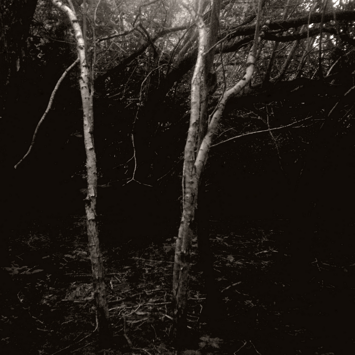

This is the antithesis of a darkroom print. But everything there came from one negative. I call it "No. 9"
I have been going through a freezer full of mainly black and white film I inherited when a friend passed away using it for testing some of my old cameras. Now that I am retired and have more time to use them, I have noticed this backing paper problem too. Most of the film is outdated, some by 25 years. He was pretty good at keeping it in the freezer so I think it was kept very cold in its original packing, but I can’t prove it for obvious reasons. All of the Kodak film with exp dates before 2015 have been fine. Last week I pulled a few rolls of T max 100 with 2001 exp date and used it to test my Bronica ec and it turned out fine no fogging or back printing. The rolls I used from 2017 had back printing. I used a few rolls of Pan F with 2007 exp date and it was fine. All the GP 3 shanghai and some of the Rollei retro 80 s also had back printing issues. Some of the last of the acros 35mm was fogged real bad. My guess is that as manufactures become more environmentally conscious and switch to ink and other chemicals with a lower environmental impact we will be throwing more stuff into the landfill due to premature failures.
The pre-2015 backing paper was manufactured by Kodak using technology, including paper inks, that is no longer found in the paper and printing industries.
As part of its downsizing in and before its bankruptcy, Kodak dismantled its backing paper manufacturing capacity. After doing so, it was left with a relatively huge (several years) of backing paper. In or around the time of the bankruptcy itself, that inventory finally ran out. The available replacements, from the greatly shrunk list of specialist paper manufacturers and printers, turned out to be problematic in ways that were difficult at first to predict, detect and overcome.
Backing paper is surprisingly complex!
Now that is real purddy.
Thanks. It is 120 T-Max 400 from the affected batches, re-rolled on to a 620 spool and run through a Kodak Brownie. I did this after I became aware of the problem - in fact from film that had already been replaced by Kodak Alaris (who didn't require that the potentially defective film be returned). In other words, I knew there was a possibility that the numbers and characters would appear, and used the film for a purpose that would not necessarily be harmed by that.
That is far different than Rrrgcy's intentions or needs, and I sympathize with his/her disappointment.
And for clarity, it is a role of the dice. I have used other film from those batches and no problems occurred. That is one of the reasons it was so difficult for Kodak to find a likely solution to the issue.

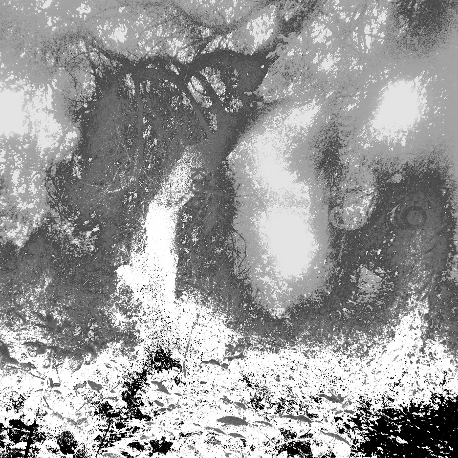

From the same roll:
