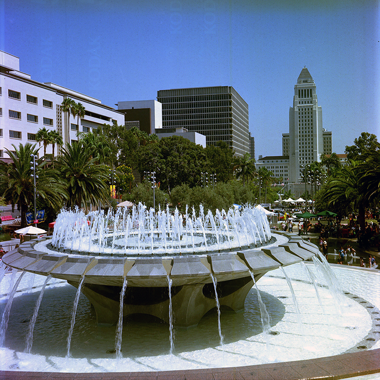

I wish I'd have seen this thread last night after I developed a roll of Ektar. Though in my case it may just have been the fact that I started this roll in August last year and it sat in the camera in my occasionally hot room (no A/C) for all these months... That could also explain the odd color shifts.

What are the odd colour shifts? Thanks
pentaxuser
There seems to be a magenta cast along the outer edges and a green one at the top. Color balancing the building in the back to white turned the sky a weird color so I left it the way you saw it.

Punker, the upper edge of your picture seems to be a stain of some sort due to irregular agitation or perhaps contact with a reel.
I'll guess that the process you used had a blix and not a bleach then fix. Am I right?
If so the building color is explained, but if not it just reinforces the process problem.
With a blix, silver metal can be left behind leaving odd colors to whites.
PE
