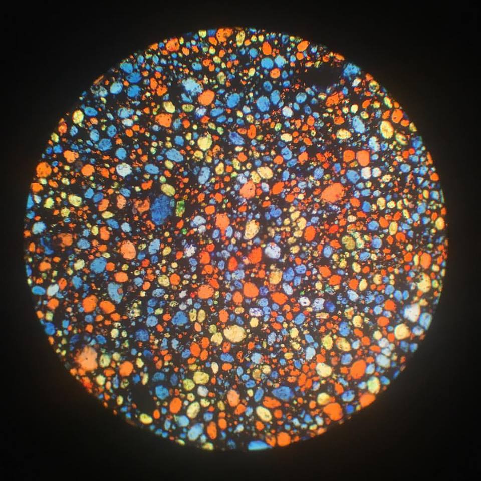

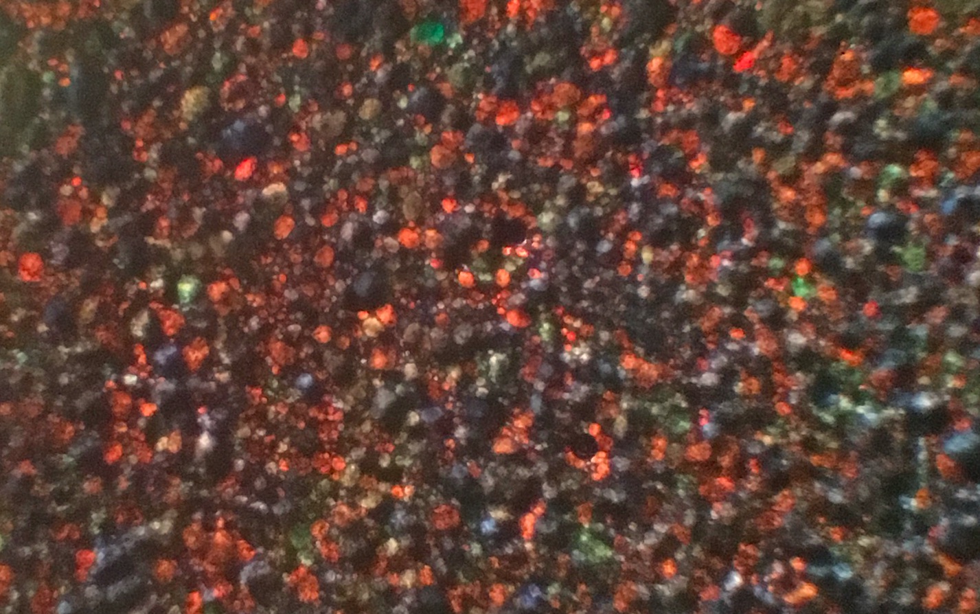

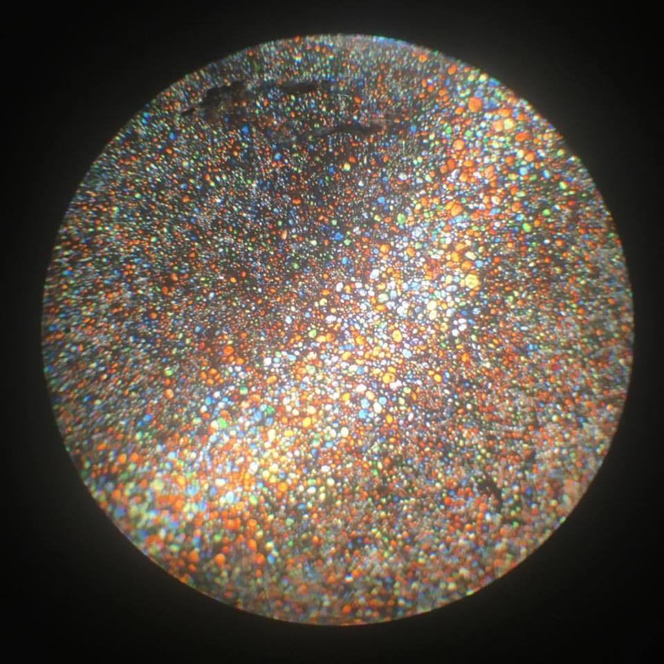

Hey everyone, it's been a while.
I've been playing around with making these again for a few months. Here's a write up my progress so far. Hopefully some if you will find it interesting.
In summary:
1. Right now I've worked out most of the kinks as far as making the first varnish and dyeing/compressing the starch
2. I think I have a decent, working second varnish but I haven't been able to test it
3. Preliminary tests have failed to render color, due to fogged emulsion (inexperience on my part) and a second varnish layer that is too thick
4. I kept the same mg/mol dye ratios for erythrosine and pinacyanol as I do for my Lippmann plates. Now that I'm re-reading PE's last response from 2015, it's probably too much, due to larger grain size...
5. I've managed to source all the original sensitizing and starch dyes except for Orthochrome T. All my experiments up to here have been using easily available T-shirt dyes.
I'm hoping to get some color response in the next couple of week! I'll keep you posted...

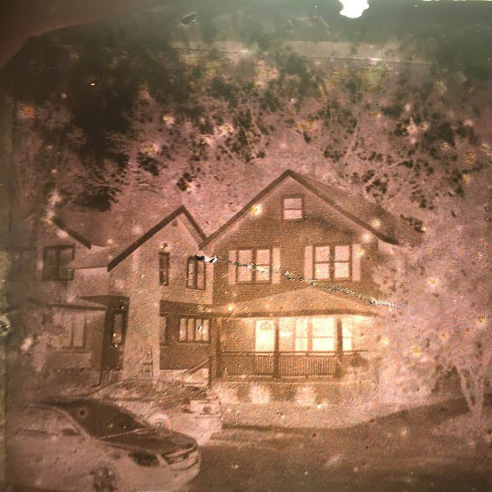

I attached a picture of a blue object (a trash can). It looks there might be some correlation there after all, though it looks like the exposed part of the emulsion are shifted down and to the left...
However, if you invert the image to make a positive, as is proper for Autochromes, the trees are at least green. :wink:
That's looking on the bright side!
