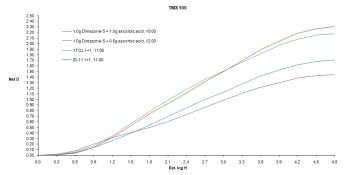

Another experimental result attached, a variation on the formula which used ascorbic acid as the superadditive agent.
The latest test formula contains half the ascorbic acid, with development time extended from 10:00 to 12:00. The goal was even lower overall contrast than the first ascorbic acid formula, but with higher speed and a slightly straighter lower portion of the curve (ie like the initial Dimezone-Pyrogallol test formula). The formula is:
20.0g sodium sulfite (anhydrous)
0.5g ascorbic acid
1.0g Dimezone-S
1.0L
The result was extreme low contrast and very high film speed, still with a fog level the same as XTOL and ID-11 (developed to a normal gradient). Curves for XTOL and ID-11 are included.
Note since the orange tint at high exposure levels appears to exist with TMX100 regardless of developer, the attached plot shows all curves read through blue filtration. Since the readings through green filtration are very close to the white light readings, contrast with VC paper would be even lower - ie: super-extreme low contrast and flat highlights. I will put the blue/white curves in a separate post.
The basic idea has been to see how far this premise (ie N-infinity with no speed loss) could be taken. Even under extreme contrast conditions, I would find this to be too much compression. Of course other films will behave differently and I'm especially curious to see what can be done with TMY-2 for example. TMX100 is particularly easy to work with because it naturally has a gradual shoulder. With other films the formulas will no doubt require alterations, and these are still just "play" developers at this early stage. I'm hoping to do some test printing this weekend and see what the image structure actually looks like. I'm hoping additional tweaks could also allow for more sulfite.

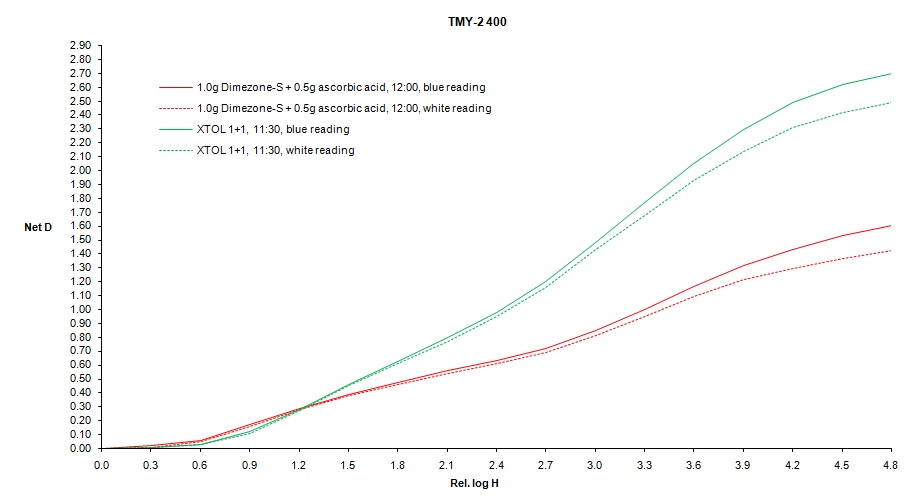

Here are some curves for TMY2 with the same test formula, and XTOL. Regarding the kink in the TMY2 curve, we've seen this before and tested it with various developers (see Mark Overton's thread) and it appears to be normal.
Fog was 1 density unit (0.01D) higher than XTOL, but this is within the margin of error so we can't say much about it. This is ridiculously low contrast and very high film speed (although the film's inherently higher highlight contrast handles it better vs TMX's long shoulder which can become excessively flat), but again, the idea here was to see how far this can go (I wonder if the Pyro version might produce an even straighter line). For actual use perhaps less Dimezone and a 1:1 ratio with ascorbic acid. Etc. (ie a less extreme formulation).
I'm thinking maybe trying this with a film like Acros which normally has very high highlight contrast.

Sweet! I would most likely be using this with HP5 or TMY2 (though I'm trying to stay all Ilford...) so this is of particular interest.
Was the XTOL developed to a pretty hearty N- like the last time?
Thanks again, Michael.
Hi Shawn, no the XTOL curve you see in post #89 is "normal" development. The idea was to illustrate that even when developed to normal contrast, the "speed" given by XTOL (an excellent reference developer for full film speed), is lower than that of the test formula developed to minus-infinity. I also wanted a good normal reference point for TMY2 graininess so I went with normal development in XTOL. However I also developed some TMY-2 with minus development in XTOL last night (along with Delta 100 and FP4) so I could do some further comparisons for speed and grain. I'll plot the curves and post them.
