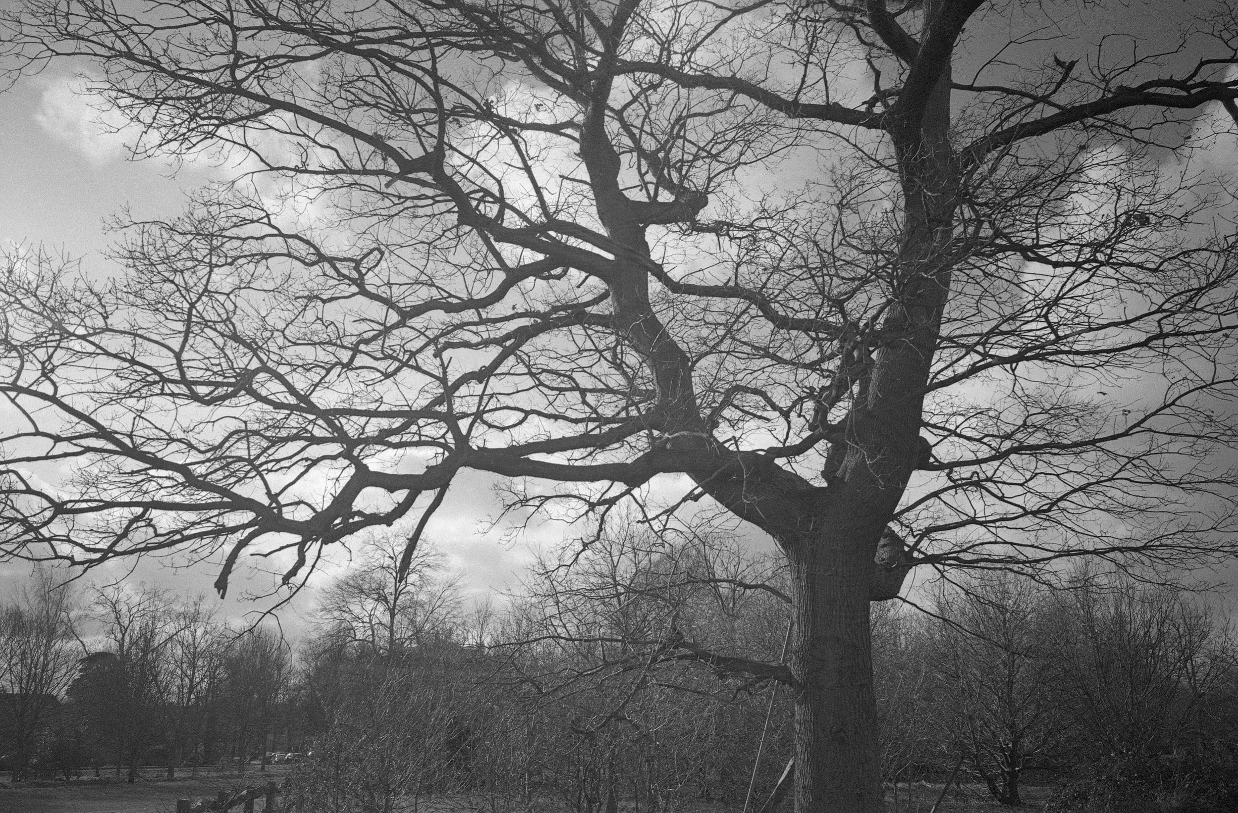

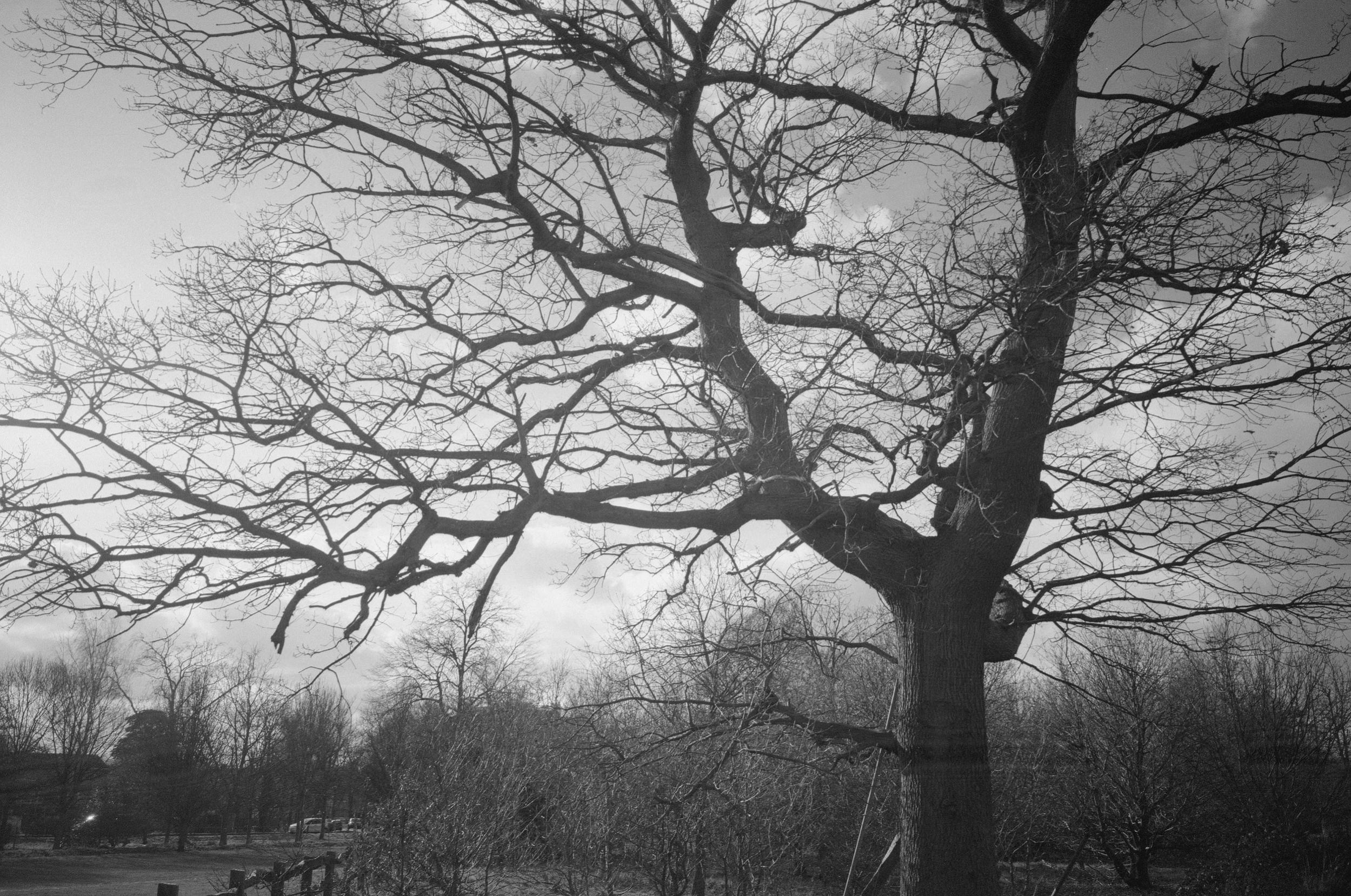

I made some catechol version:
Sodium sulfite anh..........20g
Pyrocatechin....................1g
Dimezone-S.....................1g
Water to..........................1L
It is advisible to use rubber gloves for handling this solution IMO.
I took some pics of the shaded side of a tree against sunlit clouds.
APX at EI=50 metered for mid-tone was developed for a long time, 22min, to get the density up towards Xtol (Is that the idea?).
Reference was APX @ EI=50 developed in Perceptol.
Through a loupe I can see a little more shadow detail in the catechol version, it does not show well in the straight scans attached.

Alan, if you do such a test with extreme contrast, you have to account for lens flare, which means your shadows will lack contrast and detail even if you'd have an ideal developer giving you infinite ISO speed.
I encourage everyone to put a Stouffer wedge into your enlarger and make a print. Then contact print the wedge and see the difference.

Even with 22min development the highlight density with the catechol version is less than that with Perceptol at 9 min.
With 13 min development the catechol negs look decidedly thin although shadow detail is better than Perceptol (not shown).
If you like there seems to be plenty of scope for increasing the development time upwards from 10 min.

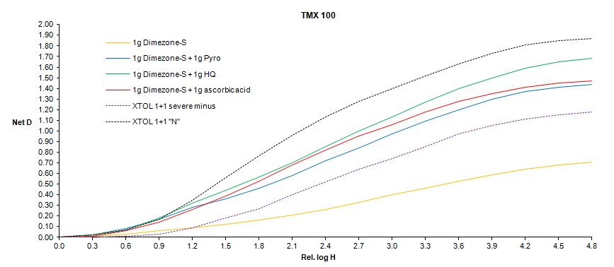

Thus far what the curves for my experiments are showing me at a 10:00 developing time with TMX 100, are:
1) Essentially the same effective film speed as when developed in XTOL 1+1 to a normal CI (ie full film speed). There are variations though, with the Pyro version giving the highest "threshold" densities but the ascorbic acid version giving slightly higher toe contrast.
2) Very pronounced contrast reduction vs normal development in XTOL. Here again the curve shapes vary somewhat across the experimental formulas. The Pyro version gave the straightest curve. The ascorbic acid gave higher toe contrast but more flattening of extreme highlight exposure values. So it is tricky to say which gave lower overall contrast since it depends on how it is measured (Gamma, CI, "Zone System"), etc.

removed account8
Feb 2, 2010
47
Attached is the graph including the test formula with ascorbic acid. Just to recap, development time was 10:00 for all test formulas (ie excluding XTOL) at 68F with agitation as described in the first post.

Thank you for posting this. The Dimezone-S + Ascorbic Acid curve looks very similar to the curve from your original Dimezone-S + Pyro formula.
Could you elaborate on any perceived differences between the two? Anything you might expect from one vs the other? Image structure characteristics? As I've mentioned I'm very curious about and interested in this approach to "N-3/N-4" type scenes.

Shawn, over the next few weeks I hope to experiment more with these, and make some prints so that I can also try to evaluate relative graininess (although ultimately it will not be possible to objectively quantify things like granularity and acutance without microdensitometry - and that ain't gonna happen). I will post the results for discussion. Based on the pH values Rudeofus provided us, theoretically/superficially one might expect the ascorbic acid version to be slightly finer grained. But there are so many variables it would be unwise to speculate at this point.
The curve with the Pyro formula is "straighter", with almost zero toe. The ascorbic acid formula is slightly more typical/s-shaped: relative to the Pyro version it has slightly more toe in the very lowest exposure values (below ~Zone II) but more contrast in the shadow values above that and into the midtones. Above ~middle grey it has about the same gradient/contrast as the Pyro version, and then flattens out more in the extreme highlights. In fact, if you compare the shapes of the curve from the Dimezone-ascorbic test formula, and the two XTOL curves, they are very similar, which is interesting in and of itself given XTOL is a Dimezone-S/ascorbate formula (although the proportions and the rest of the formula are completely different.

Michael, can you tell me/us, why the regular Xtol curve looks so downwards bent? Can you check with a Stouffer wedge whether your densitometer gives you accurate numbers at high densities?
removed account8
Feb 2, 2010
47
This is the type of curve I've always experienced with TMax 100 (specifically) and XTOL. In my experience it is as much a property of TMax 100 as the developer/agitation. The highlights have a gradual shouldering (the plot covers 16 stops) and develop to significantly lower densities at the highest exposure values in comparison to say TMax 400. The TMax 100/XTOL combination in particular seems to produce particularly strong shadow and midtone contrast and a long, gradual shoulder. I will dig up some comparitive curves I did a while back with Delta 100, TMax 100 and Acros in different developers, which may help. I think now that you mention this I will also run a few rolls of TMax 100 in D-76, which is more often the "reference" developer of choice. With respect to the densitometer readings, I always check it with the calibration samples, and with step wedges everything checks out.
