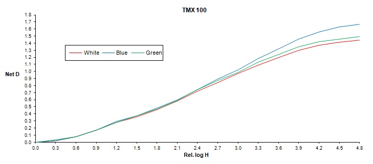

A H&D curve for 35mm TMX is attached. Development time was 10:00 at 68F, without any fancy routines. Basic inversion agitation for 30 seconds initially, followed by 10 seconds each minute. There appeared to be some orange-ish imagewise stain at high exposure densities so I measured using white light, blue and green. Preliminary observations:
-Marked toe contrast and full film speed (equivalent to normal development in XTOL)
-Equivalent contrast of ~N-3 or more in ZS terms
-Uniform development
-Normal fog level (same as XTOL)

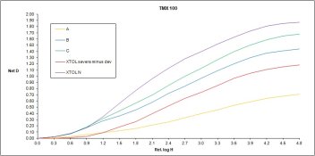

Attached is some more work on this (and indirectly some work on superadditivity) for discussion:
On the attached plot, "B" is the developer outlined in the original post in this thread. "A" has no secondary agent. "C" replaces the Pyro with the same weight in Hydroquionone. So the formulas are (in g/L):
Developer A
Sulfite (anhydrous):20g
Dimezone-S:1g
Developer B
Pyrogallol:1g
Dimezone-S:1g
Developer C
Hydroquinone:1g
Dimezone-S:1g
Development time for A, B and C was 10:00 at 68F, with 30s initial agitation followed by 10s/minute. Development times for XTOL (1+1) N and minus were 11:00 and 6:30 respectively at 68F, with the same agitation scheme as for developers A, B and C. B+F levels (35mm roll film) were:
A:0.22
B:0.22
C:0.23
XTOL (1+1) severe minus dev: 0.20
XTOL (1+1) N: 0.21
