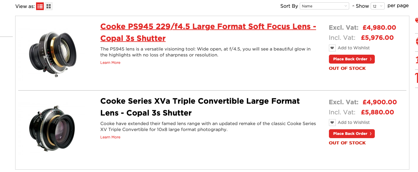

As far as I know Cooke are still making the PS945 and Series XVa lenses to order. Robert White still have them listed:
David Lindquist
Aug 18, 2006
304
California foothills
It does say "Out of stock." These used to be on Cooke's website. I can no longer find them there. Then of course one would have to find a No. 3 Copal. Not impossible. If you really wanted one and Cooke was willing to make one you'd surely be willing to buy a used lens for its No. 3 Copal. You might even find a No. 3 Compur or Prontor Professional.
