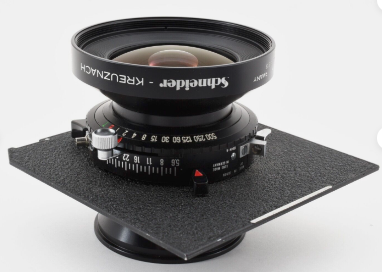

OK I bought my wide angle lens last night - a Schneider 65mm F5.6 MC Kreuznach Super Angulon Copal No. 0 for £281 free shipping to Gibraltar. Described as 'near mint' which is good enough for me. Thoughts?
So this will go with my Schneider 150mm F5.6 Apo-Symmar

65mm sure is wide -- and that's a great price. If you decide it's TOO wide for you, you'll have no trouble making some money selling it.
I think Stephen will soon buy a second Wide Angle LF lens, like a 90mm. I have a 65mm f8 Super Angulon, I use it rarely but when I do it's a shot that wouldn't work with a 90mm, or even a 75mm.
well to be fair I thought it a great price and I like very wide angle so I'm hoping I like it!!!!! we shall see.......next in line is either a 210mm or a 300mm cant decide which...and that will be me done....I have 2 x 50mm and 80mm and 110mm and 120mm and 150mm and 250mm for my Hasselblad bodies so.......and a 28mm and 50mm and 90mm Leica R lenses for the Leica R6.2 I used to have til it was stolen by someone within DHL in Germany I posted about that Paepke photo are lawyering up against DHL to sort something out (now breathe!). Also have Nikon lenses and Zeiss lenses for 35mm format in a few threads incl. M42.....lenses.....love them....
It was a great price for an excellent lens, I just think you will see a wide gap between 65mm and a 150mm, particularly when you mention your 35mm/MF ranges.
I have this lens and you will not be disappointed. It is wiiiidddddde on 4x5, however, so it takes getting used to seeing things that way.
On some (most?) cameras it will need a recessed board -- and I won't mention the extra cost of a central neutral density filter!!! But I love my 65mm, and I don't need a recessed board, and often don't need a CND filter either.
