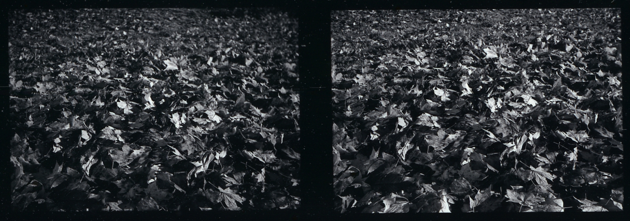

I set my Minox cameras (8x11) to the infinity, not to the hyperfocal, when shooting distant object, usually anything over the 2 meters mark. I have noticed that the hyperfocal setting is giving me soft (not properly focused) images. The infinity mark seem to have resolved this issue.
It also has to do with the thickness of the film used; the thicker the negative, the harder is to be held properly by the gate upon closing in onto the film. The thinner the film, I noticed that the sharpness improves very much.
Other than that, I believe the others here have already said it. Good luck with your next negatives :smile:

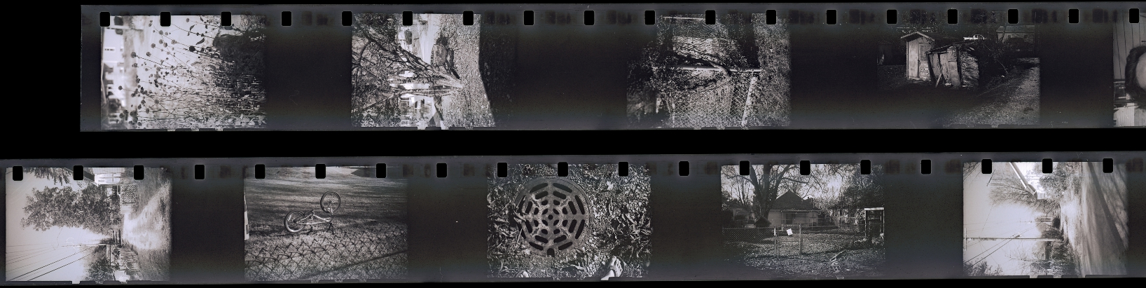

The other half of the strip:

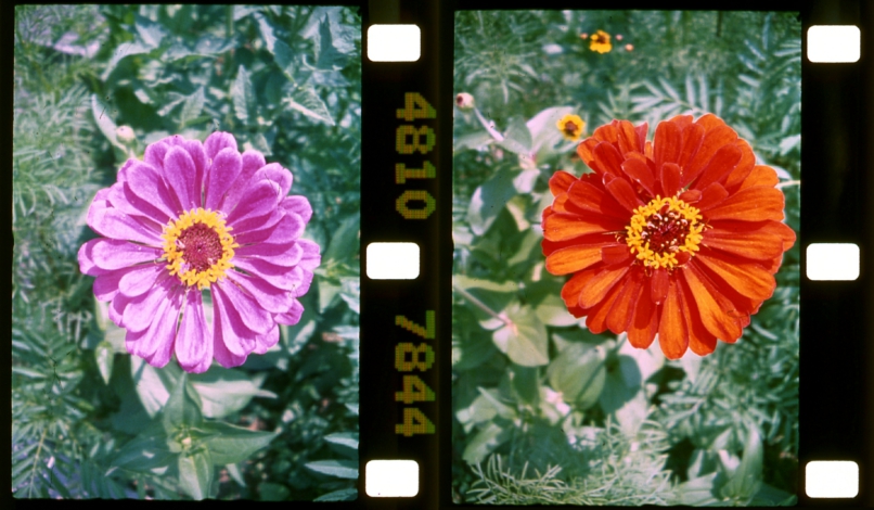

These are looking good. Where do you get single perf 16mm ektachrome? Are you processing it yourself? regards ---john.
I get most of my submini stocks from FPP, though bigger places like B&H usually carry most of the Kodak range. Processed DIY E-6 in a yankee clipper, though I did cheat a bit and use D-19 as the first developer as I'd just mixed 2 liters of it.

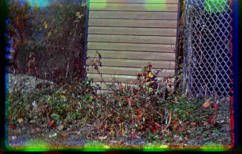

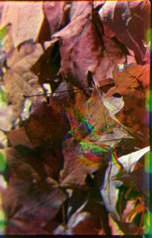

I finally gave some color separation exposures a shot.
Mamiya 16 De Lux, ~F5.6, 1/100s
Foma R100; bw reversal, 1st dev Kodak D-51 2+1 8' (amidol print developer)
Red 29, Green 61, Blue 47B

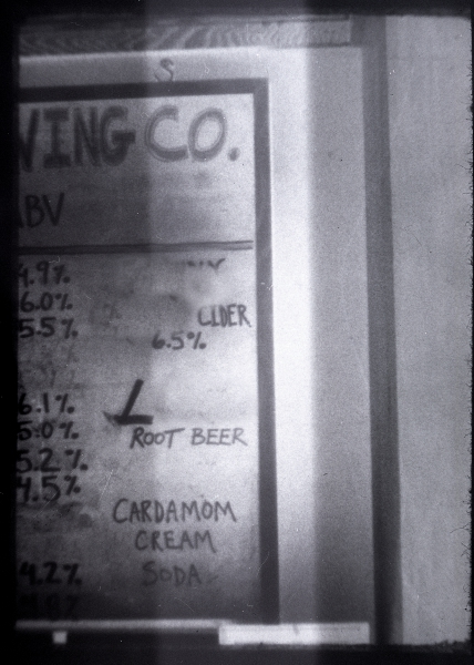

Minolta 16 QT @ closest focus; F3.5 1/250, F10 1/30s
ImageLink HD; D-23 1+3 8'
Thanks; I find with smaller formats it's much easy to experiment and/or fine tune processing without worrying about wasted film.

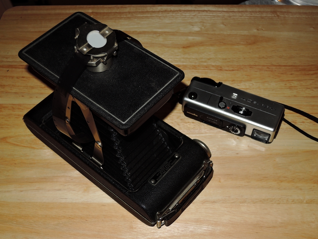

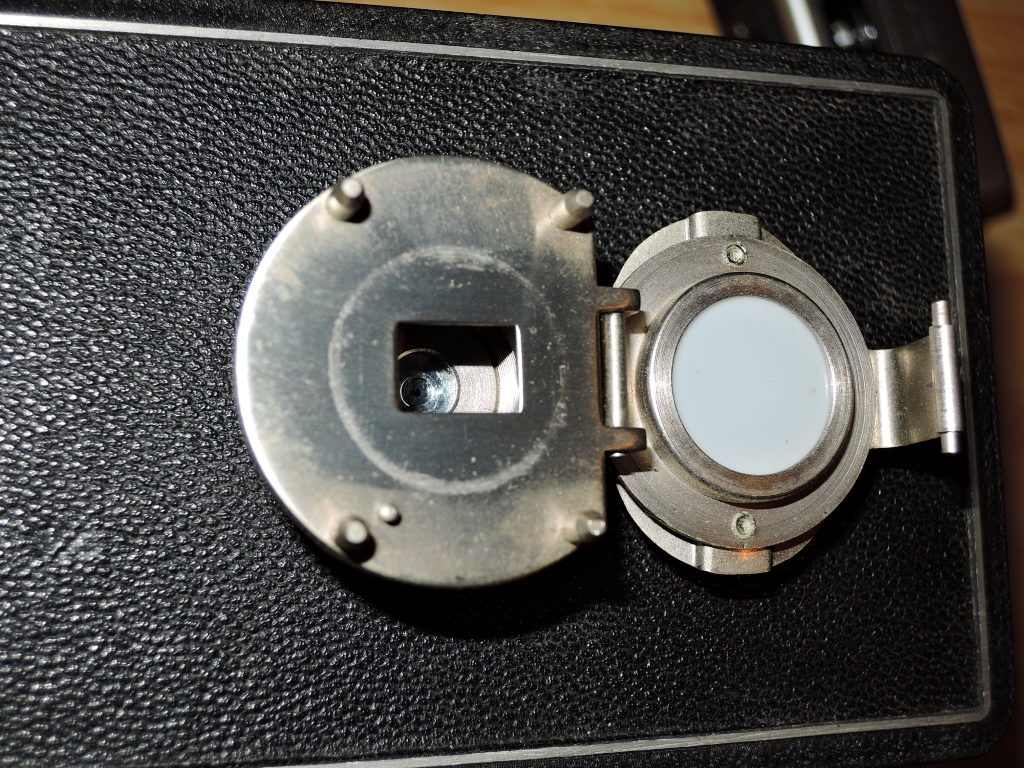

I just picked up a Kodak 71173 cine 16mm -> 616 (2.5"x3.5") enlarger from some sort of auction site.
It's gated for a ~8x10mm 16mm cine frame, complete with a handy dandy registration pin. It'll only give crops from 16mm/110 still cameras but will produce a 'quad-diptych' with un-slit Double8 film.
I don't have any 616 roll film (and my 120 adapter isn't here yet) so I cut down a sheet of x-ray film and dropped it into the back, slapped a random bit of 16mm film in the holder, and opened the shutter.

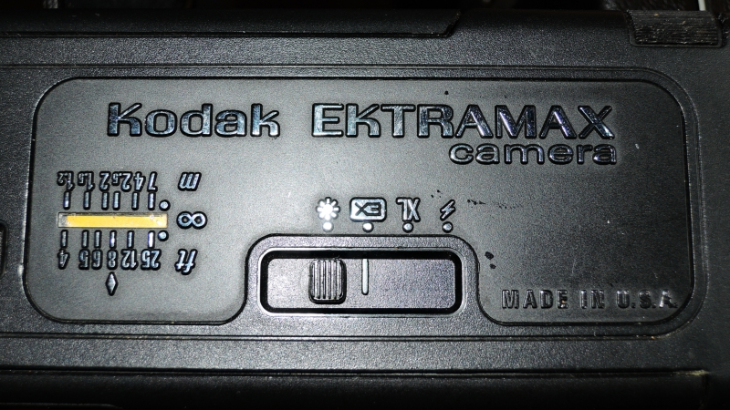

Edit: To stay on topic, I also recently picked up an Ektramax. The flash unit is dead weight, but the mechanical functions all appear to be sound and the rotating/sliding action of the focus is sweeet.
Nice! I tried to find one but my searches were fruitless apart from one that looked like it was a dog's chew toy. Had to pass on that one (and they still wanted $60!)

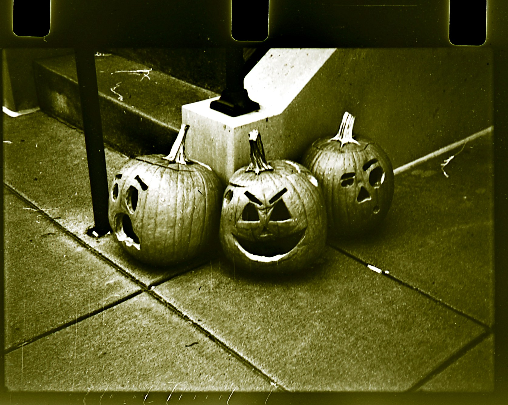

This one won't win any beauty contests, but it does take pictures. It requires sprockets to cock the shutter and one extra blank advance to avoid overlapping frames.
Kodak Ektramax F2 1/30s & 1/100s?

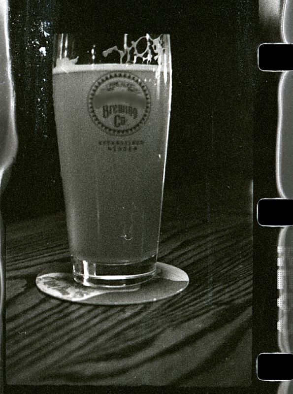

FPP BW3 (3383), Pyrocat-MC 1+1+100 14'
3383 is weird stuff. More often than not it silvers out during fixing when processed as a bw negative.

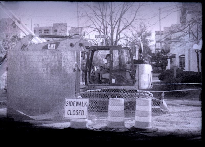

Pentax Auto 110, Fujicolor Super HR. Film did not age well...
Rollie A110, Fujicolor 200. This film got along better but I was working out the kinks in the camera. It seems it does not like when I use the function to close camera without advancing and I got a bunch of double or triple exposures.
I left the edges in intentionally. I like how it looks with 110 film.
