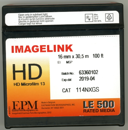

Slight correction, it's EPM ImageLink HD, not HQ, on pet 13 base (catalog #114NXGS) with a 2019-04 expiry date. The equivalent stocks in 35mm and 105mm are #114NXHU and #114NXL1, respectively.

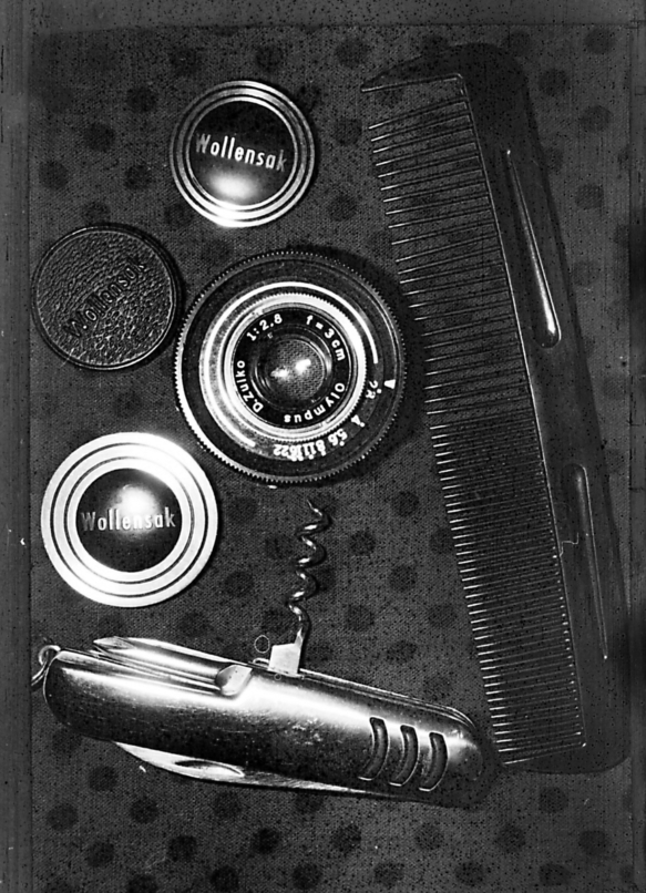

This isn't exactly 16mm, but one could consider Double8 a sort of 'quarter-frame Minox'.
Wollensak 8 Model 53
FPP Double8 ISO 100, Xtol stock
Morse tank, V800 scan
