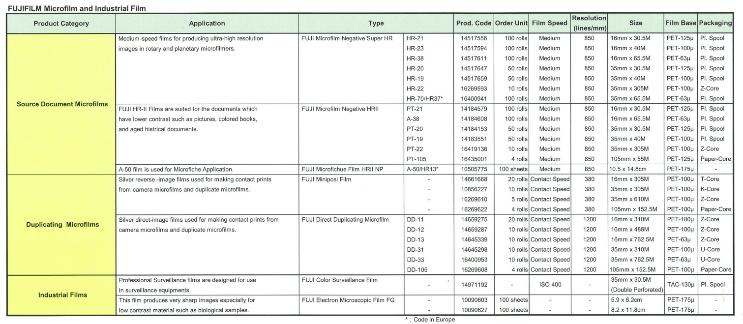

I'm still trying to distinguish between the characteristics of the films on offer, but the 'Fuji PT-21 HR-II Medium Speed Low Contrast' sounds interesting.
For microfilms, "high speed" is ISO 32-40 by the time you develop to low enough contrast to have a good gray assortment. Medium speed should be ISO 16-25 range -- but you might do better with this, since "low contrast" may not require you to use special developers or massively underdevelop by the film's usual standards.
A spool of HR-21 or PT-21 would probably suit my purposes but unfortunately I'm not a library in need of 3 kilometers of film.

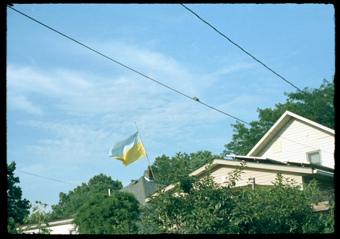

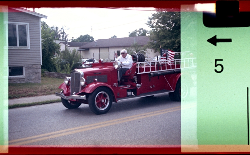

Rollei 16 'A' mode
Vision3 250D @ 200; ECN-2
V800 negative scan
The viewfinder parallax correction is much better after the adjustment.
Lens performance at infinity is excellent.
Along with bulk, the camera's shutter is quite loud. It emits a CLACK like the focal plane shutter in the original Minolta 16 but followed by pronounced spring noise. Maybe it's just this copy. For a quieter shutter try a QT.

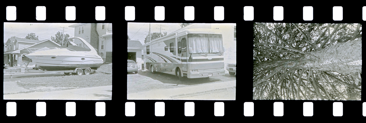

Mamiya 16, Plus-X. I don't have a cassette so I shaved down a 35mm spool to make a dowel. Kind of worked but the spacing was all off by the end of the roll.
Rollei A110, Tri-X. Golly this camera is sharp. Had some issues with film advance but I think I worked it out.
I wonder if I'm the first to shoot b&w 16mm in the Rollei. Someone else out there had to kludge this before me.

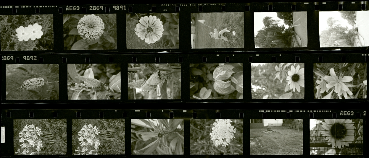

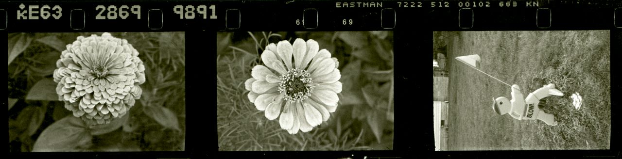

That hangar shot would be great as a hyper-stereo pair. A bit of bog standard early morning double-x --
Minolta MG-s, shutter priority 1/60s
Double-X @ 200, Xtol 1+1 11'
V800 negative scan
Mostly blind shots with the 25cm close-up lens, but I slid in the 120cm lens for the slow flag dude.

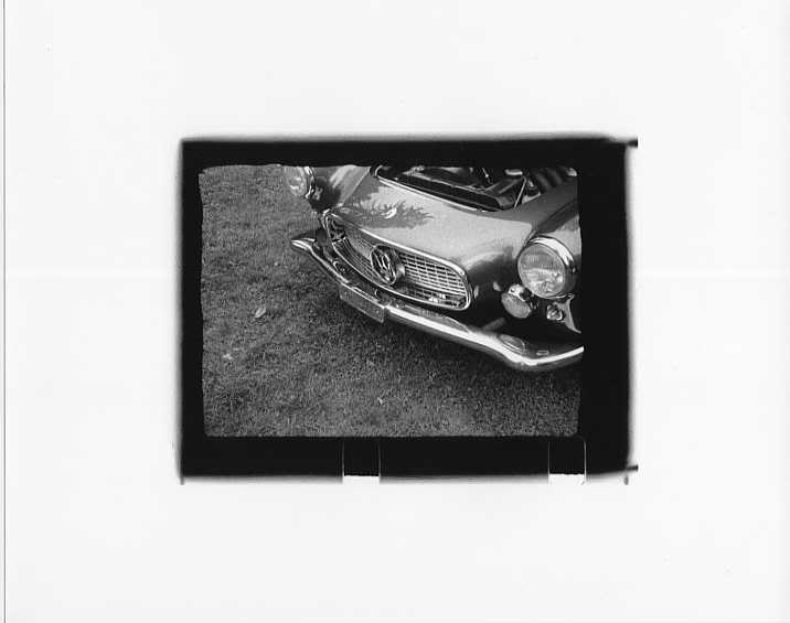

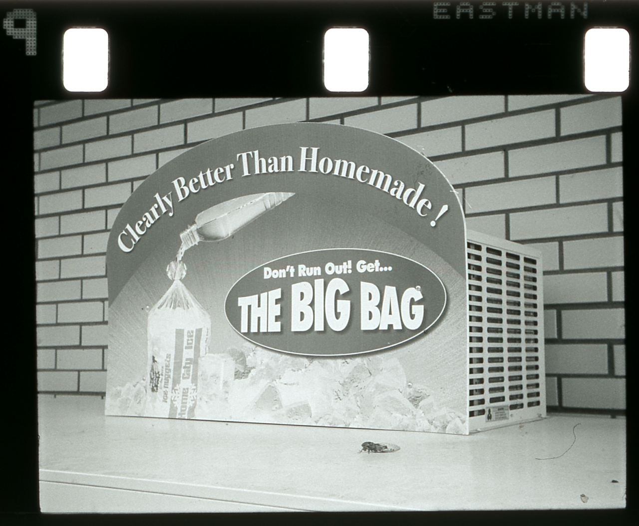

Minolta QT, 1/250s f11 @ closest focus (~1.2m)
Kodak Tri-X @200 (7222); B&W reversal D-19 8' 1st, Xtol stock 2nd
V800 positive scan, D850 digitization

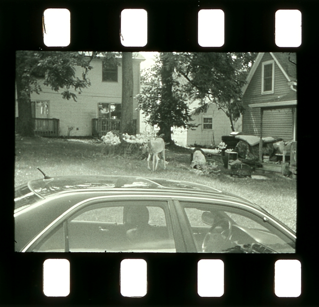

Kodak Fling. Plus-X
Shooting 16mm out of this thing is a trip. The frame goes well beyond the intended 110 lines.

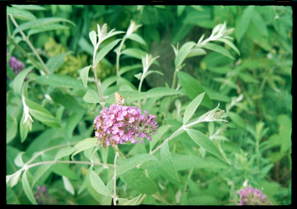

I finally developed some color film a while back. Kind of disappointed the Ektramax's feeler wasn't catching and failed to stop the advancement in the right spot so the frames almost all had the perforation in the frame. On top of that the film was the equivalent of a brown banana. Just too out of date I guess. This is the only frame that was slavageable on the roll and of course it was an ugly picture. Lol. I still have some 110 film laying around. Maybe I'll put it through the Rollei.

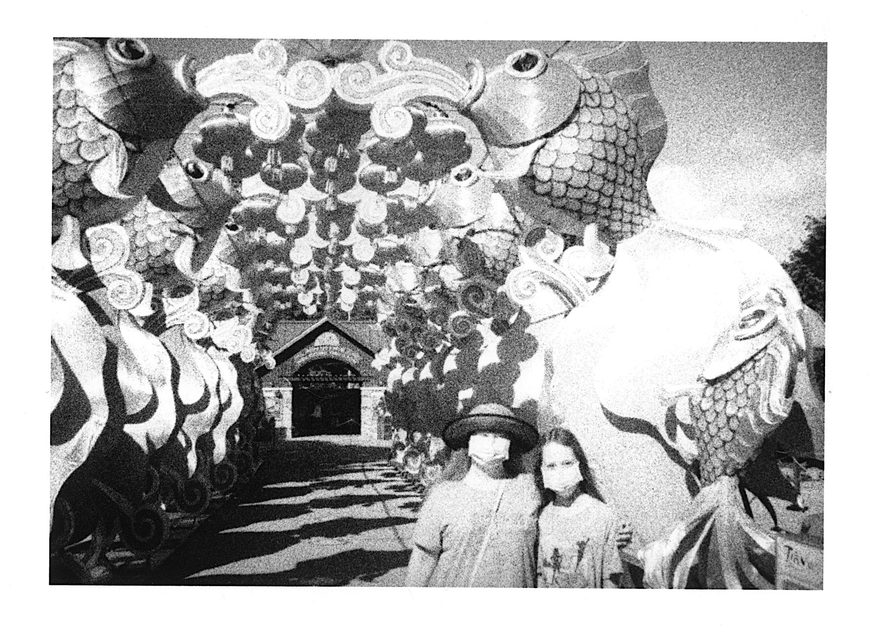

I hadn't posted anything here for a while. This is Minox with HP5. The print is a little over 4x5". Printing that small I use the 45mm Componon HM, which is my sharpest lens. Rather than a 25mm Rodenstock or 30mm Rokkor-X lens.
I use those other lenses for big enlargements. For example, about 20 years ago I was on a kick to make 16x20" Minox enlargements.
