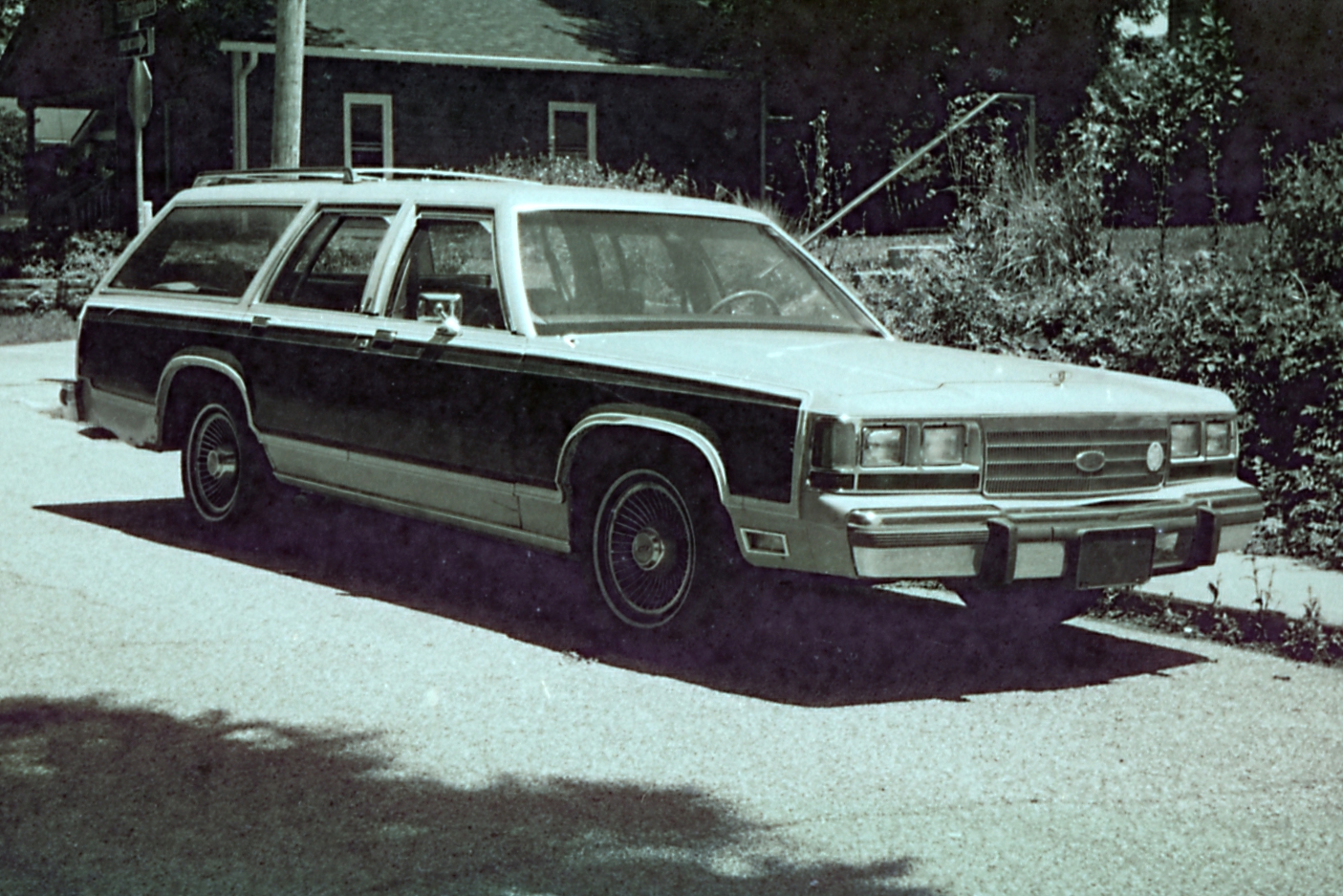

Minolta 16 QT (f3.5 @ 1/30s)
FPP Ultra Blue ISO 3, Rodinal 1+150 & 5mg CD-2; 60' semi-stand
V800 scan, cropped frame
And a J5 digitization
Here's an exaggerated look at the color response, negative and positive. The CD-2 was added about 20 minutes into development so the effect is extremely muted, but discernable. Strong 'blue' shadows with the slightest beginnings of a response from the other color layers, but with eXtreme cross-over. I might try bleaching a couple of these and see what dye remains.

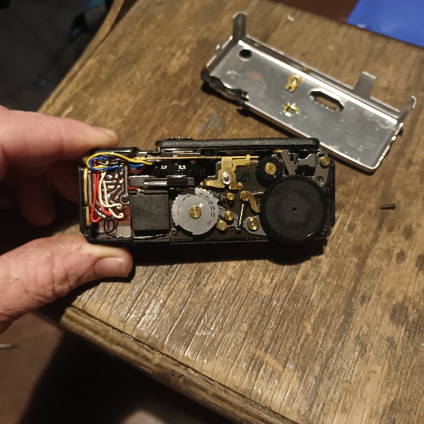

My little QT turned up today. Wasn't working so I undid the two screws either side and the metal cover came off easy. Gave it a light lube and some actuations and it was firing again. Went back together just as easy. All the optics are clean and it is in good shape. Just need to replace the light seals and get a cartridge.

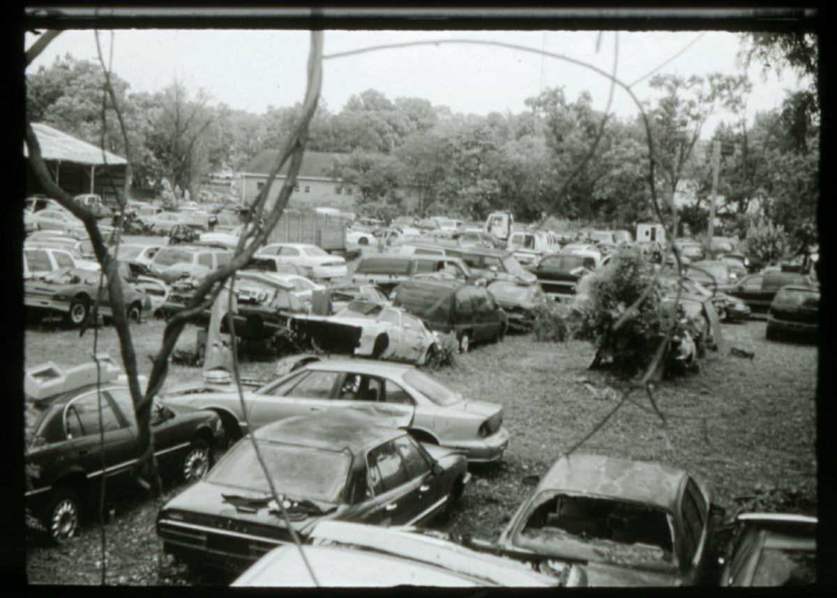

Minolta 16 QT, F3.5 @ 1/30s
FPP Ultra Blue ISO 3, 'Y48' filter; C-41
Heavy color correction during scan
Positive scan (w/ ICE), manual color inversion. Quite a bit better IMHO. The shadow bars on the right are from the film holders during scanning. The film base is very thin and transparent which magnifies these sort of reflections.

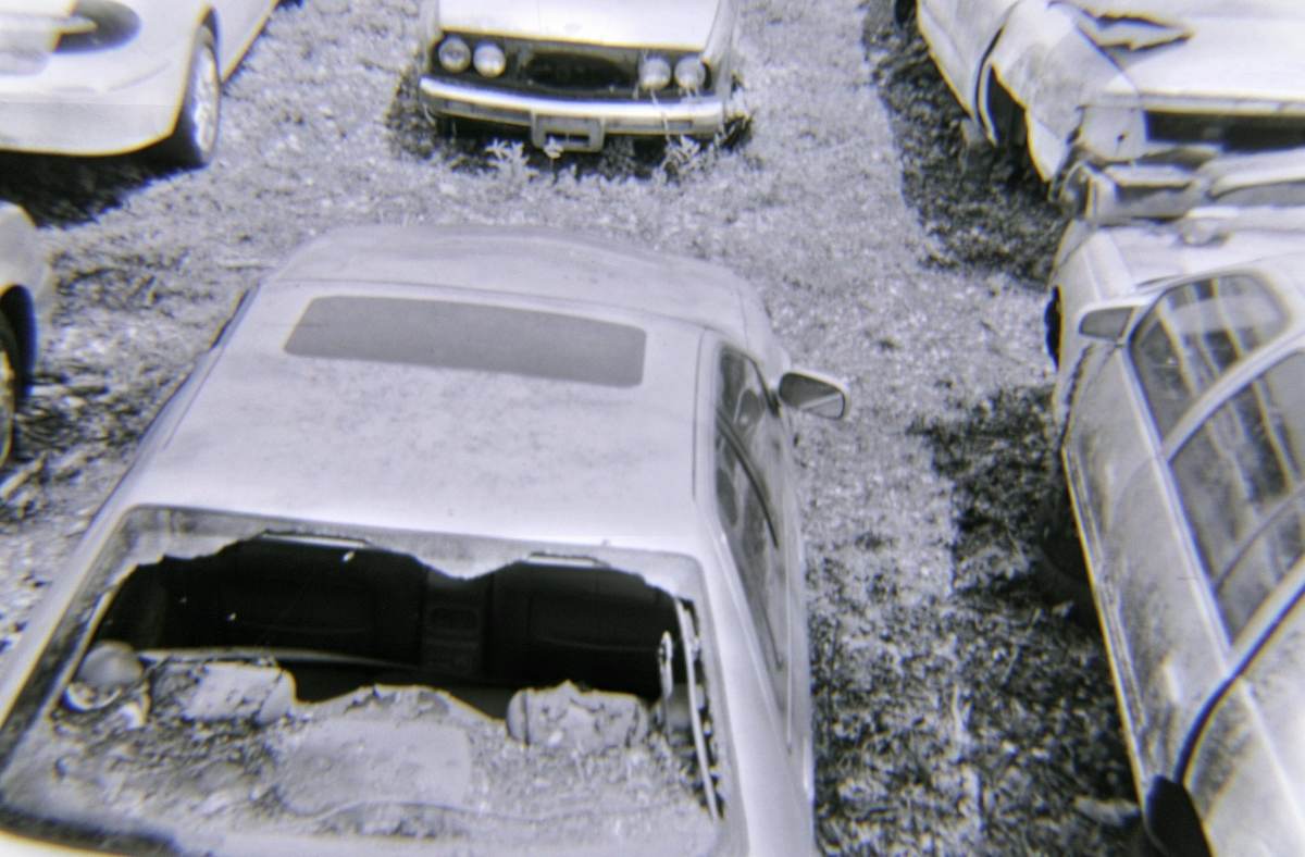

Minolta MG-s, shutter priority
FPP Sonic 25; D-23 stock 8'
V800 scan & J5 digitization
View attachment 309767View attachment 309768
First attempt with this combo to see the effect on contrast / density. Not as contrast-taming as I'd hoped, some uneven development (I'm looking at you, yankee clipper), and shadow speed suffers as well. Great middle tones though. The house and adjacent roof blew out much faster than the blue sky, which is odd. Maybe I need a UV filter.

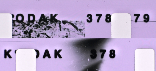

Does the Sonic 25 have any edge markings to indicate what film it is?
I have roll of partially used non perforated 16mm copy stand film (from a Minolta copy stand), which I assume is Ortho film. I have to develop a piece to see whether it is fogged and maybe it will have some markings to tell what it is.
Yes, but they're relatively inconspicuous and extremely rudimentary, unlike the parade of edge codes found on double-x, vision3, etc.
They also intersect with the sprockets which is something you don't see in the other stocks. Almost like adding the perfs was an afterthought...

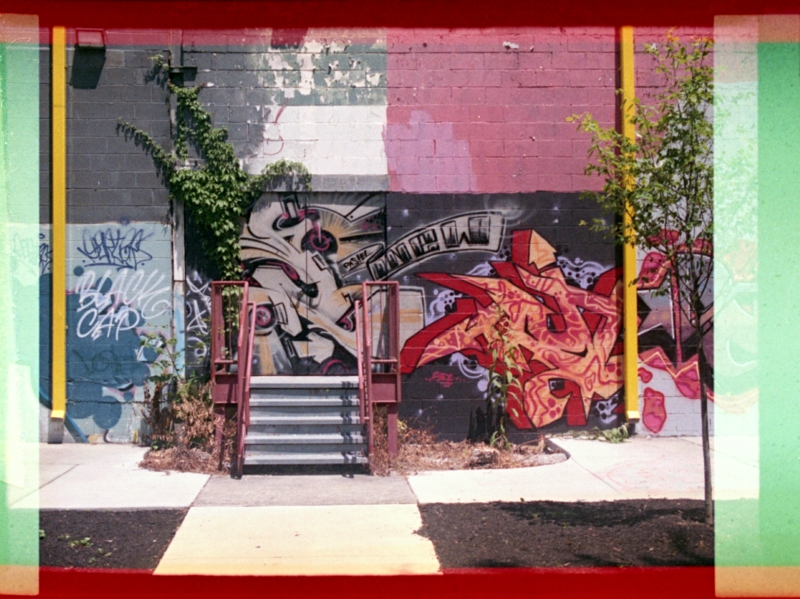

Canon 110ED 20 w/ Fuji Superia 200 @ 80 ('Process before 2003-5')
Modified C-41 -- +15% sulfite, +50% bromide, +2mL 1% benzotriazol sol'n, -30% carbonate (oops! used the mass for 200mL instead of 300mL)
V800 negative scans
Zero fog and pretty good color rendering given the botched pH of the developer. Had to destroy a 110 cassette (again) after exposing it in the 110ED... the backing paper got jammed somehow and I'm starting to think it's a feature of this particular camera. I'll give it one more chance and if it eats the cassette (again) I'll probably look to sell the camera.

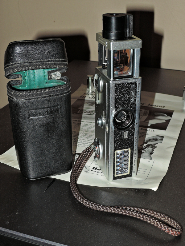

The latest addition to the collection (and my first Rollei) rollei'd off the USPS truck this afternoon.
All modes and functions are in working order, including the fully-programmed auto mode, but I've yet to put any film through it to test meter accuracy. Despite the compensation dial being marked "0, -1, -2, -3" the manual describes it as a 'filter compensation' adjustment which seems to imply additional exposure rather than less. A possible metering range from 1.5-200 ISO seems a bit ridiculous, but so does 12-1600 ISO.
It says 'GOSSEN' right on it so it can't be all that bad... first up will probably be a load of double-x, followed by some ektachrome to really sus out the selenium meter.
Edit --
I tried out a slightly short load of double-x, shot to about exposure 16, then 'rewound' the film. The advance mechanism had happily peeled the film off of the cassette spindle around exposure 14 or so and all the film was still in the take-up side. Luckily I opened up the camera in my changing bag when loading the reel, so I developed the film normally.
